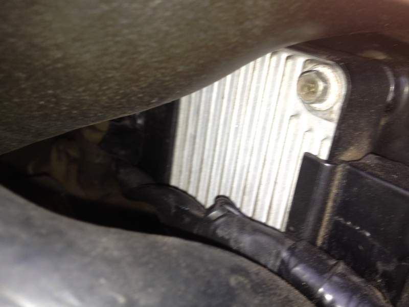

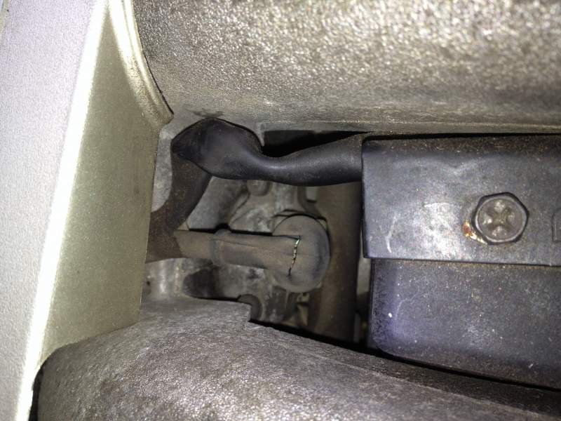

  4. Ok Right just had a look, warning some newbie question but here it goes I think this is the ptu, was wondering if it was series 1 or 2 Also when referring to fuel injector connectors are you referring to these?

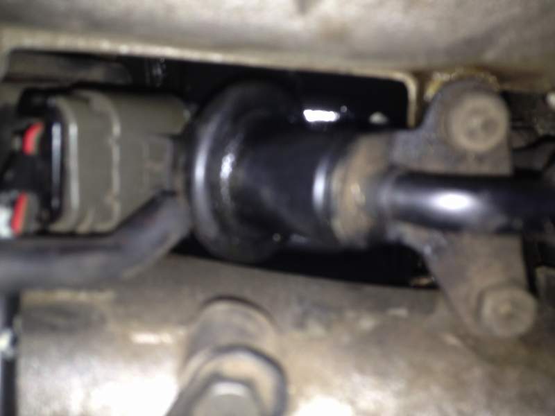

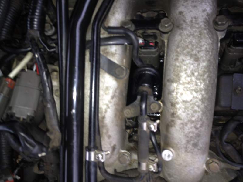

  8. Thanks, well while i was taking my plenum cover off, i noticed a fuel leak near that cylinder. I was wondering if this had anything to do with it?? every second there was a drop of petrol dripping out.!! Not sure if you can see but this is the valve that is leaking petrol, would this by any chance causing it??
