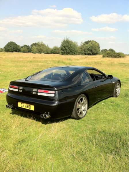

  18. Pic of the rear from a little while back
  19. Thanks. The door cards have been done in leather and the vinyl replaced with alcantara ( bitten off rather a lot) lovely stuff but hard to work with! Front lip is a car mad one I forgot I bought years ago and had it, along with the twinz sides, carbon dipped with a Matt finish. Rear bumper is a xenon and I have toyed with getting a twinz rear diff to fit but as is for a standard rear it will need someone with some good body shops skills to sort!

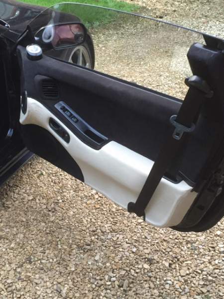

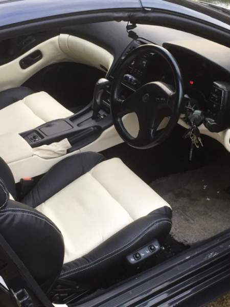

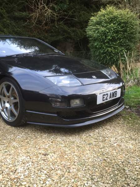

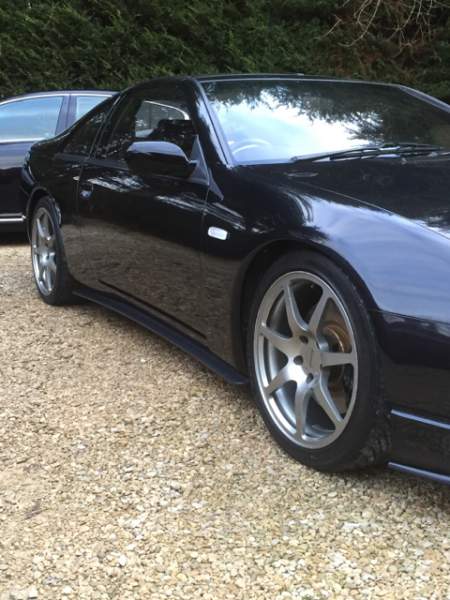

  20. As its not raining for once the Z came out of the garage for a bit. Few pics of some of the ongoing work. Front lip and Twinz side skirts fitted today and some pics of the ongoing interior re trim .
