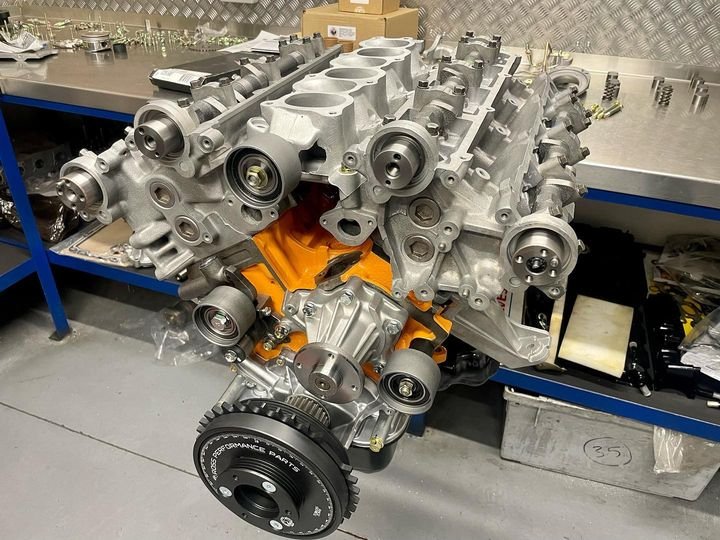

  2. Black Sunshine Z32 NA build sheet - Cylinder Bore - 87.5mm Crank Stroke - 83mm Cubic Capacity - 2995cc Static Compression Ratio – 12.1 Pistons – Wiesco WD-15481 Rods - Eagle Type CRS6071N3D Rod bolts – ARP Main studs – ARP Head studs – ARP Cam belt – Gates RPM Ross Performance Gold series harmonic balancer with integrated 36T Ross Performance VG30 Crank / Cam Trigger Kit GT101 Hall Effect Sensor Polar Engineering Z32 Billet Fuel Rail Fittings: Factory 5/16 DeatschWerks matched set Fuel injectors 550cc EV14S JWT 500 Series Race Cams, RM5 Solid Lifter Cams AZ32 -TORM5 JWT solid Lifters Supertech Valves +0.5mm JWT HD Single Coil Valve Spring Kit Cylinder head porting BDE VTC Pulleys adjustable BDE 3RD Element for adjustable VTCs BDE Late Style VTC Front Covers - Nissan 300ZX 94-96 Z32 BDE BULLSEYE Adjustable Exhaust Pulleys BDE SS Exhaust Pulley to Camshaft Bolt kit Z1 EGR Plates & Gaskets Z1 Throttle Body linkage Spacers and Shims AMS Motorsports 300ZX Transparent Timing Cover Clear OEM 300ZX (Z32) Timing Cover Bolt Washer Z1 Motorsports 300ZX (Z32) Urethane Motor Mounts Nissan OEM 300ZX Crank Key Z32, Z33, R35 AMS Motorsports 4 Piece Underdrive Pulley Kit - Nissan 300ZX 90-93 Z32 Gates Belt - Power Steering w/ 4pc UR V1 Pulley Set Z32 Clutch - Z1 Performance Street Clutch Kit with 6 Puck Ceramic disc Flywheel - Z1 Forged 4140 Steel Light Weight Flywheel Timing kit – Nissan Water pump – Nissan Gaskets and seals - Nissan Haltech Elite 2500 Haltech Plug 'n' Play Adaptor Harness Kit Z1 300ZX Alternator / Transmission Harness Z1 Motorsports EFI Engine Wiring Harness 300ZX 5 Speed Manual 1990-95

  10. Engine is home now, just need to add the fuel rails, new injectors, upper plenum, throttle bodies, and then the belts, alternator, etc... Everything should be good to go once the body comes back from paint. Will compile a full build sheet soon. Here's a pic of the motor on my new rolling stand whipped up from spare lumber I had left over from various projects.

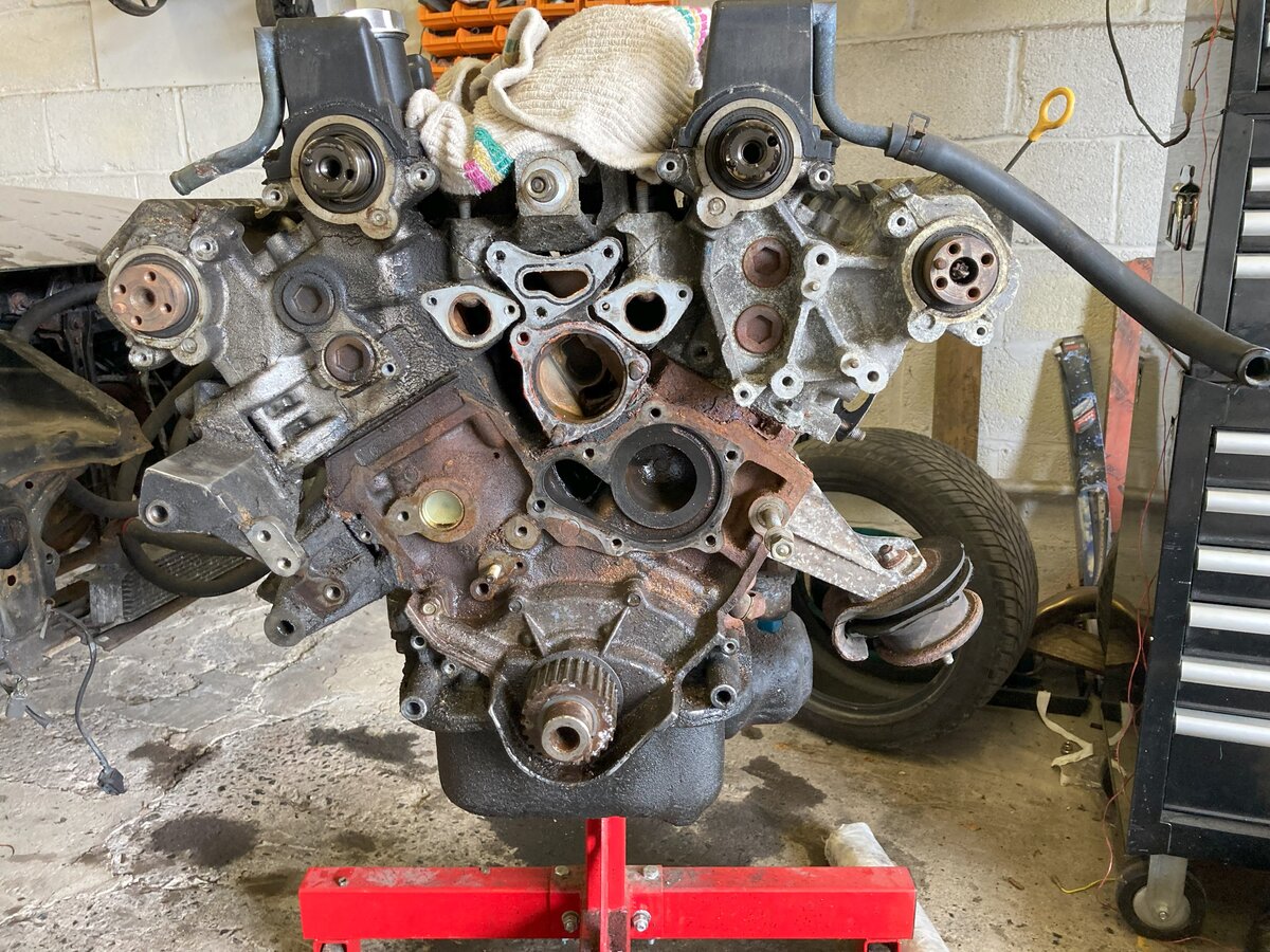

  20. Just a few pics covering the tear down plus the last pic I have of me driving the Z from Oct 2017. Engine looked OK when mounted but pretty worn as it was exposed. Bearings showed some wear after over 200K miles but not bad considering how hard I pushed at track days. t
