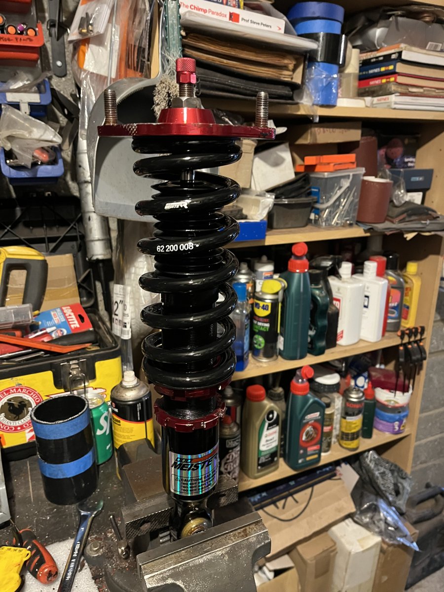

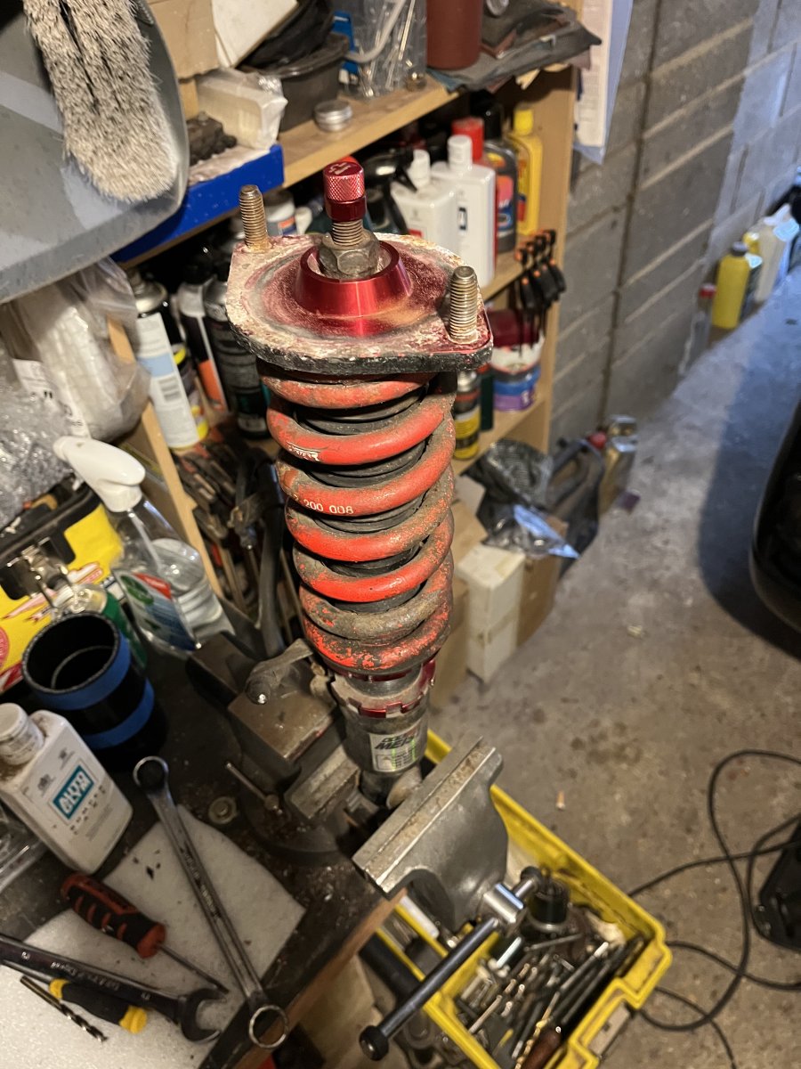

  4. Refurbed the front Coilovers today. After many years they were looking a bit tatty although still functioning well. New springs, top pillowballs freed up and relubed, and given a good clean. Before and after photos -

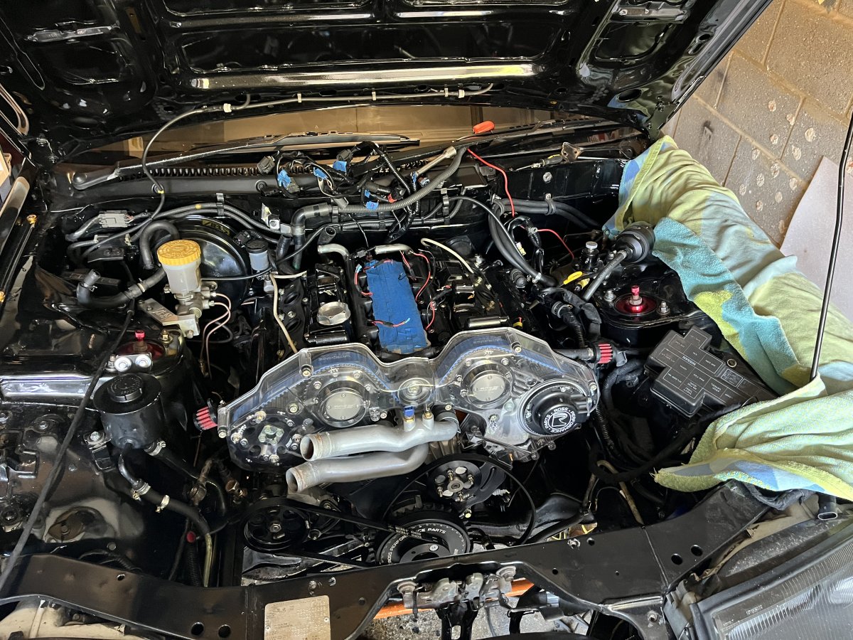

  11. Current state of the engine bay and a shot with her much bigger brother at C&M.

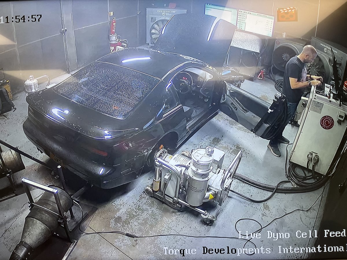

  12. Tune scheduled for Sept 1 by RaceCal using TDI’s dyno. Will post the results. Great to see there are other owners chasing the elusive NA power!

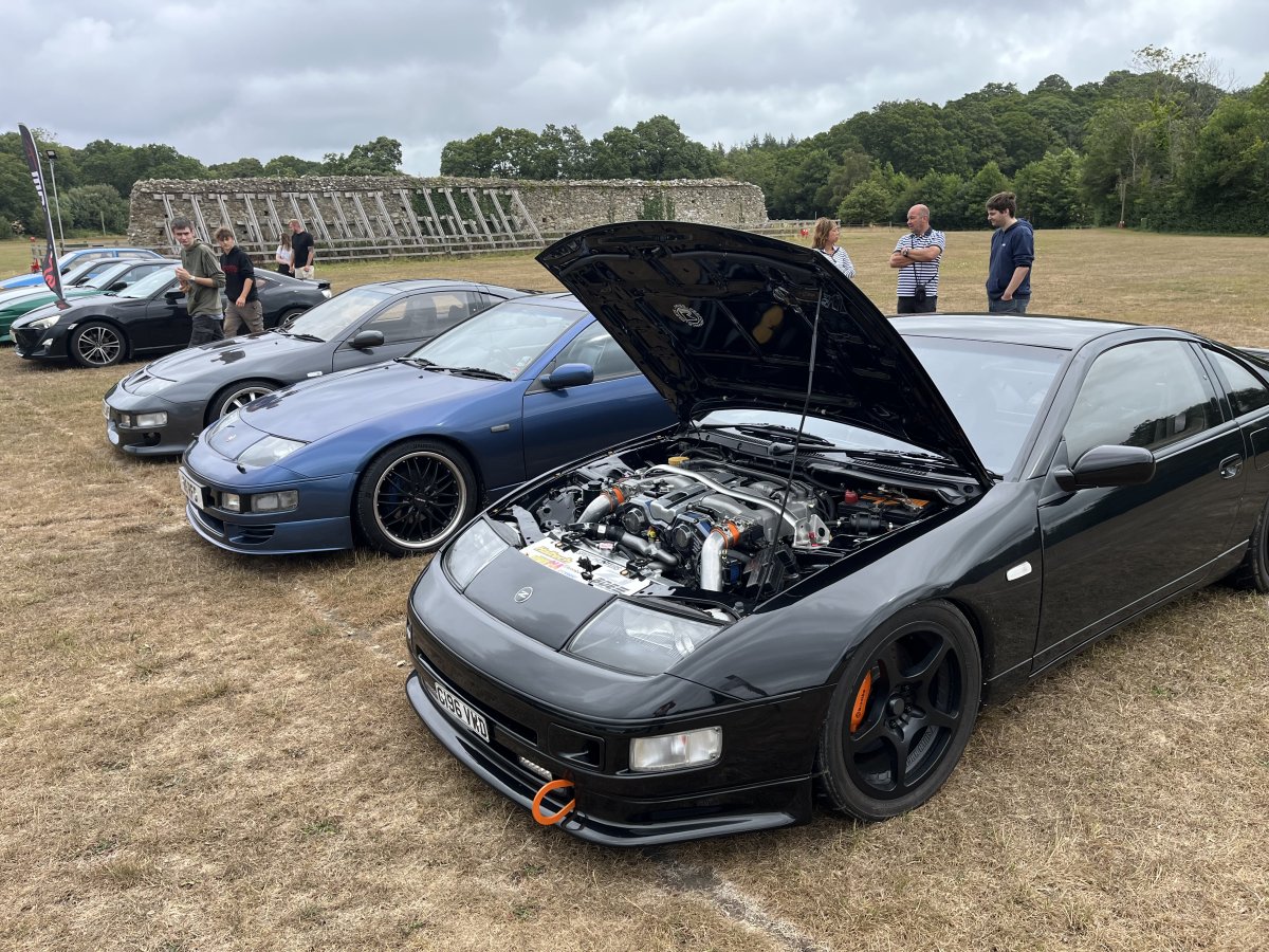

  14. Great day out at Beaulieu! Cars got a lot of attention, thanks for arranging this Richard.
