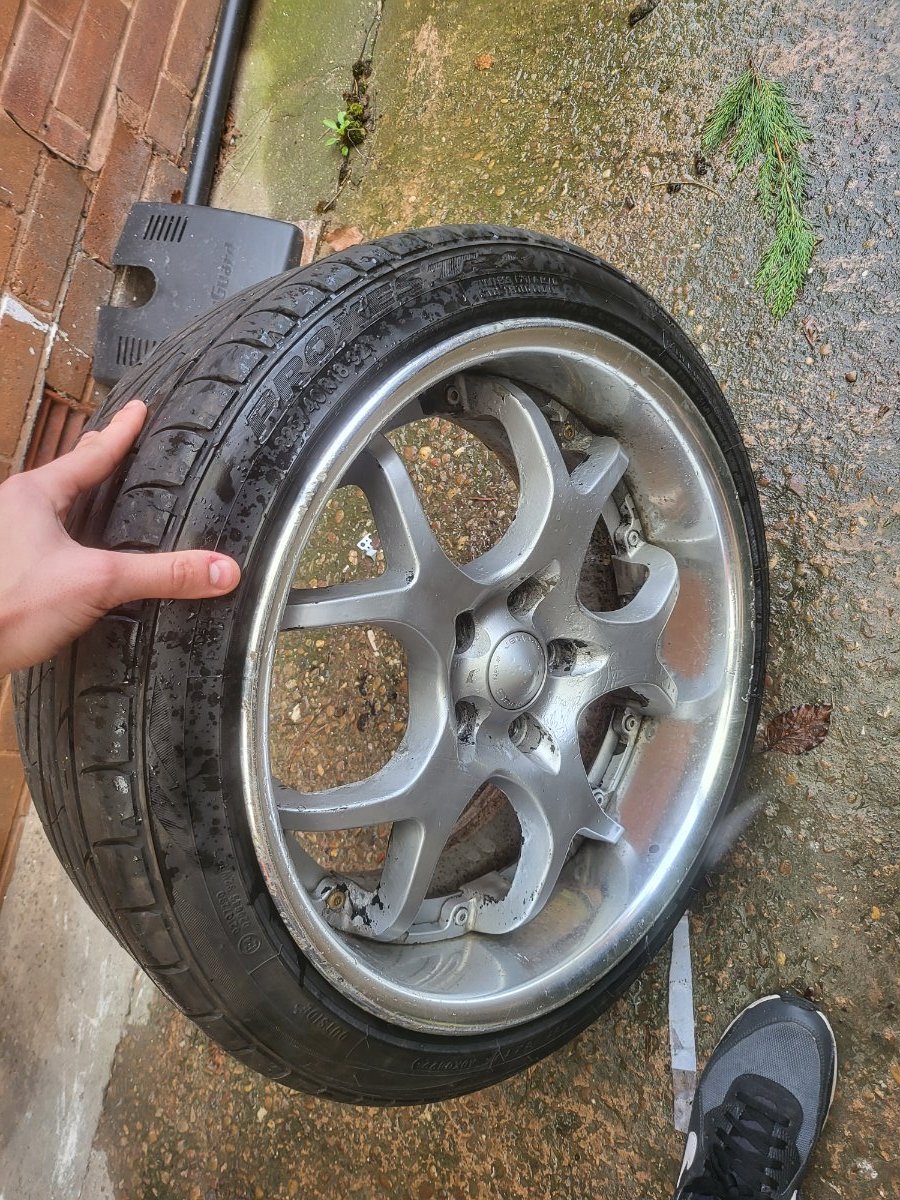

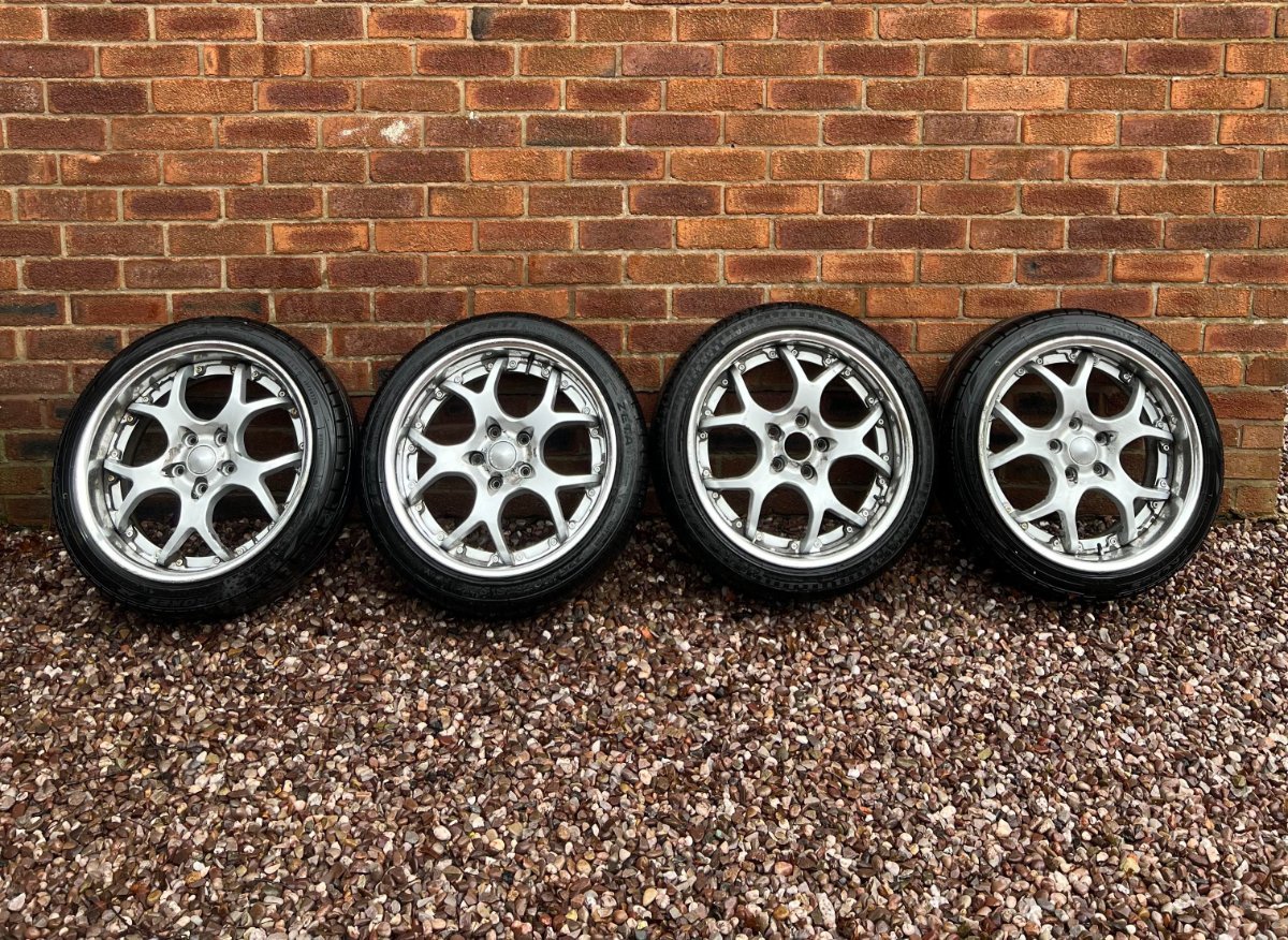

  3. After 6 months of not giving the ol girl some attention in the garage since the birth of my daughter, I thought its about time I did when I got the message that the wheels I wanted over a year and half ago was coming up for sale if I wanted them. So ofc I found a way to cough up the money! WORK Seeker LX 18×8JJ 18×9JJ Very rare wheel from the turn of the century from Japan. They need work but I'm willing to bring these back to their former glory hopefully in time for summer! 🌞 Also managed to find 1 person selling a centre cap from japan which is a great start! 👍

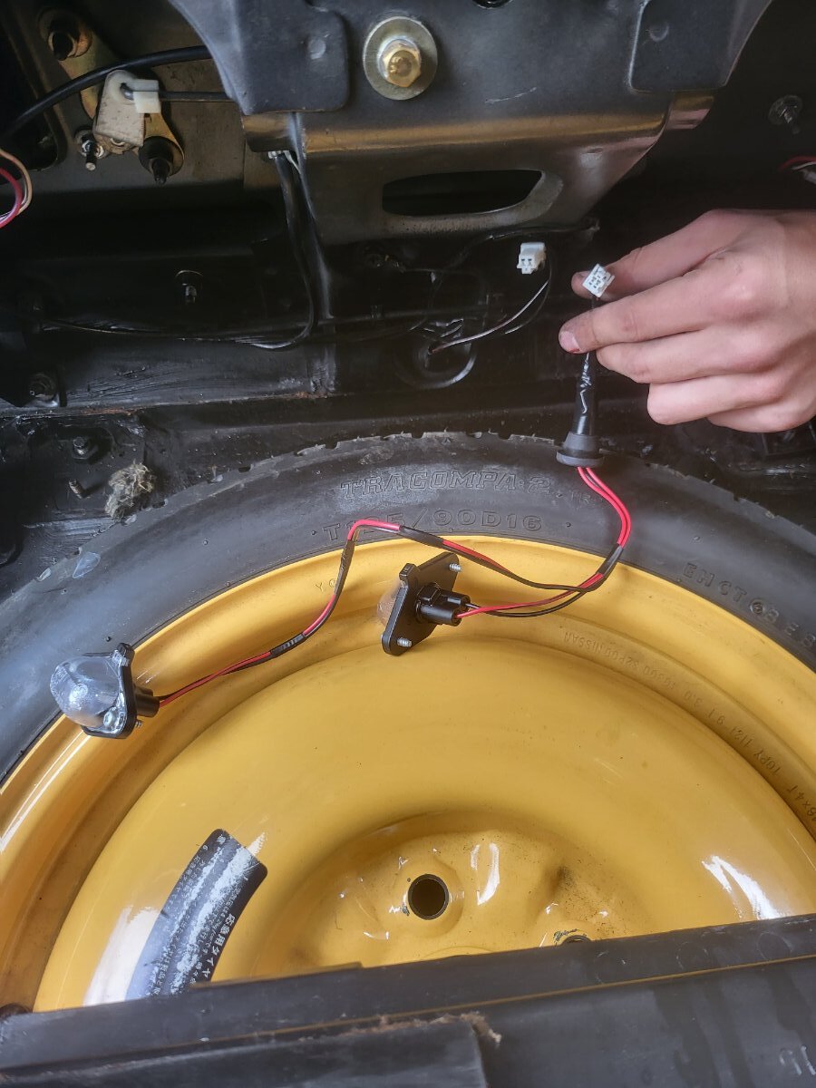

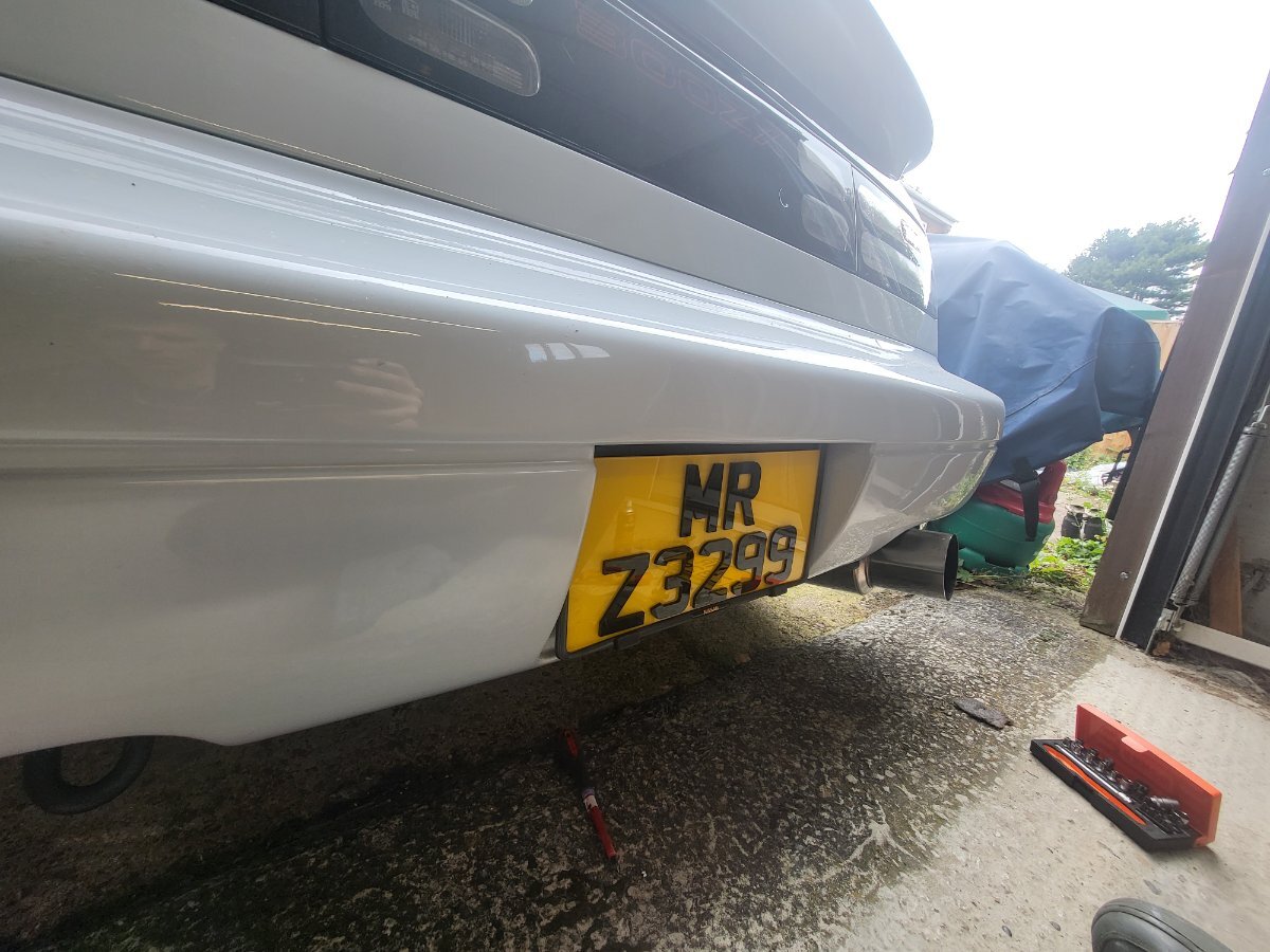

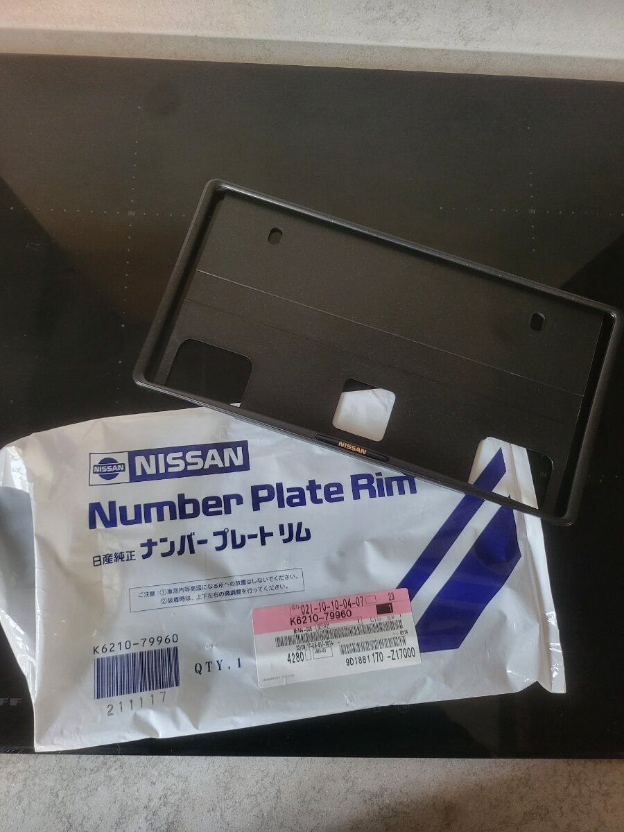

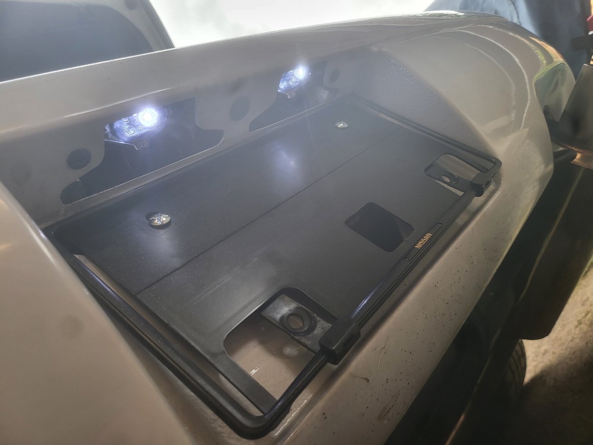

  8. Had a little time today seen a though I couldn't make the 300 meet as the car isn't quite running right Changed the rear reg plate harness as the bulb holder was crumbling away so only 1 light was working Also fitted a new rear number plate backplate which apparently is pretty rare with "nissan" writing from japan. Also got some 4d plates while i was at it to add a little pop, imo looks loads cleaner Finished off with a clean 😃

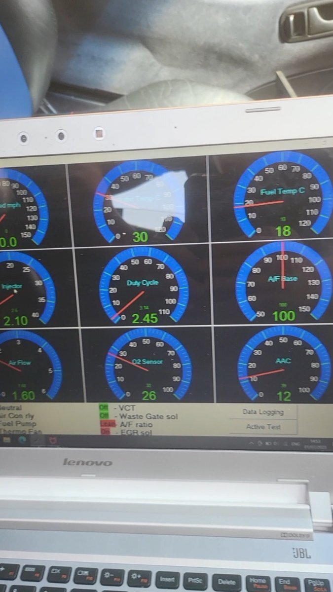

  11. Hi zedders, hope some of you older heads can shed some light on what may be my issue with my Z Started hunting very badly when engine gets warm, iacv was my first idea, had it off and cleaned up , both solenoids click with 12v and ohm out at 10 & 22 ohms Maf looks in good shape , tps is in spec also Only thing that does look strange is on the datascan, the aac reading is on 12% when cold and hot , Initial startup it was at around 36% but dropped rapidly to 12% , so something isn't right but can't use the car as it basically stalls out when warm idle is all over place I've read up it should be at 15% when warm is this correct? Any ideas much appreciated guys
