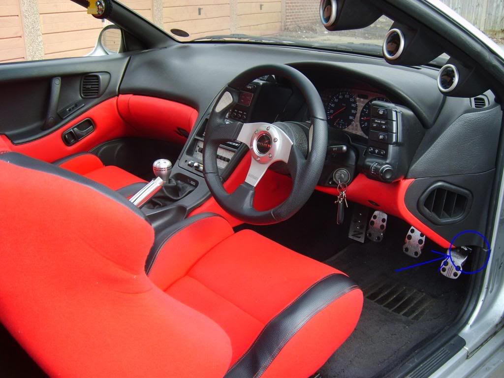

where is the plug that you read from ?
thanx mark is that a turbo timer u got in there ?
errr, there is one there but, it cant be seen in the pic. if you're on about the thing in place of the stock clock then, its a DSBC;)
yep thats what im gonna get next 8days till payday then the zed will be spoiled lol
