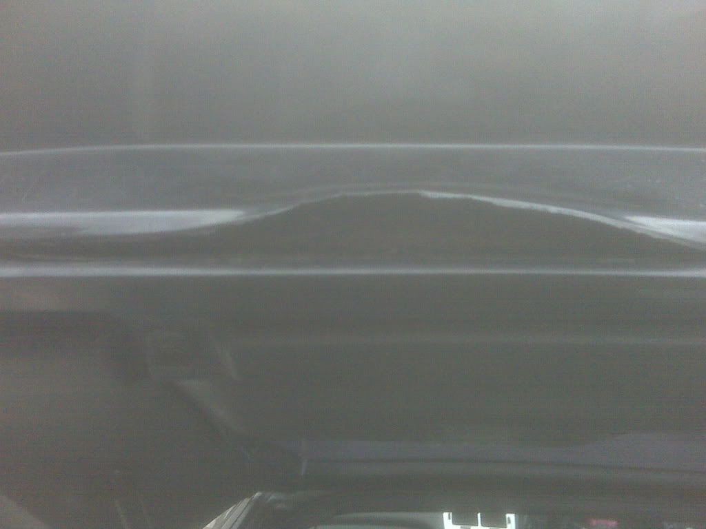

Boot differences throughout the Z
iv got a 91 Jap TT, (manual of course ;) )
notices today the rubbery standar spoiler is coning away from thre boot.
its the part where the badges are, which are all rubber aswell?
so the rubber bit is coming away, and is rusty underneath!
ive seen other Z's with different tailgate, as if thers an extra bit to follow the lines of the rear lights.

honesty once you take the spoiler off you will more likely see more damage. then what your currently seeing. the foam spoiler has bonded in screws which will have gone rusty too. which would in turn start to rot the tailgate from under the spoiler . the first thing you will now about it is when water starts to pour in from under the spoiler where it has rotted right through.
take the old foam spoiler off. and if you still like the shape replace with a fibreglass replica one which is exactly what i did.

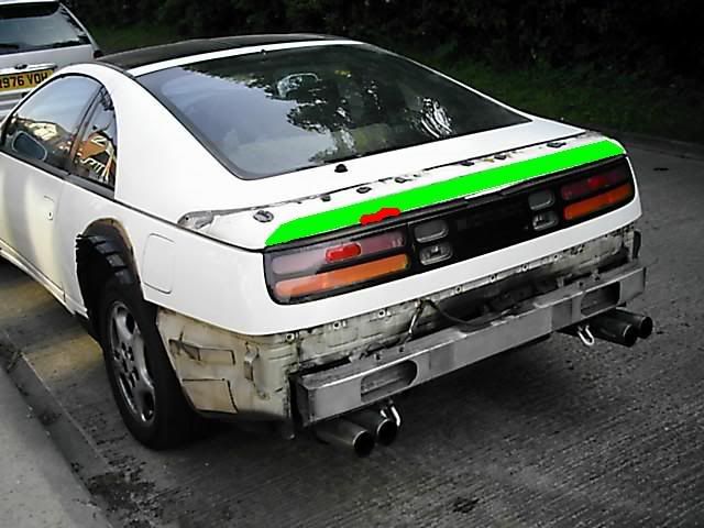

just as i was bored, i edited the picture, the green part is the strip i refer to,
and iv drew a red line on the bad section.
how do you remove the standard strip? where the perspex would replace?
imagine easy to see when the spoiler is removed.

There is no strip there as standard. The spoiler is one piece and covers the entire area. THats literally what the boot looks like when you remove the spoiler.
All thats there is some edging strips which pull off.

i thaught there was a standard strip that could be removed.
how does the perxpex one attach then? it goes ontop the standard strip i take it?
It bolts directly onto the tailgate, but its best to use sealant as well to stop fumes and moisture getting behind it.
