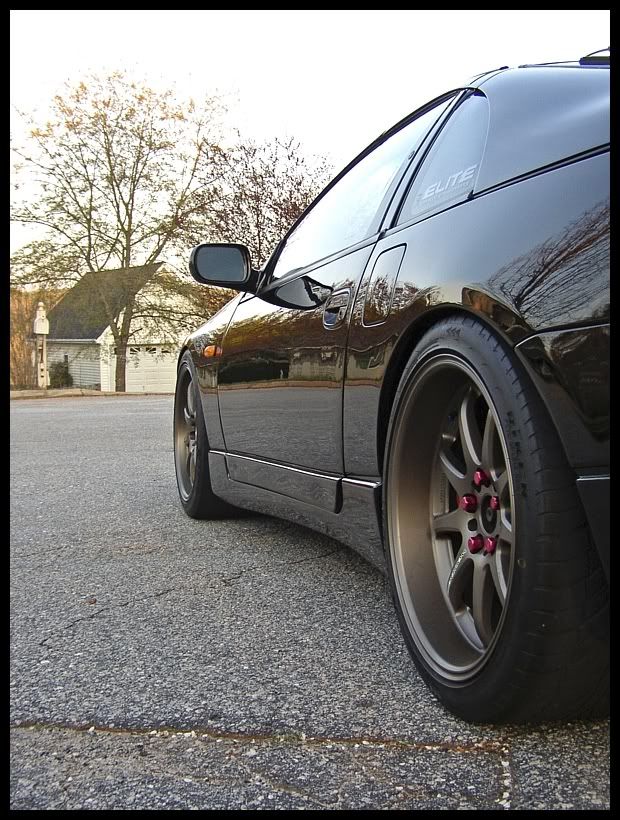

This is the look im after:

Nick, I noticed today that Andy's car had the look that your after, what's he running?
Paul
with 10 inch rears, and an offset of 18, it will stick out like jordans love pillows :xxx:
Gor for the +38 mate, at least you can space them out if you feel like it, whereas going backwards is a hell of alot harder im afraid :cry:
Im pretty sure the rear in MclarenF1kids car in the pic above is a 10" wheel with +38.
so definatly the +38 . You wont need spacers for the rear.

no, he's not si. He is asking about +18 or +38 for the rear. He's not asking about fronts.
Cheers guys, i remember there was a thread that Si put on about what offset MclarenF1kids car was running, which i couldnt find for love nor money.

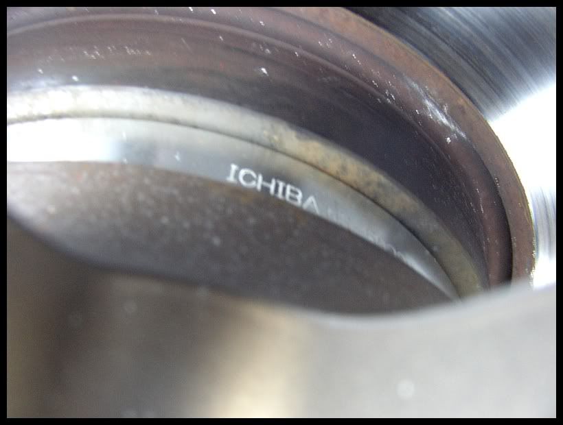

The main reason i ask is that i have another photo of his car which shows he is running spacer (below)
The thing is i dont know if this is a front or rear wheel. If it was a rear with a +38 offset running a 20 mil spacer, then im guessing a +18 with no spacer would be safe...
And yes im running +18 on the fronts
Thats front spacer. He does'nt have spacer on the back. Has a +18 front offset and had to roll the arches to stop rubbing.
10" with +18 would be sticking right out of the arches, 10" with +38 is spot on.
Cheers dave, thats cleared that up.
Dont suppose you know what offset he's running on the front?
8.5" front , 10" rear +38 all around, but using a 20mm spacer to make the fronts a +18.
