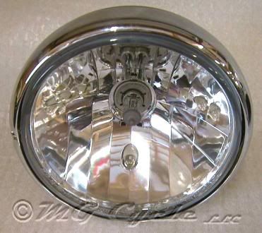

A slight variation on Si'd idea. How about doing what most naked bikes have, and drill a small hole into the reflective part of the main beam, like below:

What I did: drilled an extra hole in the 99-spec indicator pod (or corner light, or whatever they're called) and put in an ultra bright LED, that I now use as side lights.
It's basically similar as to the motorcycle headlight in a few posts up.
