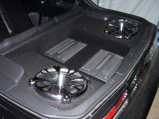

here a couple of sneaky shots for ya... as you can see the box itself only follows a very rough shape of the trim. its the top panel which follows the exact contour to make it look neat...
you have seen what it looks like when installed. it sounds like you want a very similar design to mine but to sit taller in the boot and have the woofer itself round the side and the amp underneath? be nice to see what it looks like as iv never seen one like that i dont think.
You dont need a vent tube (Aeroport), they are only really used to tune the boxs optimum frequency and add a little bit of potential air space, thats why they are mainly used in loud setups.
A sealed box would be what you are after. Make sure the box has internal airspace to match what your sub requires (X.XX cubic/ft). I found that putting some thin parcel foam inside the box helps rid any nasty vibrations
heres the sub boxes in mine,but it leaves stuff all room for targas and a spare wheel now comes in a can lol
