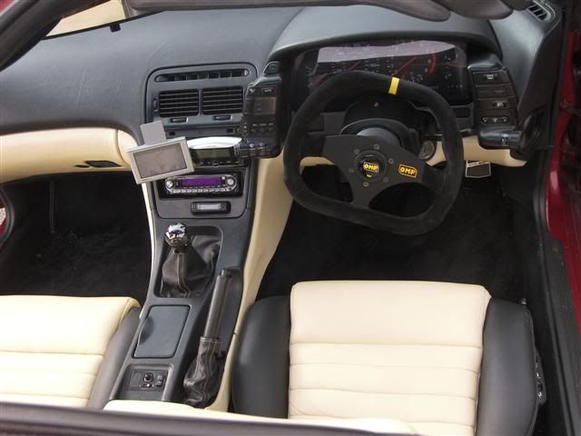

I have one of these fitted.
http://cgi.ebay.co.uk/HKS-Type-0-Turbo-Timer-for-Impreza-Evo-GTR-GTS_W0QQitemZ290155603603QQihZ019QQcategoryZ72205QQrdZ1QQssPageNameZWD1VQQ_trksidZp1638.m118.l1247QQcmdZViewItem
Fits in the slot where the clock is without too much hassle. Simple wiring harness connection withthe right cable. Type 1 does the auto from speed revs etc.
You can see it in this pic
You can get them in black so they blend in with the dash if you want.
Darrell
My Profec b II boost control sits where my knackered clock was see below. Never fancied a turbo timer as I always wind the car up and down when coming and going but most of them as mentioned above have other useful functions also
