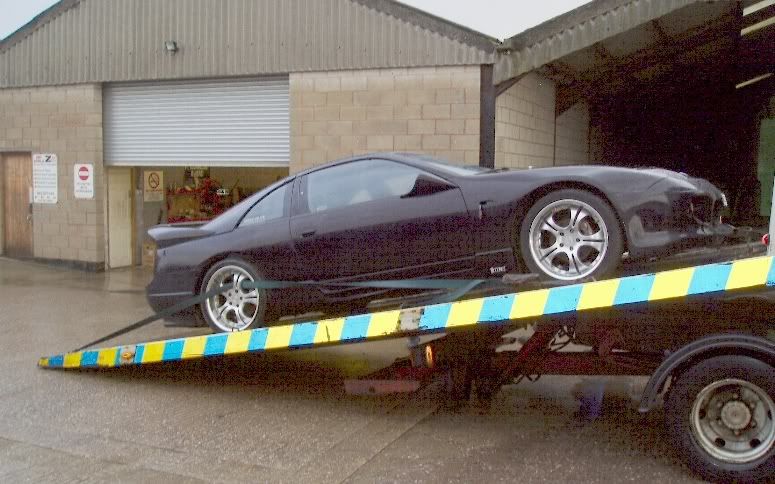

Heading North on the M5 on the back of a tow truck. Could have easily been mistaken for a skip from what ive been told. :(

yep its shunters old car, i think next step could be zed heaven
Shame, after all that time being repaired, you're considering breaking it.
Its having an assesment over the next couple of weeks, when i get the mechanics report back i will see what to do. If its saveable it will be saved, but I'm not going to waste a mechanics time trying to polish up a turd LOL

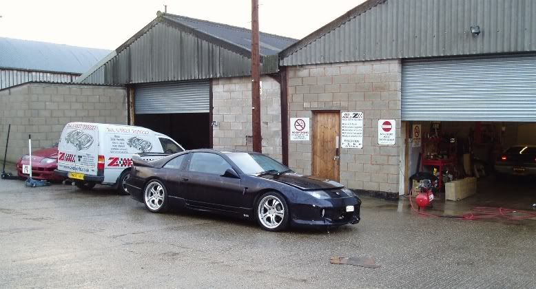

Car arrived
dont know why you have to click link to see pics the have the  and tags
please note picture taken at place where work is to be done and not at the place where any of the previous work was done

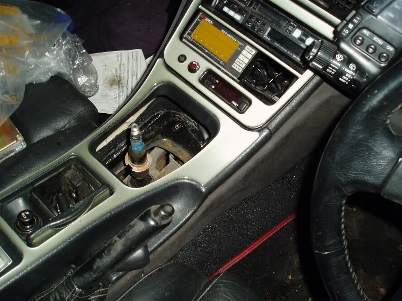

you would have thought the gbox would have been put back together

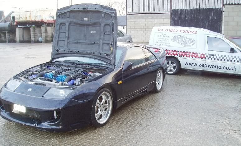

1st part of assesment. Quite a lot to do there me thinks.
Mechanical
Rear shock absorbers securing nuts loose at the top in the boot area
N/S outer hicas bush and inner hicas steering arm bush worn ( MOT failure)
O/S turbo bolts missing
Gaskets / sealant missing from both down pipes where they meet the turbo elbows
Missing exhaust downpipe flange nut
Small section brake pipes to the rear calipers need replacing
Front brake calipers are seized on
Gear lever support bracket missing
Exhaust heat shield missing
Other
Front N/S tyre tread below legal minimum limit ( MOT failure )
Front O/S tyre tread close to legal minimum
Paint work very dull and needs a good cut and polish
A quick check over the engine has thrown up a couple of issues where it looks to have some pipes not connected correctly and some mixed up
and there is more
Dump valves not connected ( no recircs either)
Air con outside sensor missing
Knock sensor failed
Air leaks on engine plumbing
Wrong spark plugs fitted
Idle speed incorrect set up
Throttle and cruise control cables too tight
Aiv supply pipes mixed up at throttle
Brake fluid low
Battery clamp missing
Fuel filter bracket bolts missing
Front shock absorbers both loose at top mounts
o/s head lamp very poor beam ( incorrect bulb fitting)
Steering wheel centre rubber pad pealed back
Small corrosion patch on O/S inner wing top
Cooler bracket insufficient
Undercoating cleaning of surfaces etc
