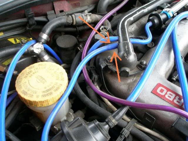

Is this the original dash boost gauge pipe? If so can I tee off this and do I need to use one of those pulse eliminator tee's or does an apexi guage have one built in cheers

correct me if im wrong but the vac pipe thats arrowed is the stock boost sender pipe, the electrical wires go through the fire wall not the vac

I thought that one (the one you have arrowed was the bonnet cable release?) good job I asked anyone else shed any light?
the one ive arrowed goes into a plastic box with an electrical plug on it, i can asure you its not the bonnet. i got rid of mine all together
must be the one lower down I'm thinking of then. It's a bit dark out now may get a tourch and have a look in a bit. Found a few tubes around near there
earlier with cables and thought it was the actuator solenoid. That whey I though it was the one I have circled. I'm getting paranoid now. The balance bar ... is that the long black steel bar that goes across the engine at the back with a few pipes attatched to it?
Yes it is bud ...
'T' Piece it into where ive arrowed mate.. Nice and simple :).

I like simple suits me fine. Not so worried about illum yet as it is a white dial but would be nice. Might have a look around the green circle ignition when I get to feed the hose through bulkhead. cheers :duffer:
