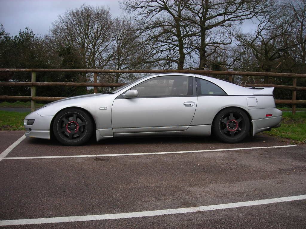

Just finished installing new KYB's and Ground Control adjustable coilovers with Eibach springs. First pic is with the original suspension. May have gone a bit too low in the back, what do ya think?

Shame the front end isn't a little bit lower, but the back is very low for Eibachs. Looks good! Lovely looking car overall. :duffer:
Looks great buddy!!.. :nana2:
I will be attempting the same thing shortly.. So I know where to come for advice/help ;)
What type of wheels are they mate? Look like mine but with a lot deeper dish at the back. I want :hyper:
Yes I agree, but the good thing about the Ground Control set up is I can set them at any height. After pulling all four wheels off twice and adjusting them a little lower each time, I figured I would let them settle for a few days and then do a final adjustment.
I'm not positive. They came on the car when I bought it. They have "Bozway" written on the center caps, but I have never heard of this brand. Do look nice when their cleaned up...
Looks the muts nuts mate. ;)
Looks great but as already said, get the nose dropped some more, dont want it looking like someone's nicked your engine!!! ;)
great wheels. Back looks great but as above, front needs to go much lower, it looks stock height.
Looks great mate, id leave it as is now....
Looks awesome mate but Definately lower the front mate, you know you want a lawnmower :rofl:
FFS! Alright, first thing tomorrow morning I'm ganna slam the front right down to the ground!
Now leave me alone while I watch the game! :nana2:

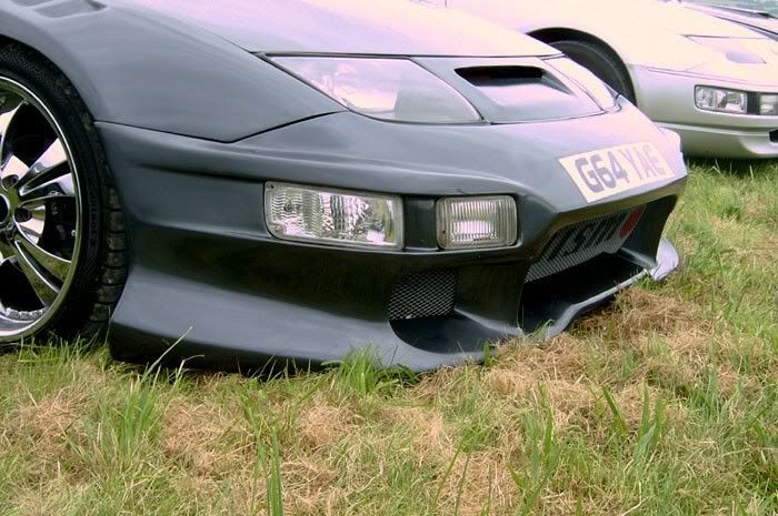

hi bud ...
mine is @ the limit ......
and silverbullet's not far off ....
wozza ...
Mine just takes the pi$$
:shock: can you go anywhere like that scotty?? :shock: i need my grass cutting!!!
as anyone told you to lower the front yet buddy???!!! :rofl:

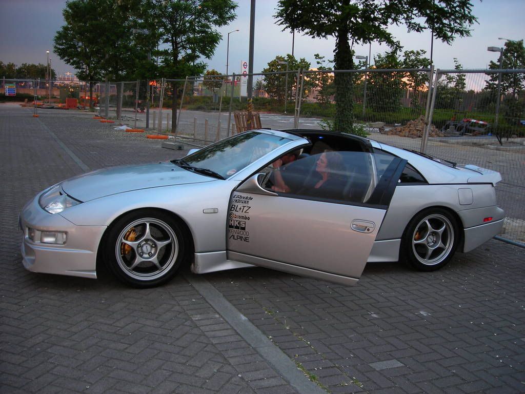

That's not a lowrider. This is a lowrider
second one down with a "cheech and chong" steering wheel!
