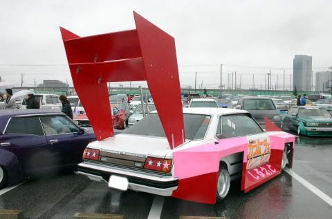

If you want to create downforce then you need to fit a wing, ie, an upside down aeroplane wing, as far away from the bodywork as possible.
As demonstrated here : -
