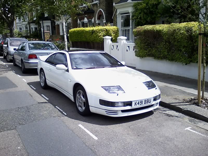

Removed the front indicator amber lenses...

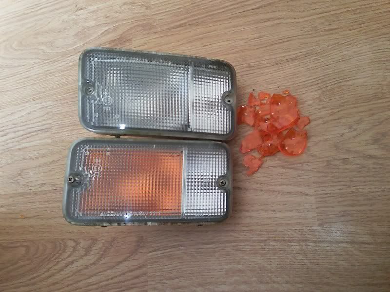

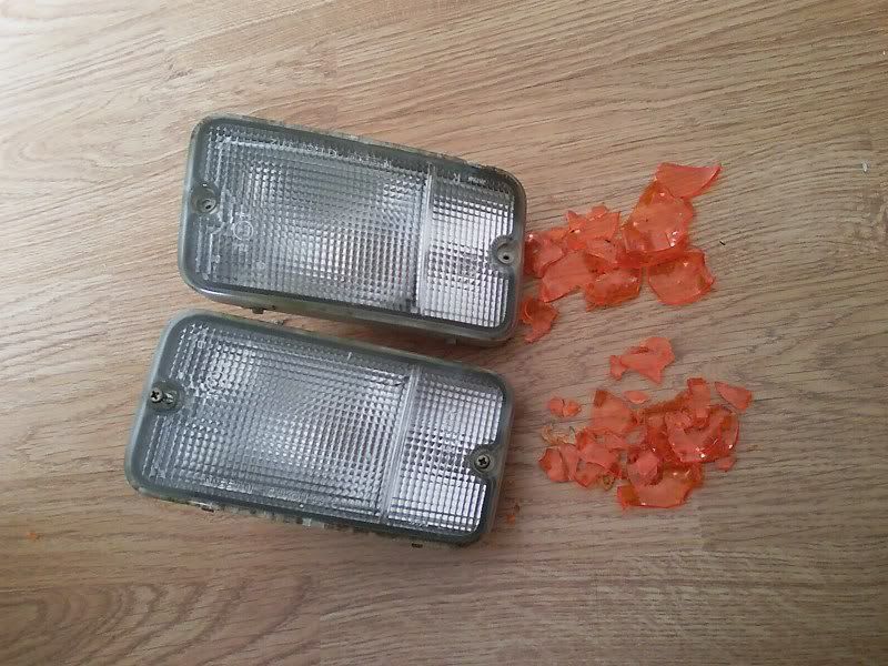

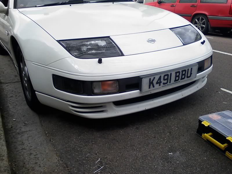

I removed my lenses today. took about 20 mins and cost £5 for some chrome indicator bulbs...
Makes the Z look alot better!
Before>>>>
During>>>>>>>>>>
After>>>>>>>>>>>>>>>>>>>>>>>>>
The amber lense was a bit tricky to break out as it was soft plastick and bloody tough!!!!
"orange fogs" me thinks, "no its a uk you cok head" :mac1: ;) looks much better and ide tint the lenses down now to match the centre bar

Yours looks miles better mate.

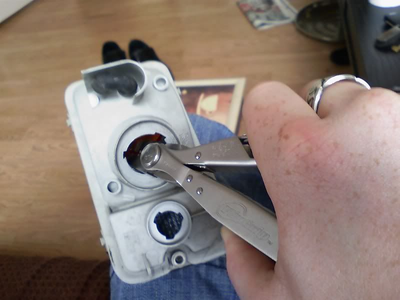

Excuse me for sounding stupid, but how did you break the orange lens, i tried with long nose pliers after it came off its mounts, its not thin plastic either ?
Looks brilliant mate.
How did you do it? Can i borrow your bits to do it if you have them in London? I have been meaning to do this for ages since i got clear side repeaters and got clear rear indicators, even got the silvertec bulbs ready, but just too tight to buy the tools!

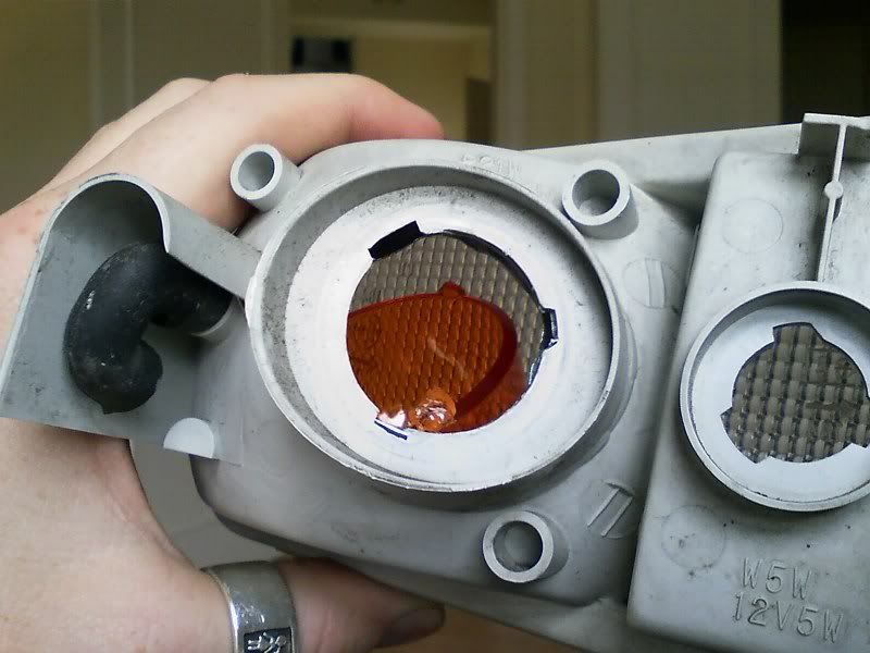

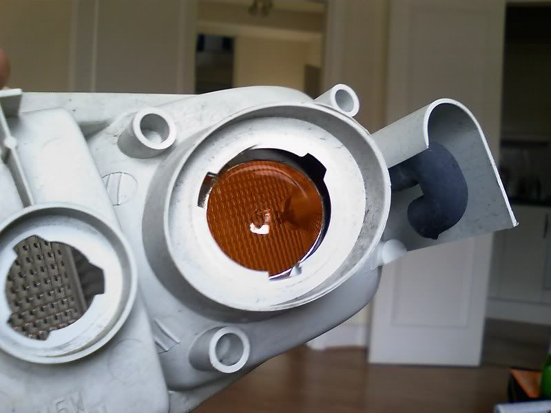

It was a complete pain. the plastic is thick and tough. i had to use the light socket for leverage and break bits of at a time and crack it down piece by piece. If im honest i mangled up the first light socket working out the best way. The second was fine and both water tight.

... how did you break the orange lens, i tried with long nose pliers
http://www.300zxtt.co.uk/silvermach1.htm original "how-to" suggested soldering iron to melt a few holes before you break it off the mount. That worked. I then tried a hole saw plus tin snips. Doddle.

So now mine are off the mounts ive got problems??
Well it means you can't use my methods ;) but just get something a bit butcher than the long nose pliers you have. EG tin snips or whatever. All you have to do is break up the orange plastic into bits small enough to come out. As per crotchrocket's method.
