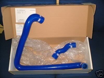

I have just brought a set of samco silicon top and bottom rad hoses to replace my leaky standard rubber ones. I have an aftermarket water temp gauge that used to have the sensor going into the top hose (hot water out of engine).
As the samco top hoses has quite a pronounced bend in the top pipe (presumably for thermal expansion or turbulent mixing purposes) it would have been impossible to fit the adaptor holding the temp sensor into this pipe because it would not fit properly and be leaky.
I fitted it to the bottom hoses instead as this has big straight lengths which makes it easy to fit. i realised i would have to figure out the temp drop through the rad (which looks like being between 10-15C at operating temp) and add this to the display temp to get the engine temp.
But i am not really satified with this. it takes along time for the rad out temp to reach a stable value (the radiator metal must absorb alot of heat and take along time to reach a stable temp between the air and water sides) when im sure the engine temp will be up to normal operating and it is just not very helpful to know the temperature of water coming out of the radiator.!
Is there another place or way i can fit the sensor to the engine out stream. Is there a different adapator or collar i can use that is not too long for the bends in the top hose?

trouble is my new top hose looks like this
ie it hasnt got enough straight length to get one of those adaptors in.
Is it a standard rad? I had to cut a fair bit out to make it fit with my Koyo.As you can see theres not much pipe left.

The picture you say about your top hose being to short is your 'return' is it not? Top hose is the short bit in the box which you could put your adaptor between like Rainbow ZTT has done?
