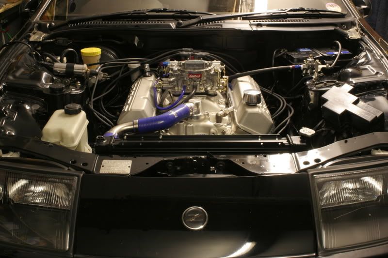

Chevy V8 nearly ready.
Few pics just before it comes out of the garage. (Just in case I wrap it up at the first roundabout)

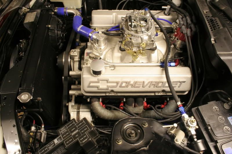

Just got to tidy engine bay a bit, align suspension, and fit the boot trim and it's ready for the road. Apart from the front suspension being too high now. It may be too high to drive far so may be back in the garage next weekend. It's about 30mm higher at the front and 12mm higher at the back now, due to losing all the Nissan stuff.
I thought it would be about the same as I've put in a fair bit of extra soundproofing, but it seems as if it's going to be 100-150kgs lighter at a guess.
Going to run a carb at first, to run engine in, and fit injection and the blower on later in the year. Unless I don't like the car in which case I'll get rid as it is.

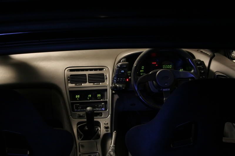

Should be nice tho, with the soundproofing, rattles eliminated, polybushed, 6.3 Chevy, Tremec 5 speed box, massive propshaft, Wilwood big brakes, digital dash and centre console gauges, steering wheel raised 30mm, nice seats, HID's, 99 spec lights, etc.
There's about 120metres of wire gone back in just to get everything working again, and to be honest the electrics have been the biggest pain of the lot.

fantastic absolutly stunning mate. out of curiosity why did you raise the steering wheel?
**** it I'm fitting a V12 :D Nice conversion though! Amazing how oversized the VG30 seems in comparison!!!

Cheers, Being 6'3" I found I couldn't see the top of the dash or get my knees under the wheel and operate the clutch. Not so bad when it was an auto but couldn't have driven it comfortably now.

Have to say though yours has got the suprise factor of opening the bonnet and seeing the words Chevrolette alongside a beautiful looking V8 block :D

Yes I'm sure their's will be nice jobs too. One thing I would say tho is that engines don't get much more reliable or tuneable, or as cheap to tune as the good old small block Chevy. The only downside is the cost of going to aftermarket fuel injection.
