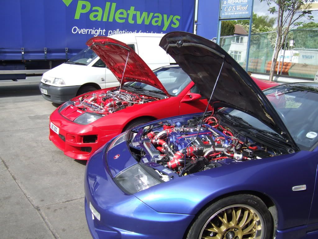

WHY?! show me your engine bay. colour coded etc etc
prefer a black z for comparison if possible

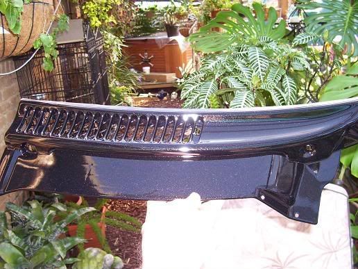

here is my effort, just normal nissan paint, no need for heat proof but you could use it as a primer to act as a barrier
not ott?

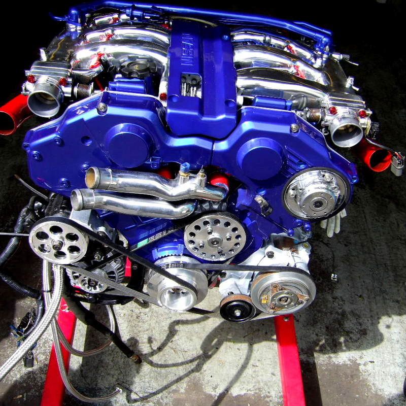

Here is my blue cars Cam covers painted and fitted prior to engine install and second picture in after 2 years.
Very nice work there mark

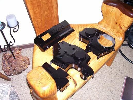

Ive done my engine bits with the same stuff that i did my brakes with, as each coat gets it smoother, am actullay doing my cam covers too at the mo, looking good, will post ups covers in a few days

i used 2 pack for all my engine plastics jono,it comes up very nice :cool:
