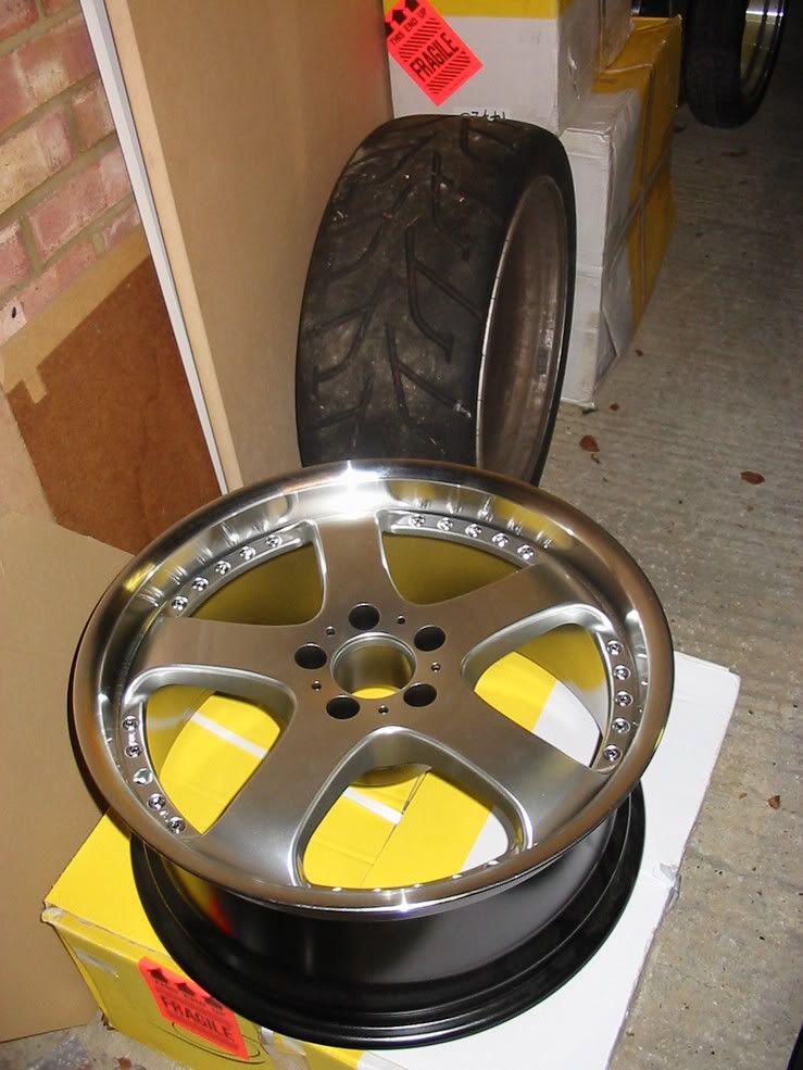

The wheels I have already imported and boxed are 19s like this Axis
Now I thought I would need trick springs, I have KYBs at the moment but they are too low and not height adjustable. (see car below)
I never thought of going to a stock spring and damper set up.
I am concerned about clearance for the spring and cup mainly up front.
Offset on the Axis is Fr15 Rr 25 so that puts the wheels further out, unless Im mistaken.
Does anyone out there have a really good set of stock suspension to swap for the KYBs
Ok Thanks guys

Yeah thats what they are 8 fr 9 rr using up a lot of garage space all in there boxes but I dont see its a good idea to put them on now when in mid winter, with all that salt, also as mentioned before Id like to sort the suspension first.

This is a front wheel the rears have a bigger lip
