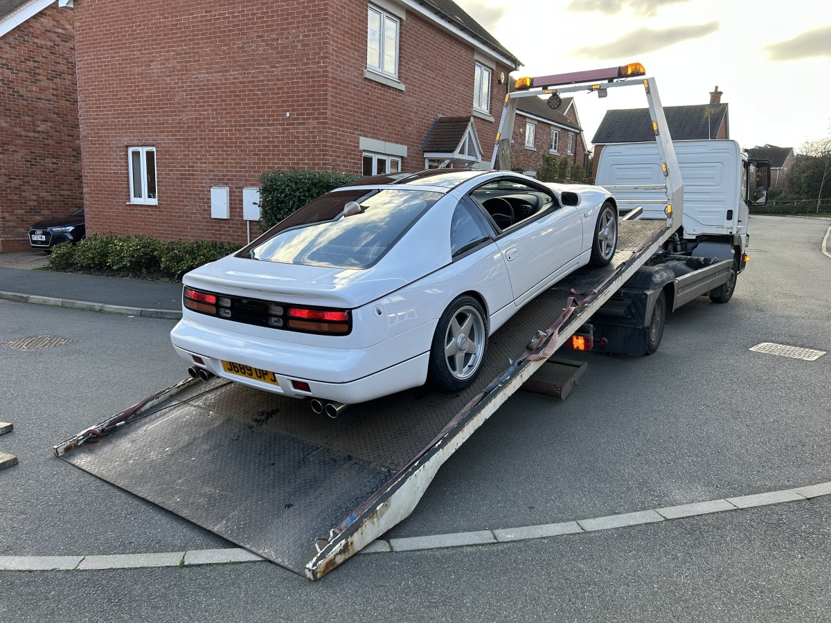

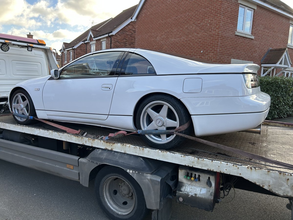

It arrives tomorrow on a truck, I’ll post more photos, give some more info about it and go over my plans for the car. I’ll use this as a blog to show progress.

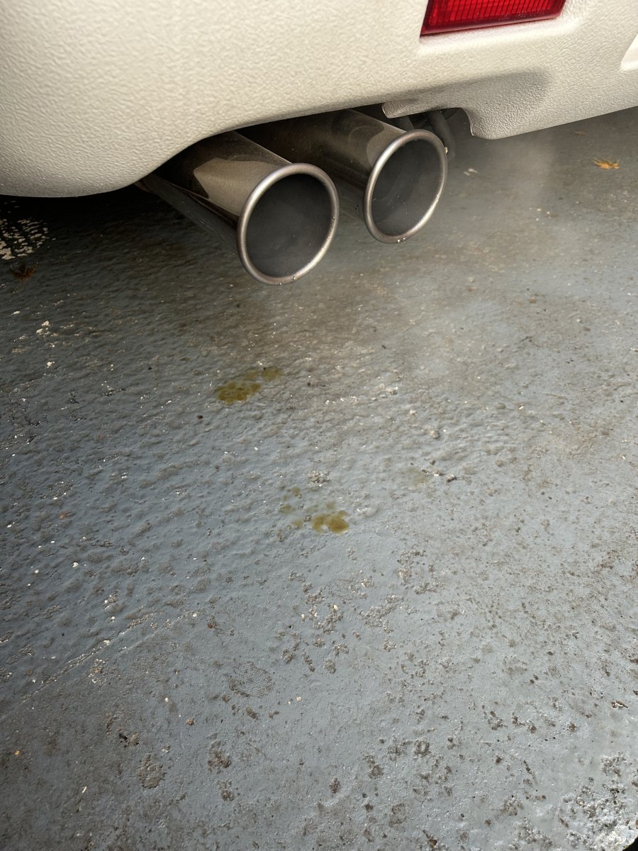

So I’ve got another thread running to try and find a solution but I started the car yesterday, first time for probably about 4-6 weeks.
Started fine, seemed to have a misfire on the drivers side bank. This did seem to clear after a while of running so may have needed to clear its throat.
Had a lot of condensation out the exhaust which got more as it warmed up. Started to smell a burning smell and a bit of white smoke mixed in with the condensation.
Noticed oil in the water that was dripping out of the exhaust pipes.
Goes in bodyshop tomorrow till probably after Xmas so won’t be able to resolve and most likely out of my skill set anyway

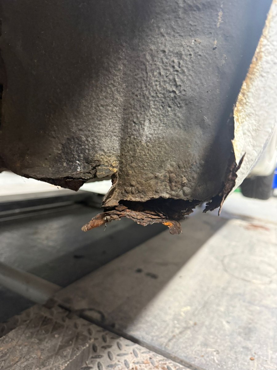

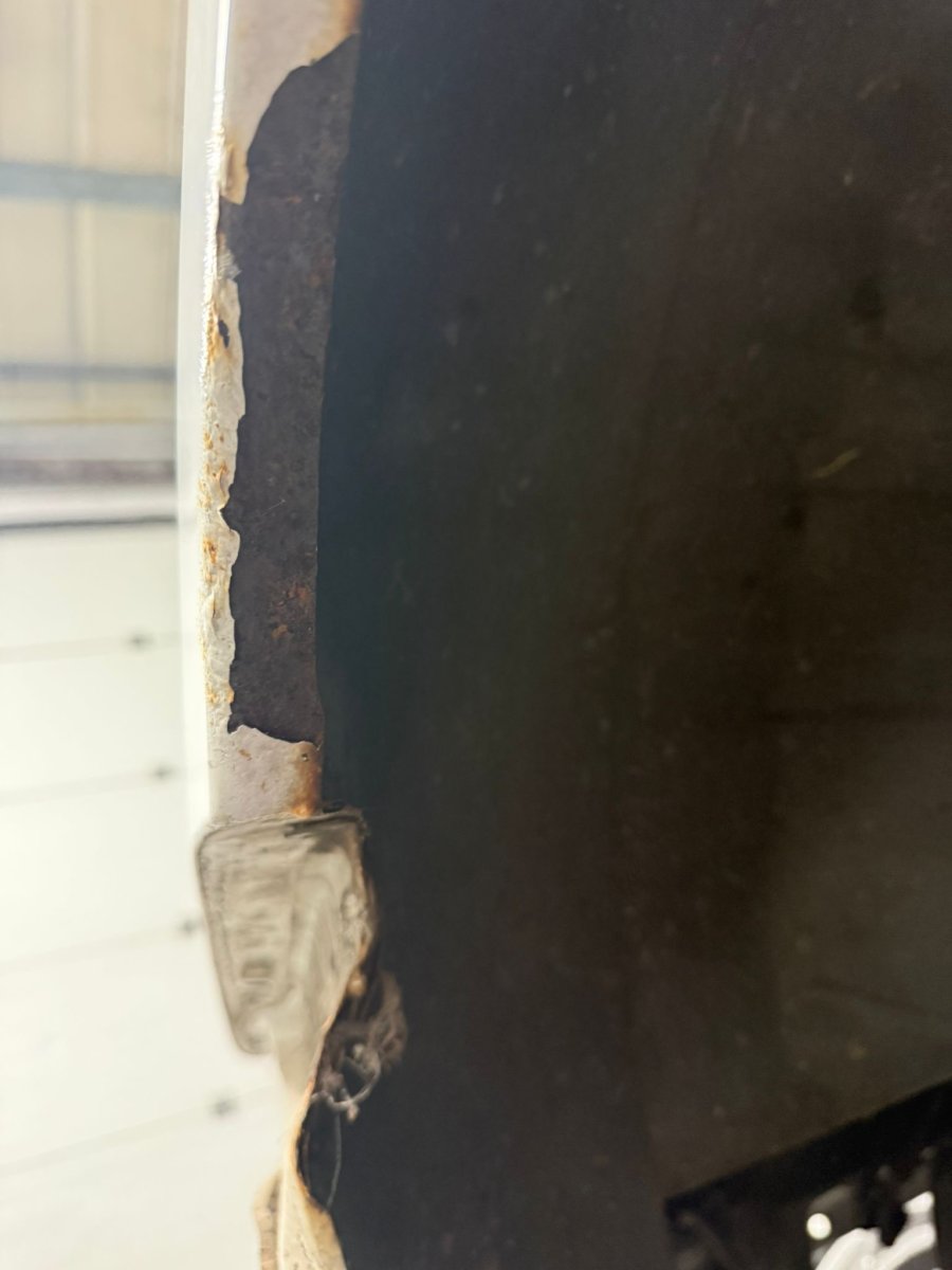

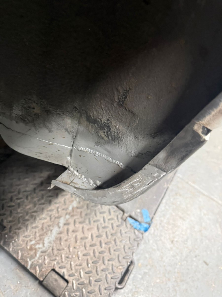

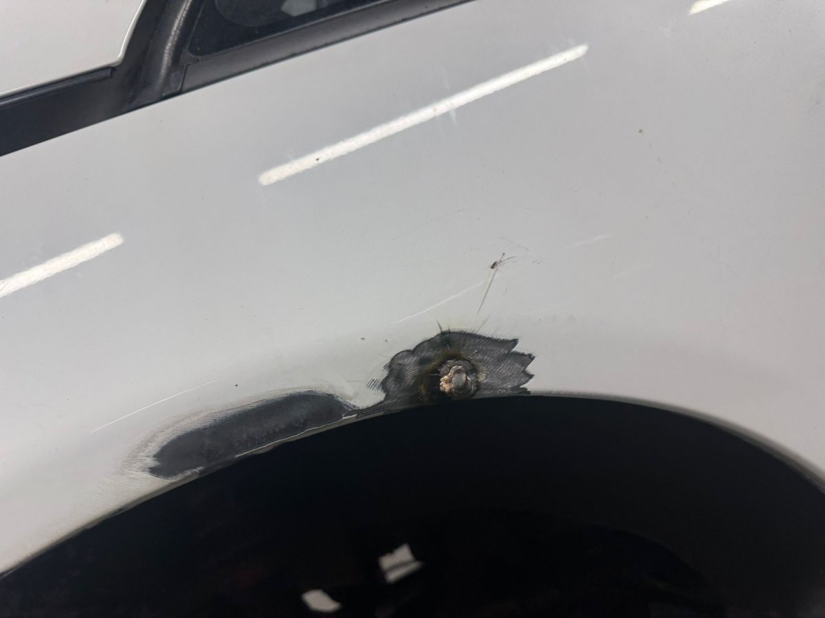

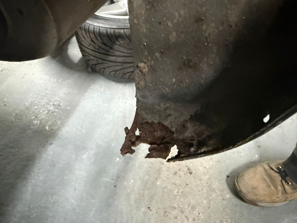

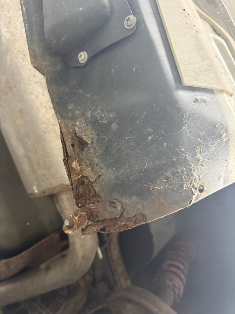

Some photos of the rust.
#1. 1993 Twin Turbo Manual LWB in black (2022 - 2024)
#2. 1991 Twin Turbo Manual LWB in white (UK) 2025 -

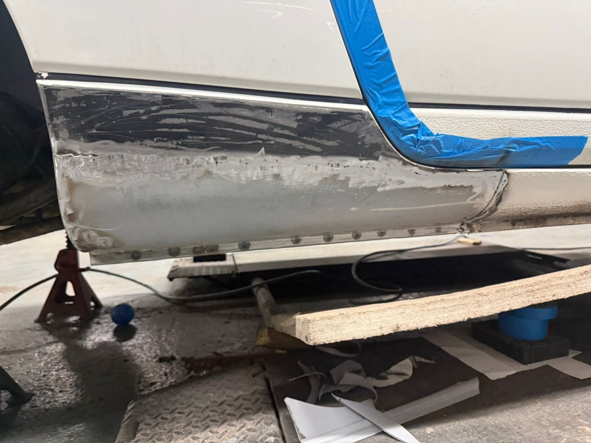

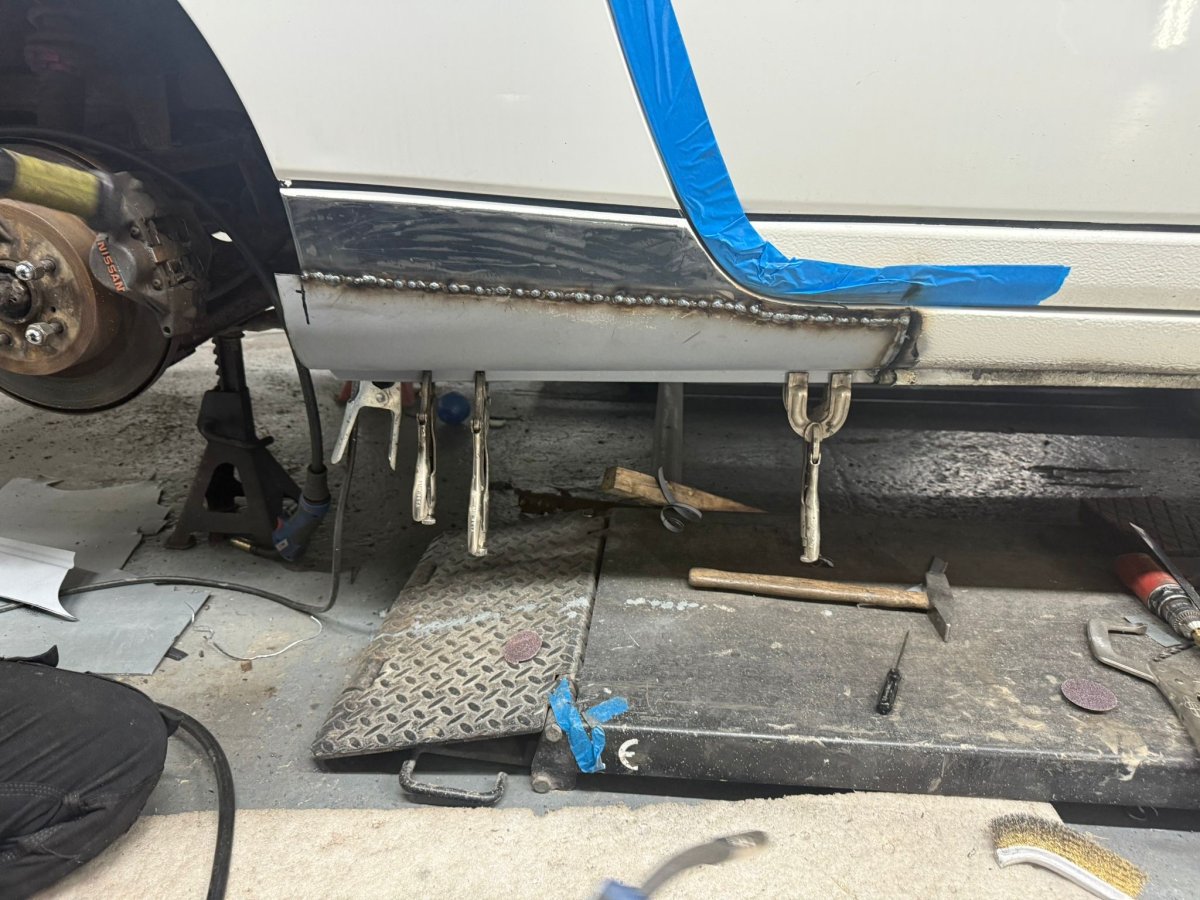

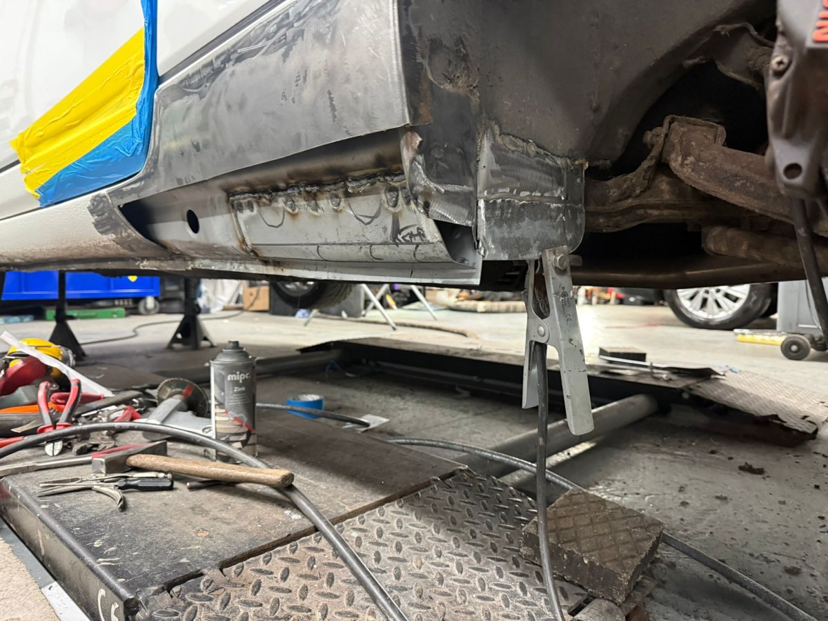

And the repairs! Can’t wait to see it all fixed and sprayed!
More repair photos

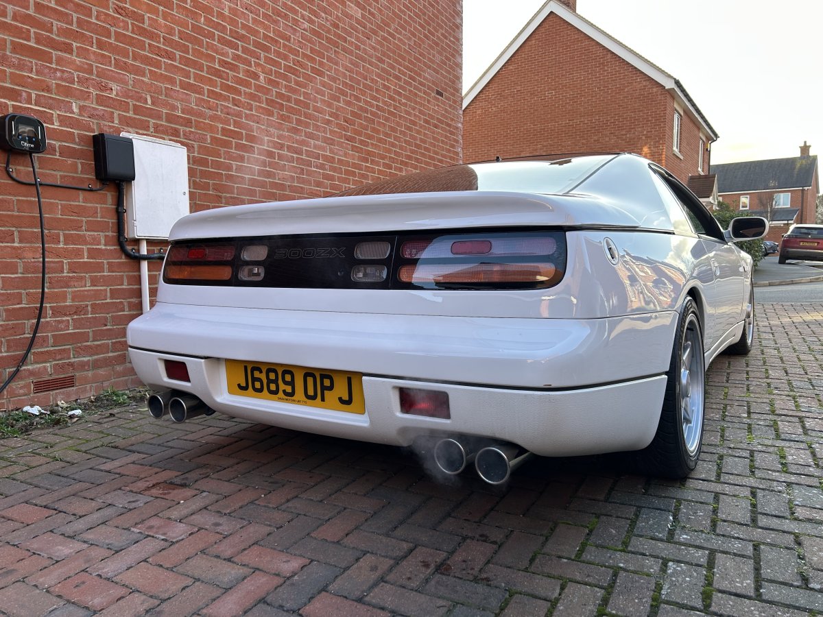

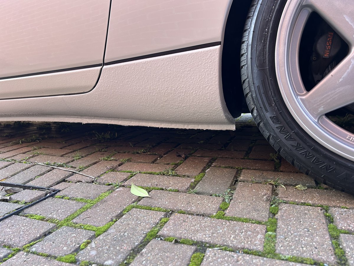

Back from the bodyshop today, looks great!

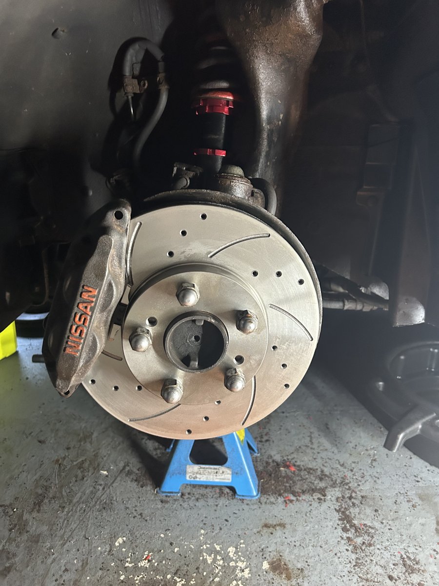

Next thing is to get it up on axle stands and replace the reverse switch so the lights work again. I’ll be doing new pads and discs on every corner and will be cleaning up the underside.
Ran nicely but a bit of smoke occasionally so will be trying to replace the PCV valves first and go from there.
Going to clean up the subframes as well. Then belt service, new spark plugs, filters, gearbox oil and diff oil.

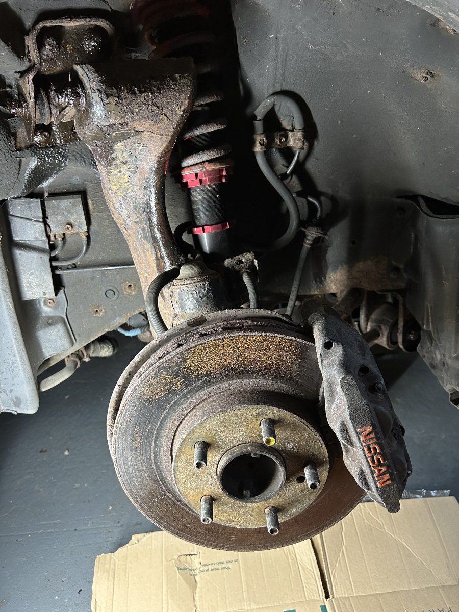

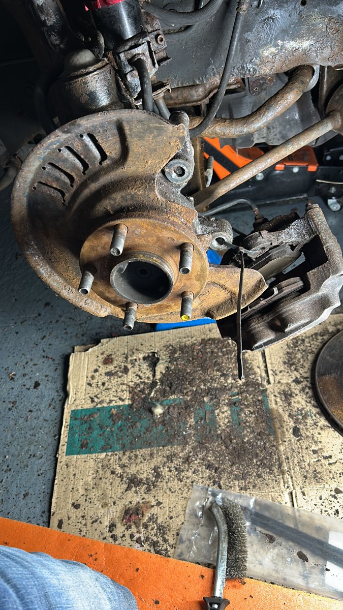

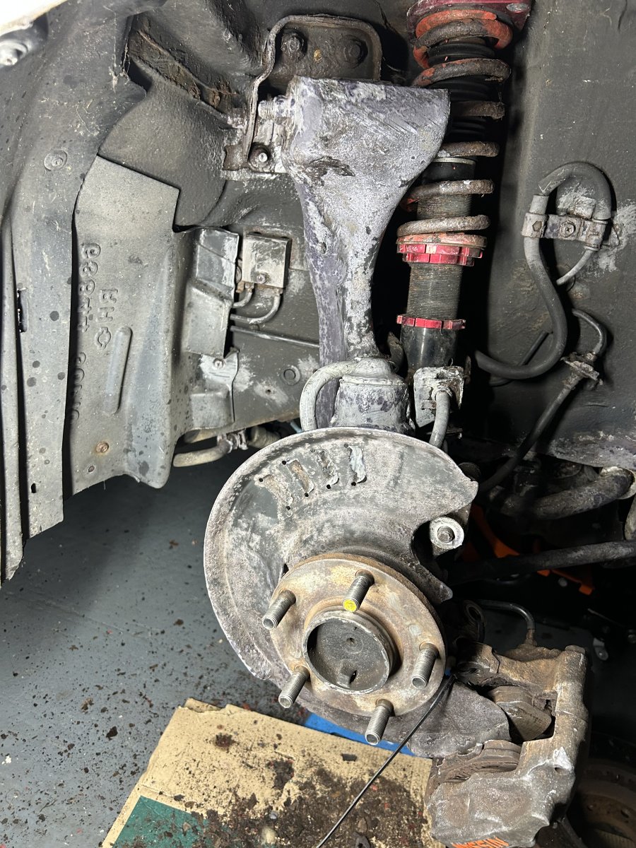

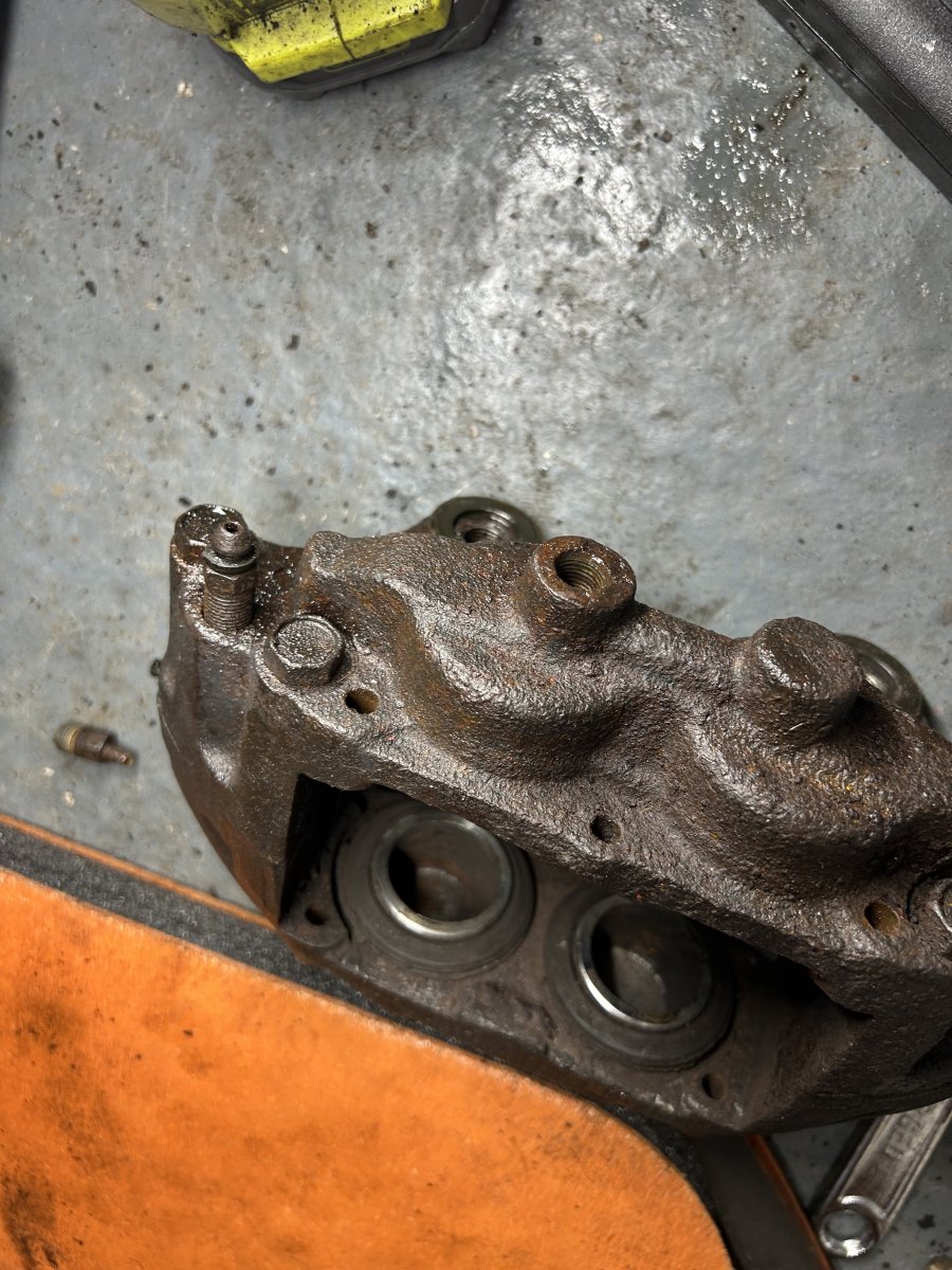

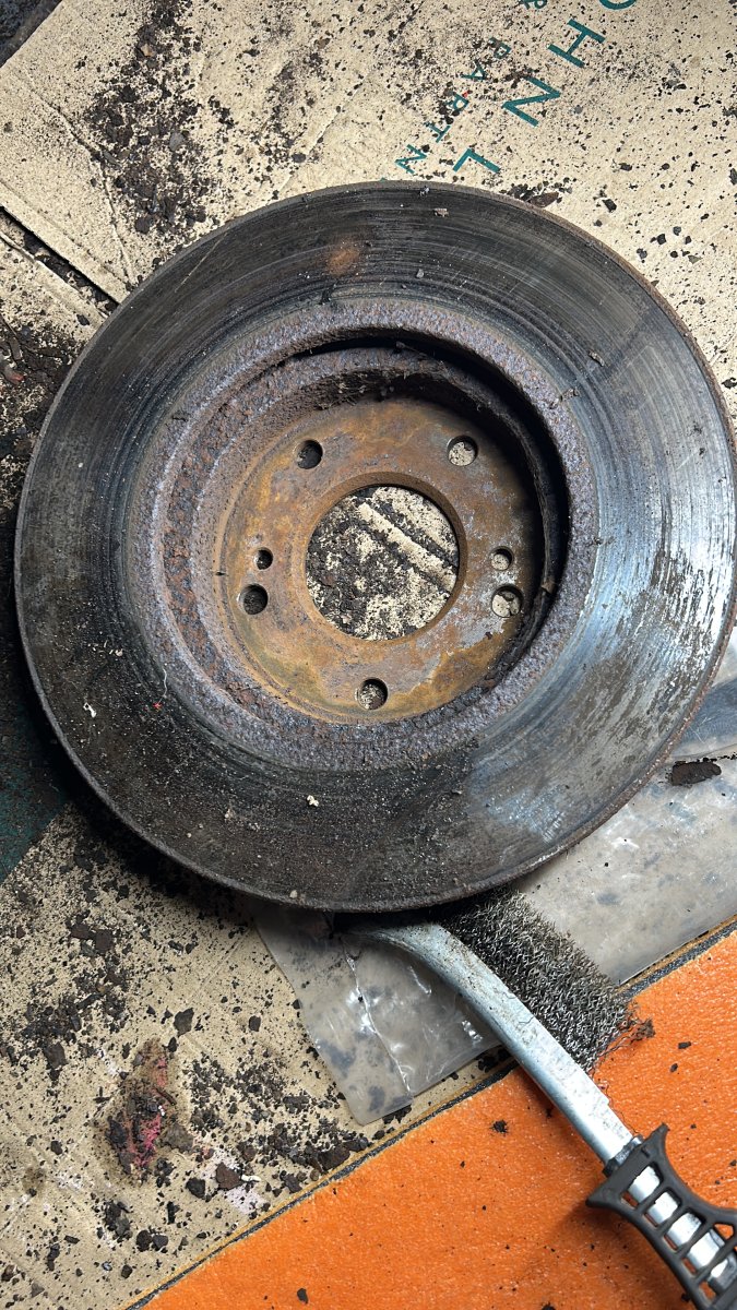

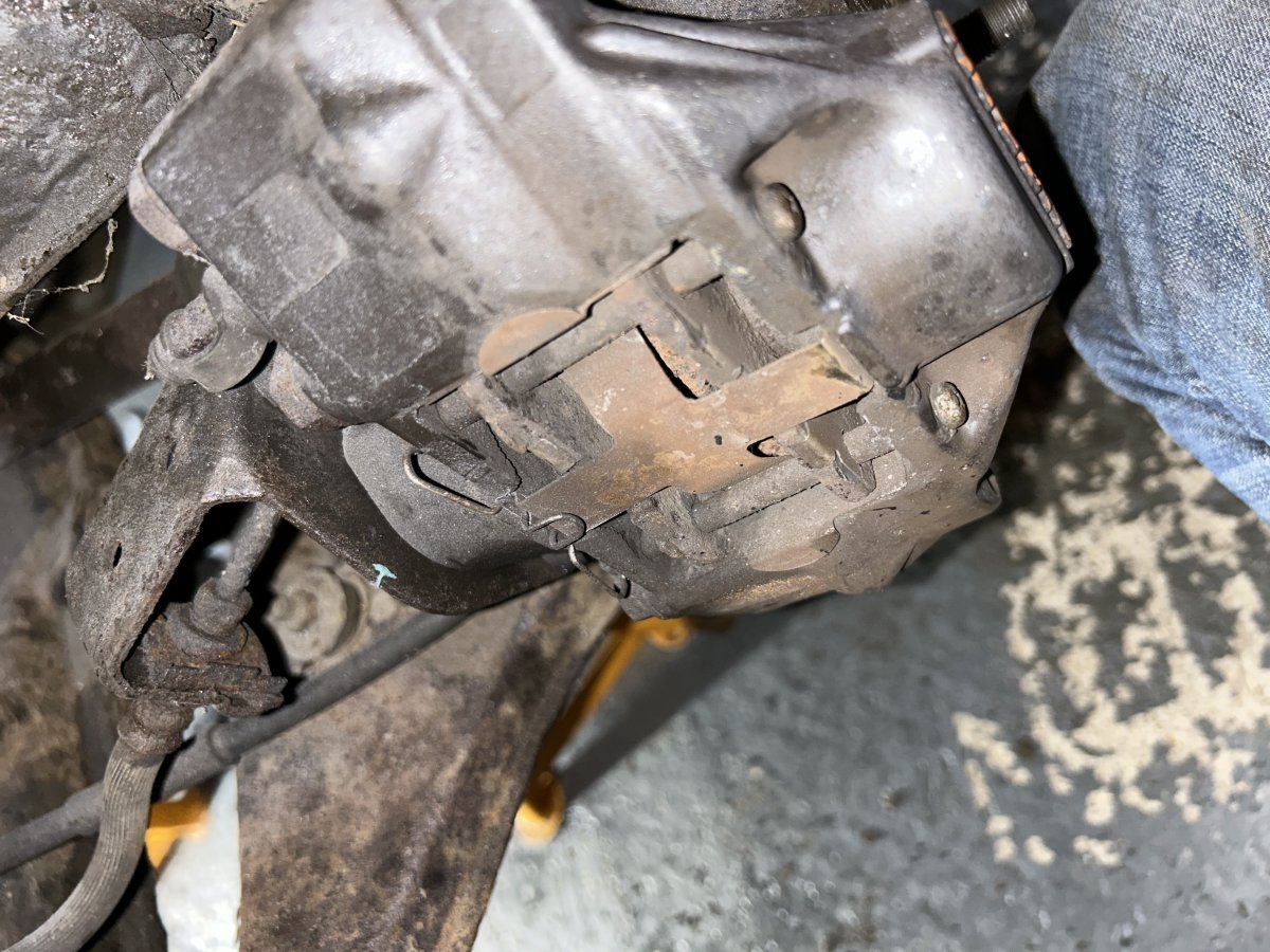

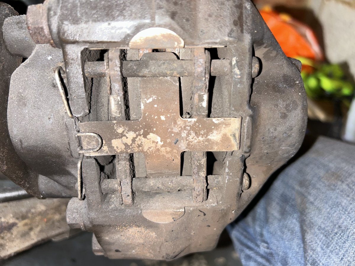

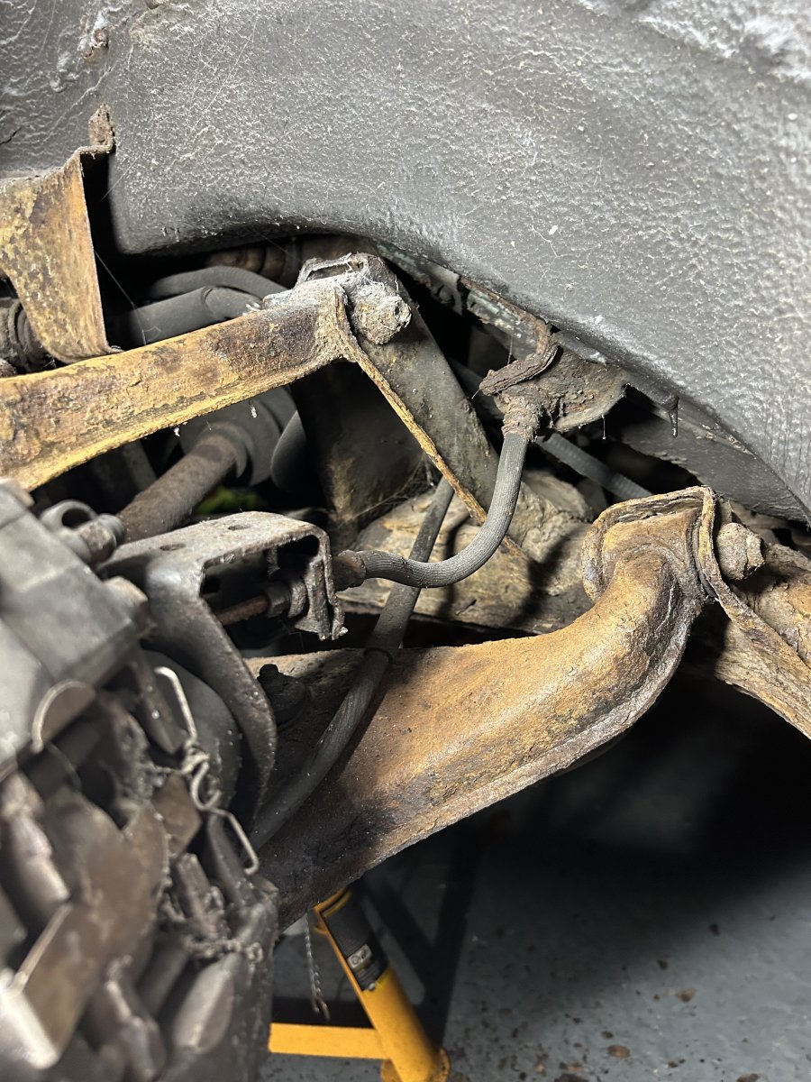

Made some progress today. Cars up in the air, wheels off and I’ve been cleaning up the suspension and steering components.
Wire brushed, used jenolite rust remover, then some rust neutraliser and then I’ll hammerite it.
I think at some point in the future I’ll get it all done properly but this’ll really clean it up and prevent any more rust (mostly)!
