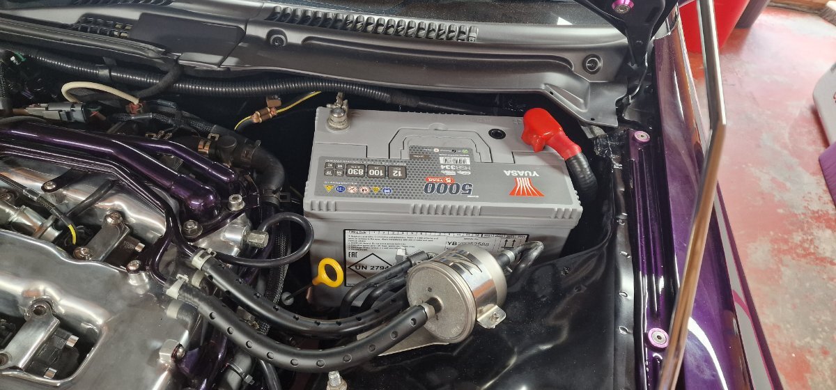

I bought a Yuasa 3000 series battery no. 030 (full part number YABYBX3030) from Allparts in March 2020 and it's still going strong. Cost me £104, so I can recommend that!
It fills the battery compartment perfectly and the terminals are the right way round too 🙂
This looks like the one.....
Yuasa YBX3030 - 3030 SMF Car Battery - 4 Year Warranty | eBay

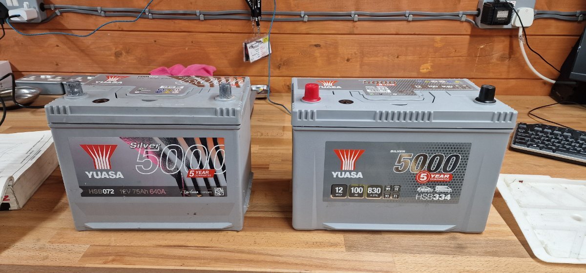

All the other 300zx parts listings have the terminals round the wrong way...... Live should be on the driver's side, when the terminals are nearest the bulk head, not nearest the front of the car 😉

Before you order one, I'll double check in my garage tomorrow, when I leave for work and drop you a text to confirm!
Nice work Lee - I was going to say, whatever listing Yuasa (or all the other manufacturers) have for the 300zx is often wrong..... As they come with the terminals reversed. they might not fit most Zeds, but they will fit yours 😄
