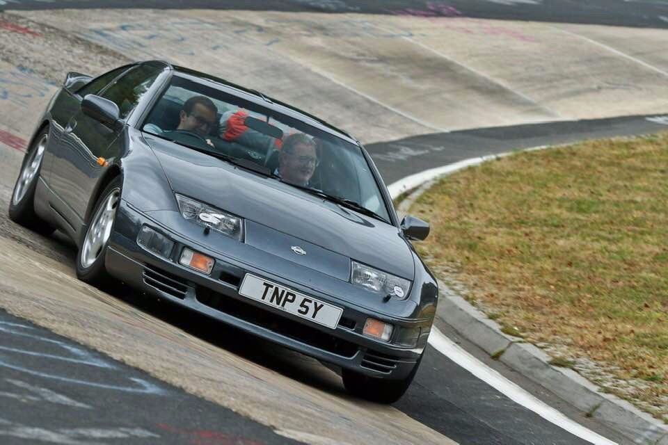

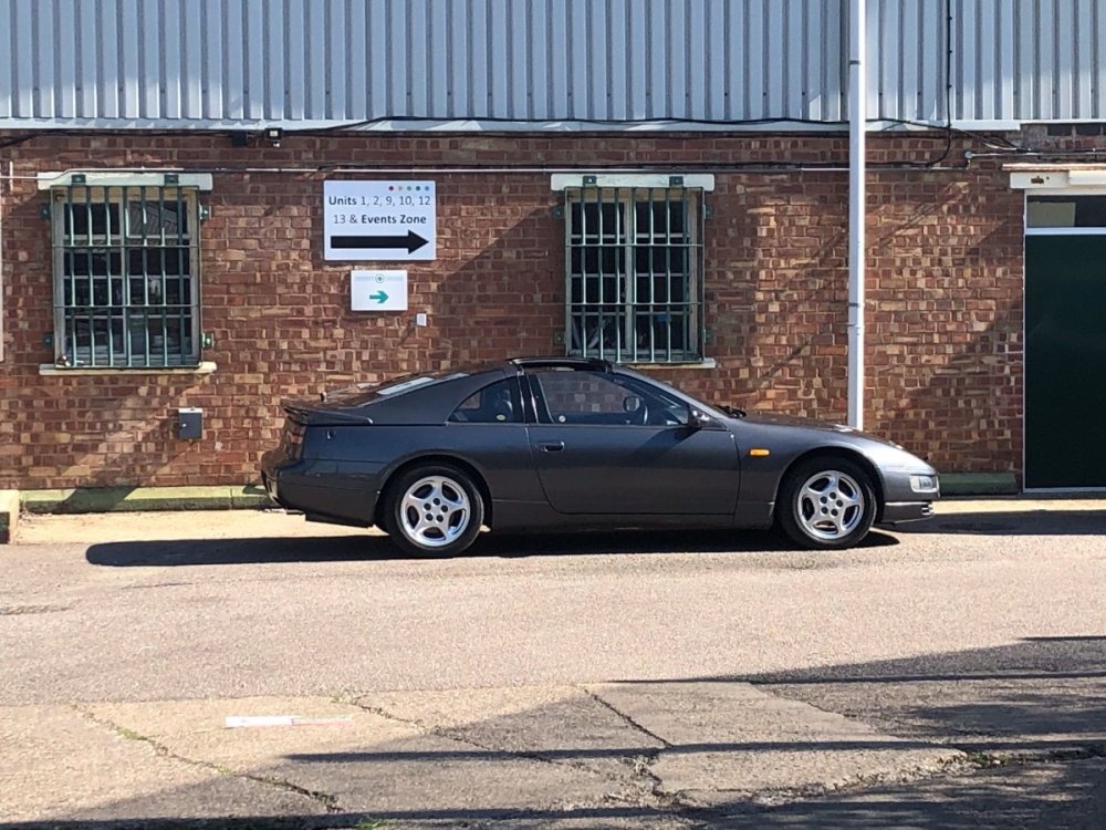

Thanks you, I have forwarded the 94 version for the Heater and A/C to my electrician and fingers crossed it provides the info he needs. Few photos of my car attached
