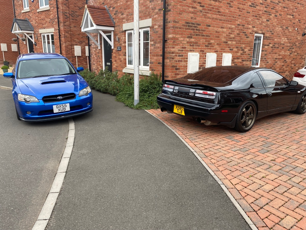

Nice legacy. My daily is a Facelift 3.0R Spec B 6speed.
