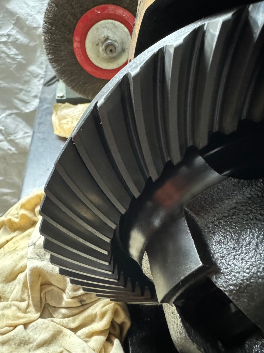

Hi not been able to do much last few months but got my petrol tank back from being powder coated.
Diff looks good I’m only going to replace the drive oil seals + new fill, drain plugs & vent pipe.
IMG_5840.jpeg.186d277abdd0cef269bdcea14ea77785.jpegIMG_5841.jpeg.69cbb2893d0ddf2c51fee2dcf5ac3fc1.jpegIMG_5849.jpeg.837ccb68e2701760cf64954c6965cbcc.jpeg

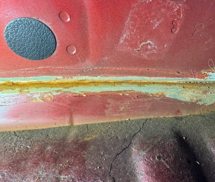

I managed to get the drivers seat out and carpet up a bit to see where the floor meets the sill,
It was not as bad as I expected.
Section by door hinge.

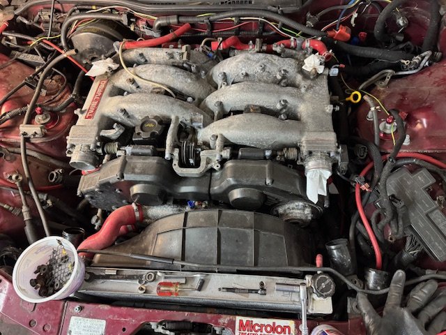

This Easter I have been stripping the front end I’m hoping to drop the engine, gearbox and suspension out from underneath. Then I’m planning on buying a rotisserie to make things easier to work on the underneath.

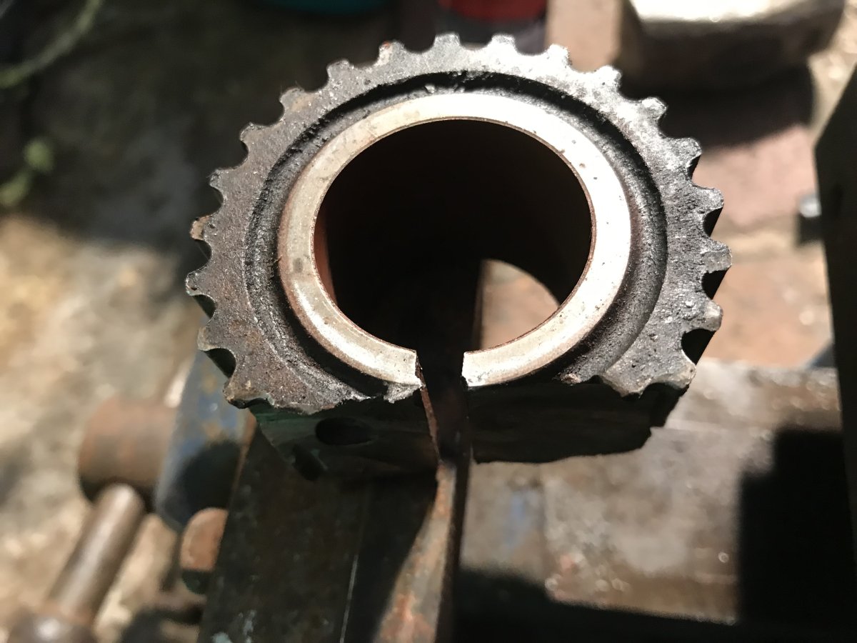

I learnt a hard lesson lesson last time I took the engine out, the crankshaft cog was seized and had to be cut off, but before that I tried to pry it off and a hairline crack was made in the oil pump, this was only found once the engine was put back In and started, so be very carefully cut it rather than pry it off, I put some copper slip on the shaft and this time it slid off with very little pressure.

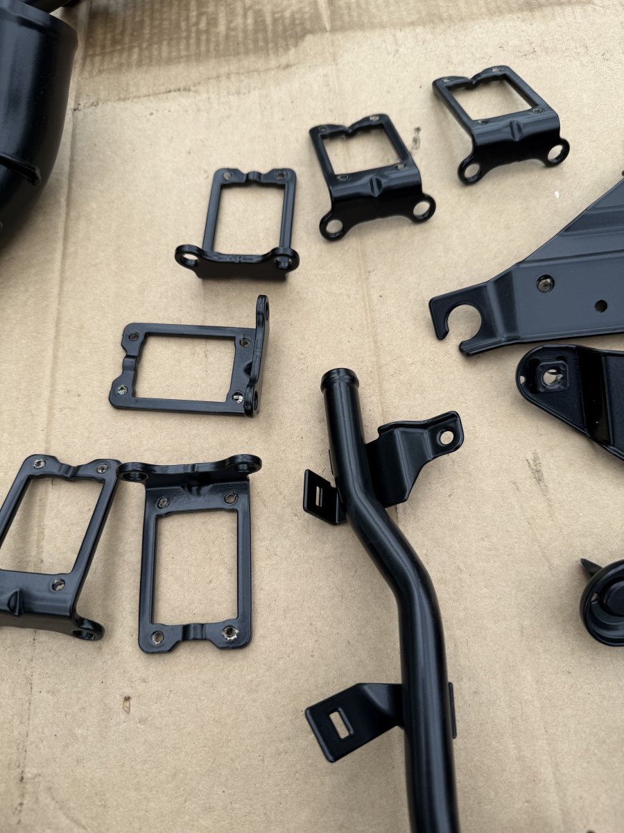

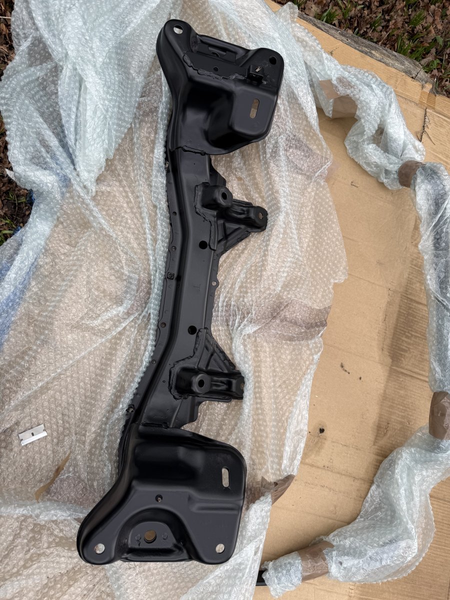

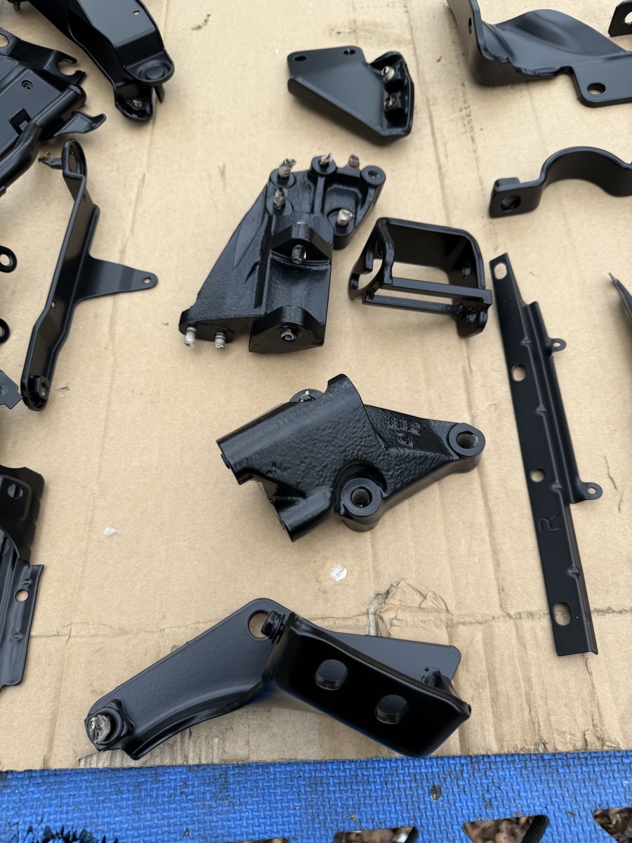

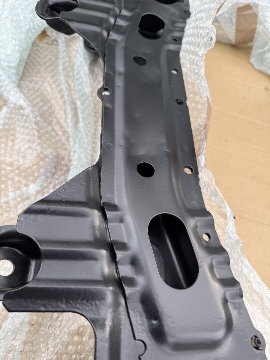

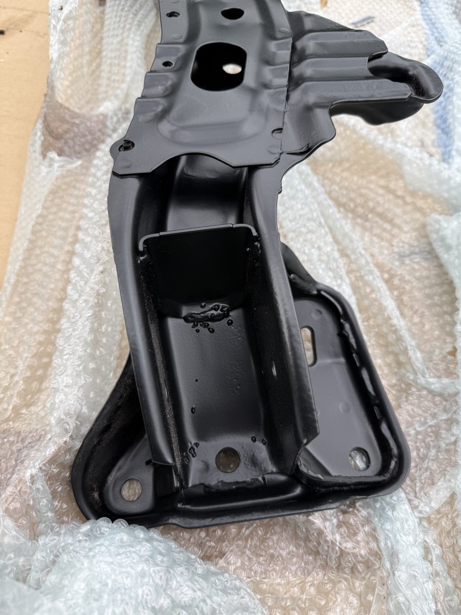

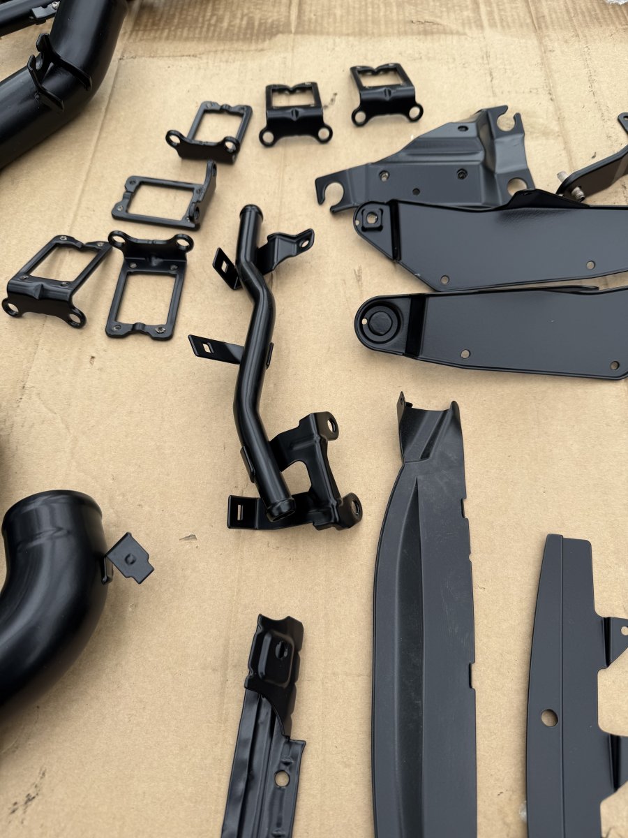

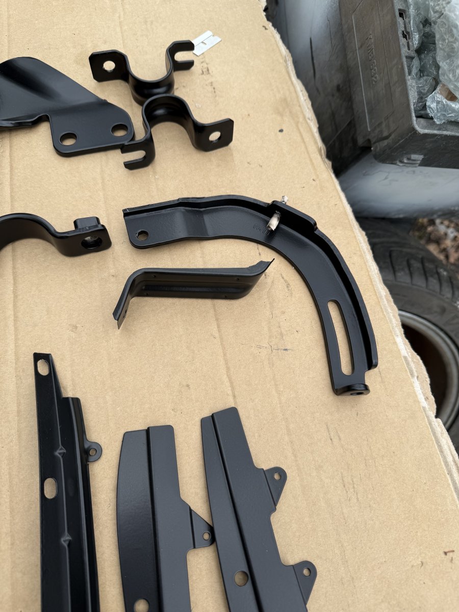

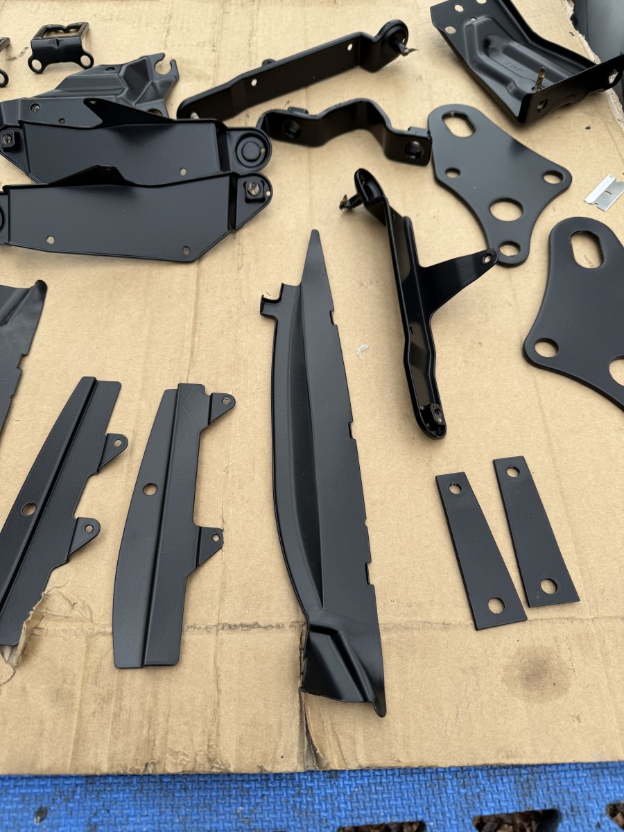

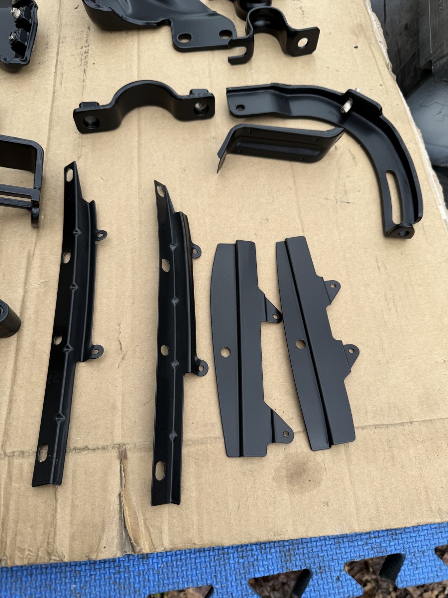

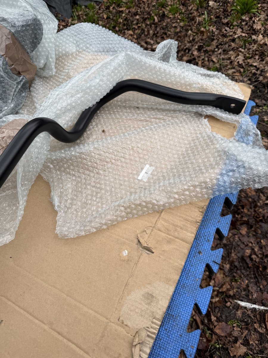

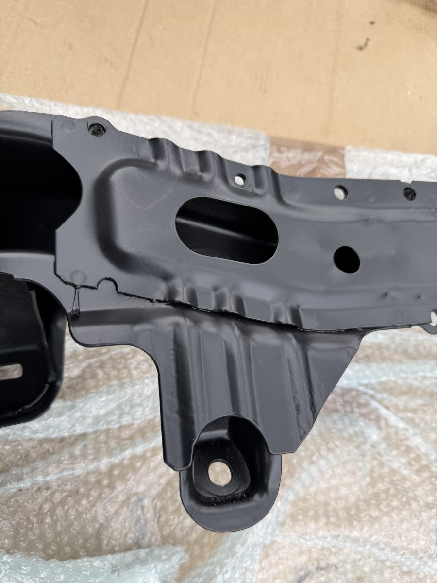

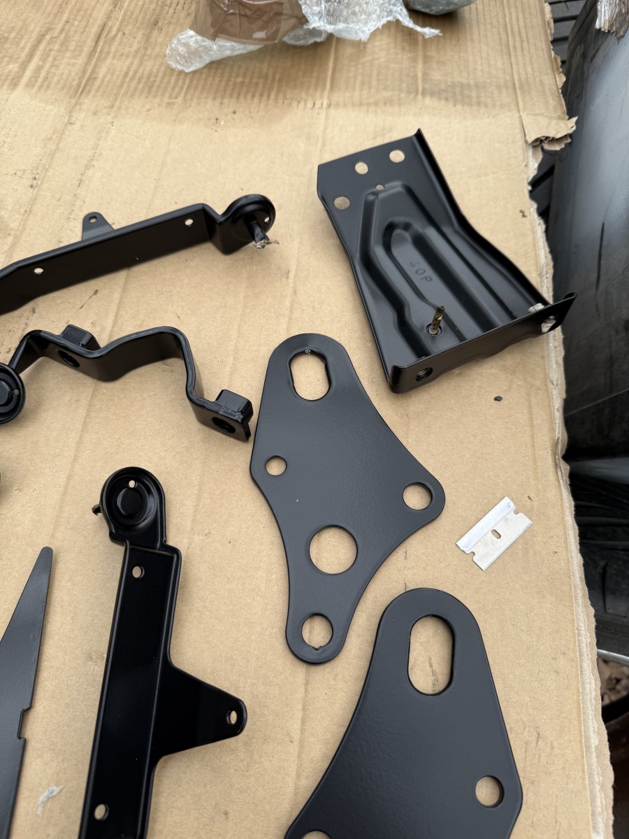

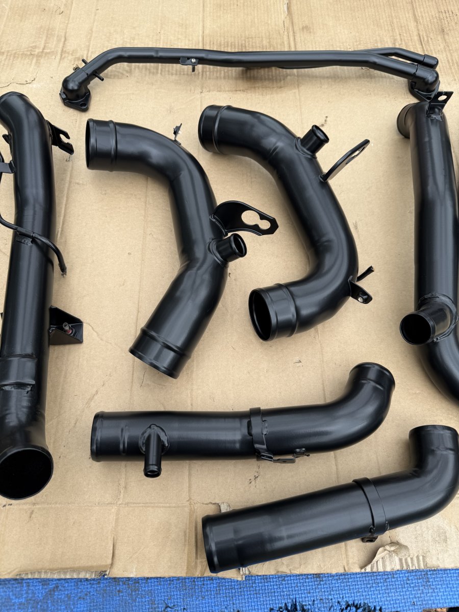

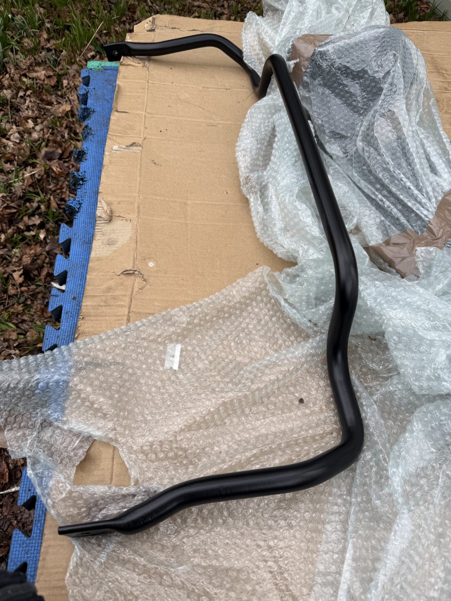

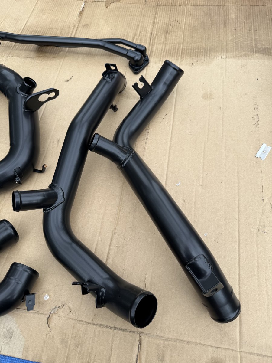

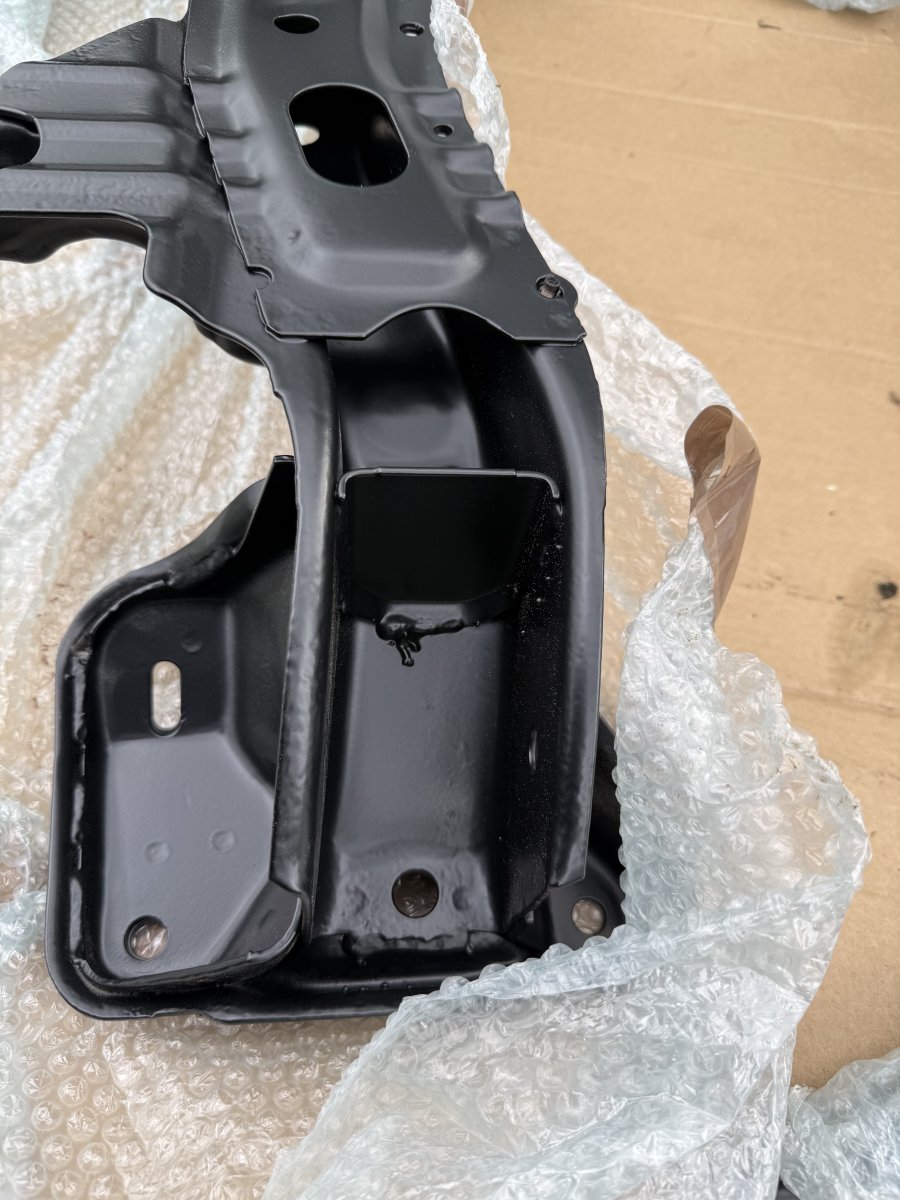

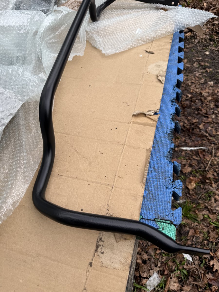

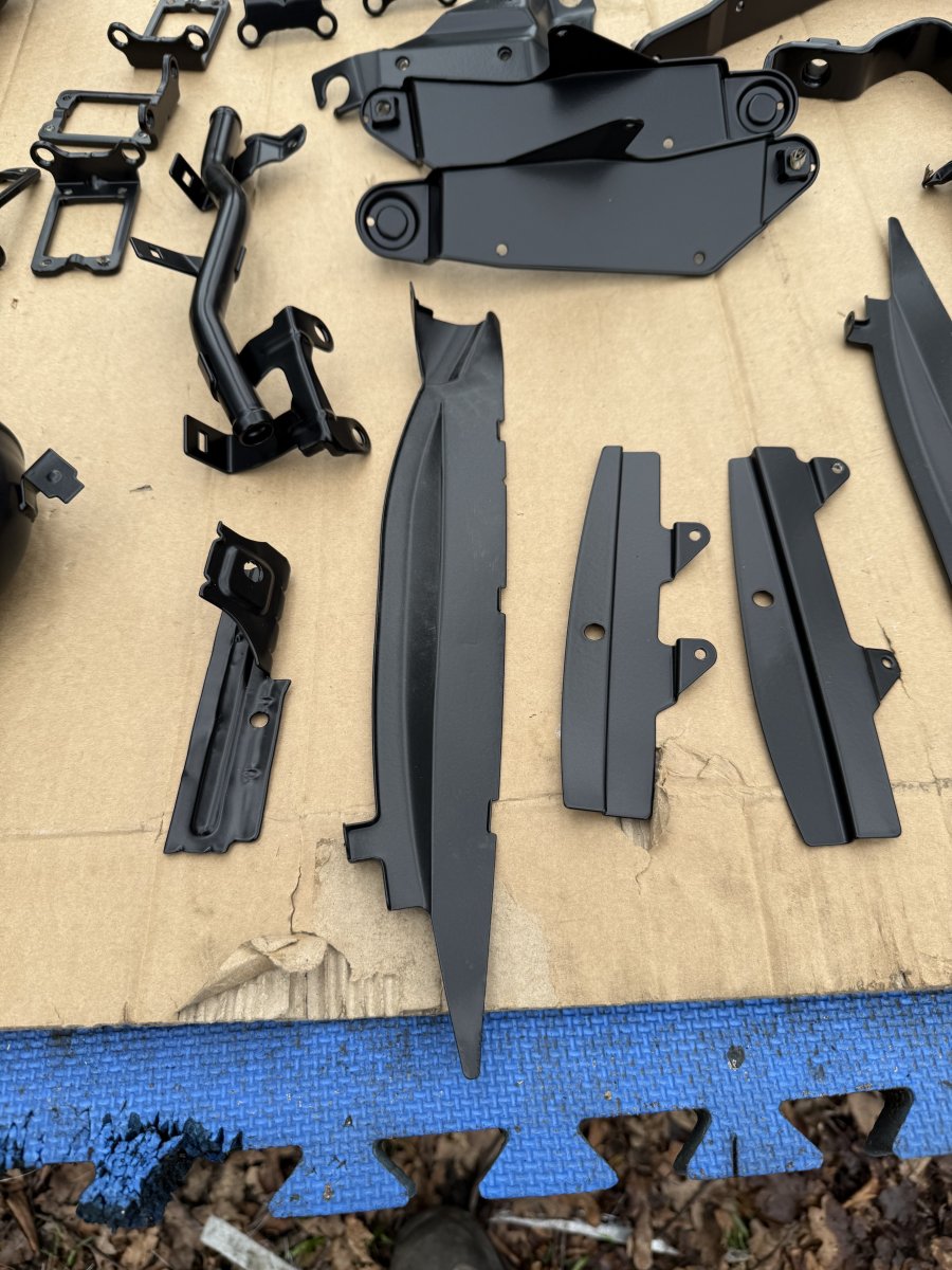

Parts freshly back from powder coating
IMG_1224.jpegIMG_1225.jpegIMG_1226.jpegIMG_1227.jpegIMG_1228.jpegIMG_1229.jpegIMG_1230.jpegIMG_1231.jpegIMG_1232.jpegIMG_1233.jpeg

IMG_1236.jpegIMG_1237.jpegIMG_1238.jpegIMG_1240.jpegIMG_1241.jpegIMG_1243.jpegIMG_1242.jpegIMG_1234.jpegIMG_1235.jpeg
