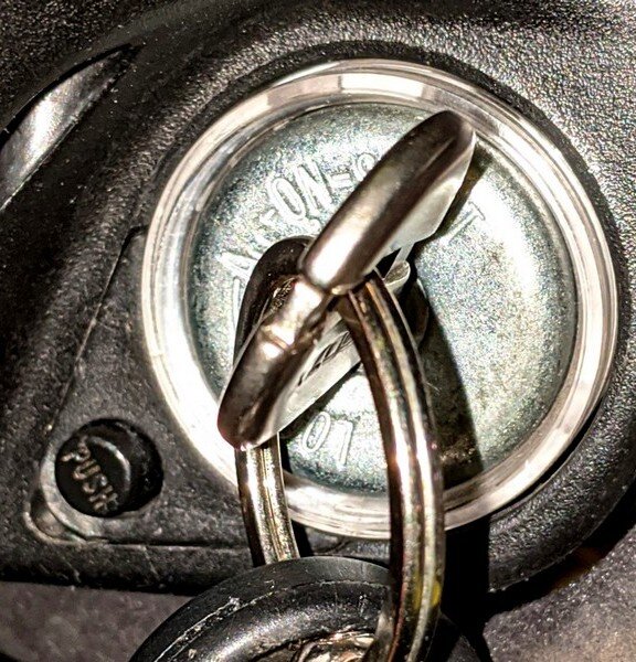

Discovered today that the ignition barrel on the Zed is goosed. Key can be removed at any position etc.
CZP sell a JDM one, but states for Manual only. My car is an ex auto, converted to a manual a number of years ago. I don't know how the conversion is done, so wondering if the manual lock barrel would work?
Ah so that's what it's for. Right. I should have just googled that. Lol.
Time to strip out the cowlings and see if the design looks the same as the CZP one.
Although I could always see if anyone is selling a full lock set from a breaker.
My Slicktop was a converted manual. So I assumed the push to release button was just standard as it's what I was used to. Lol. Oops.
my JDM manual has the push button to release the key, but mine was manual from new. I had a uk car that I think was manual from new and that didn't have the push button.

All my zeds have had the key push release. I was told its a anti-hijacking feature (along with the seatbelts in the doors) that the japanese like to have
