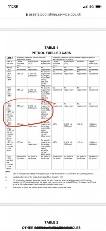

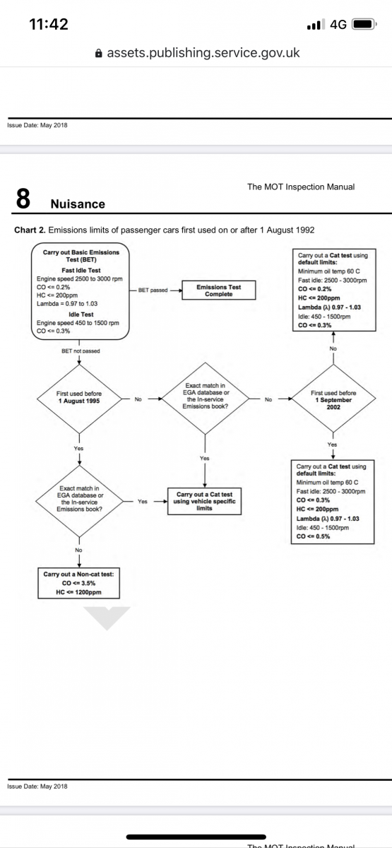

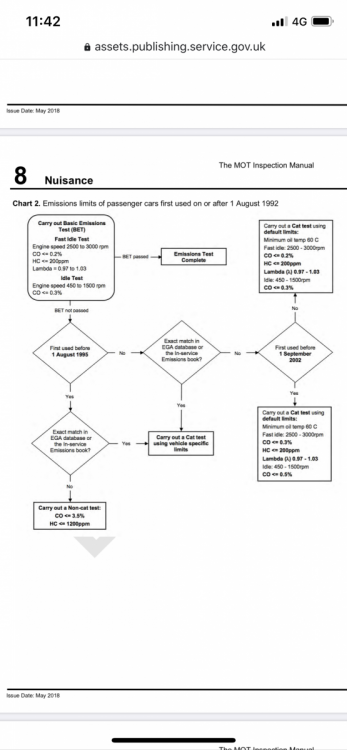

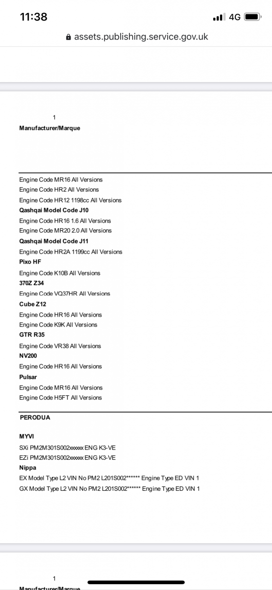

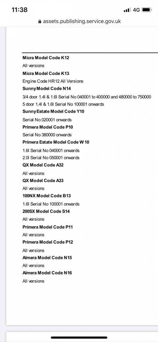

You can extend your search to anything first used before Aug 1995 because the 300ZX does not appear in the EGA database for emissions details. Refer attached screenshots from the current testing requirements [emoji106]

Adding screenshots from current testing manual

38 minutes ago, Joely P said:
You can extend your search to anything first used before Aug 1995 because the 300ZX does not appear in the EGA database for emissions details. Refer attached screenshots from the current testing requirements emoji106.png
Thanks joely very useful information, you just made the search so much better ??
But if you do buy a later car, always bring those sheets to the MOT centre as they never know what needs to be done!
