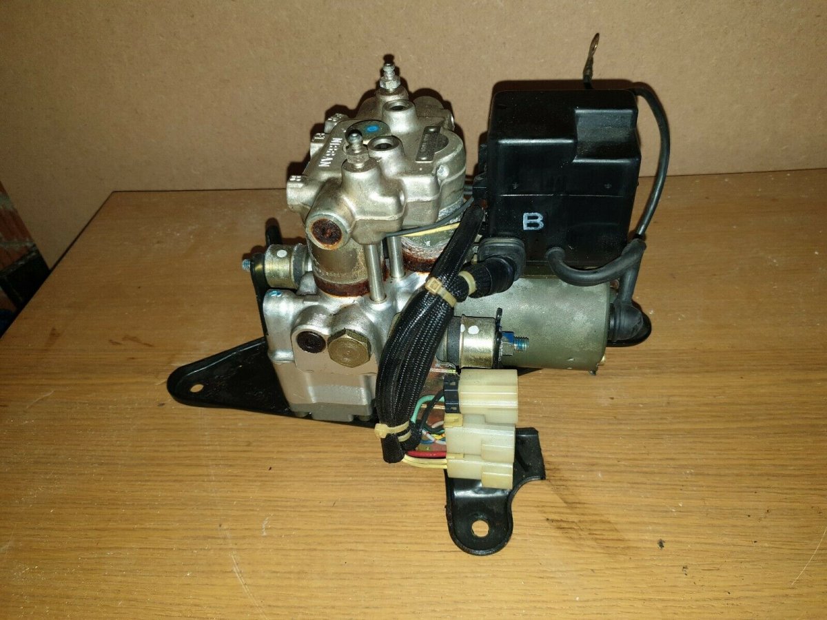

That's what I thought it was last year - and then I got a replacement one, had it fitted, but still the noise persisted.... Granted, the replacement could be goosed as well but my local mechanic and I thought it unlikely. Thanks for the offer Dave; I do have another  - and swapping them out should not be too difficult.
Assuming you and me are both referring to this part.....
