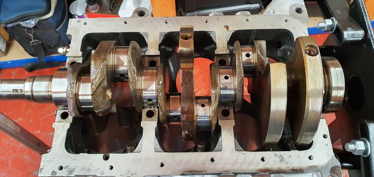

Do i need a new crank ?

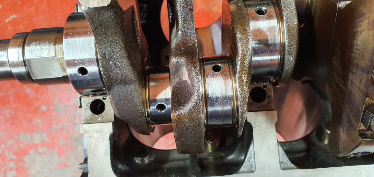

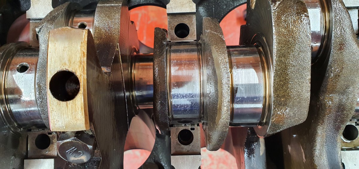

So when i dismantled the bottom end a few months ago i mistakenly left the crank exposed.
Over the last few months its gained some surface oxidisation which easy came off with a cloth and wd40.
Will i need to replace this or get is professionally polished again ?
There is no pitting or scratches that i can feel although you can see discolouration in a few areas.
Hi Lee,The crank is very hard and i would be amazed if the corrosion has bitten in yet.Grab a roll of 180 grit emery and polish it at home then coat it with oil to stop it rusting again.
1 hour ago, JaiKai said:
wouldn't think so as its just a polish to the areas that come into contact with the bearings
Not enough material would come off in my opinion.
I'm with Jimmer too - and also agree with you regarding no need to balance it. Just a mild polish, to smooth the bearing surfaces, no material would be removed at all.
