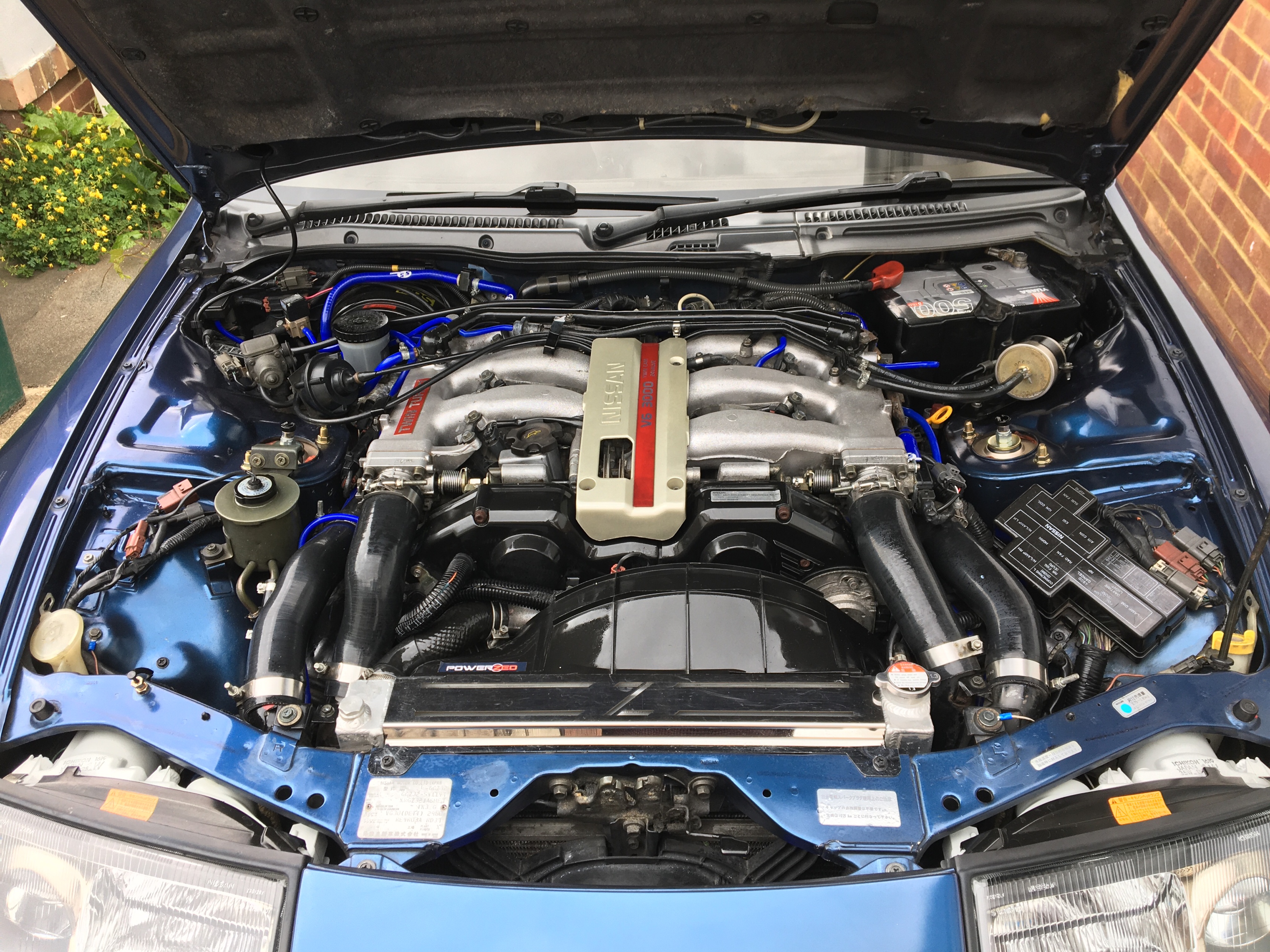

  • Finished putting the engine bay back together this morning and got out on the road. Went straight to Shell and filled up with V power and pumped tyres up. Bought one of those fancy Ctek battery charge

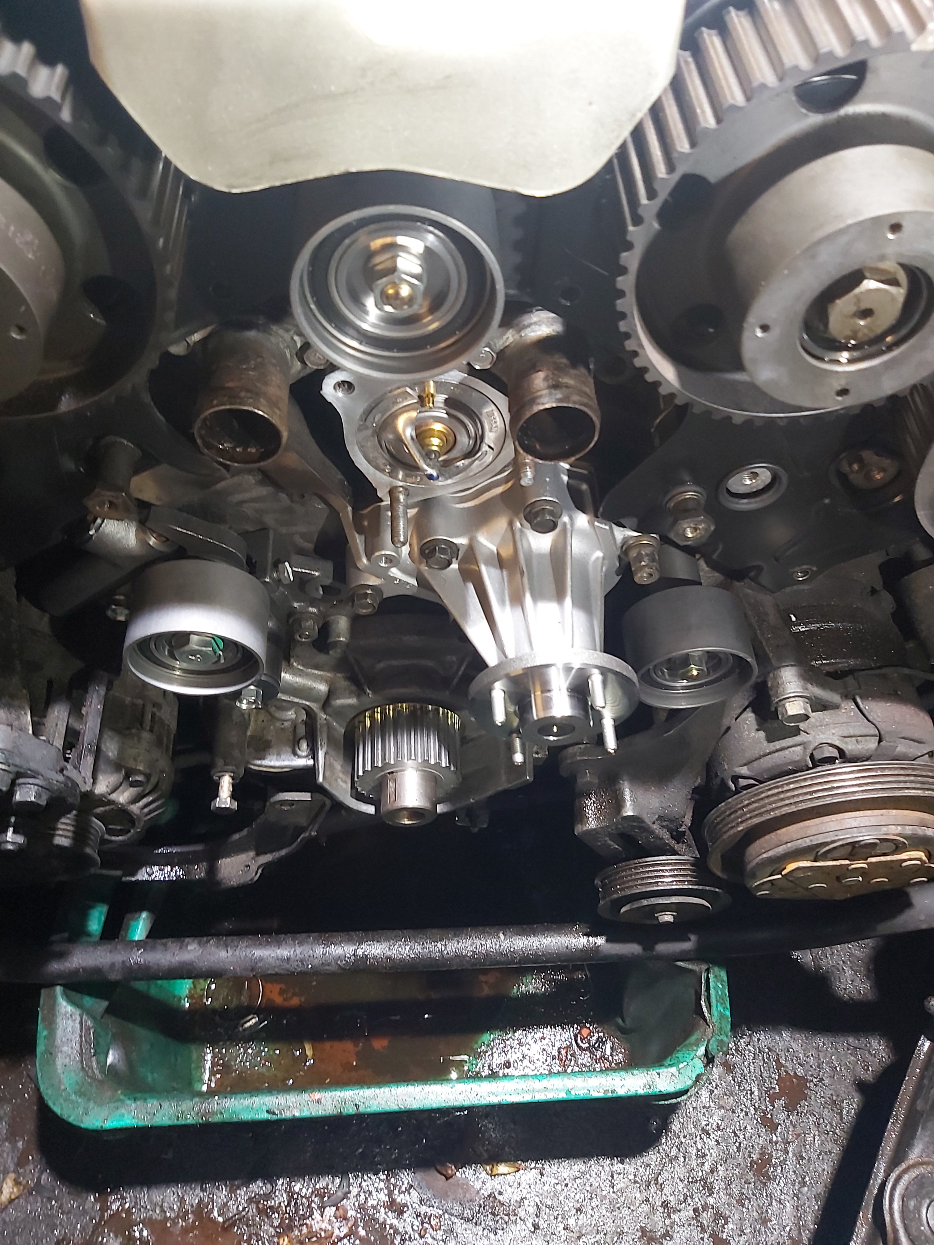

I’ve received part of the 120k service package - I didn’t realise CZP have the timing belt and water pump on back order when they dispatched rest of the order, so just waiting for that to come in. With the order, I got some new bolts for the engine bay to replace rusty ones - pics will be posted over the next week once I’ve cleaned the engine again.

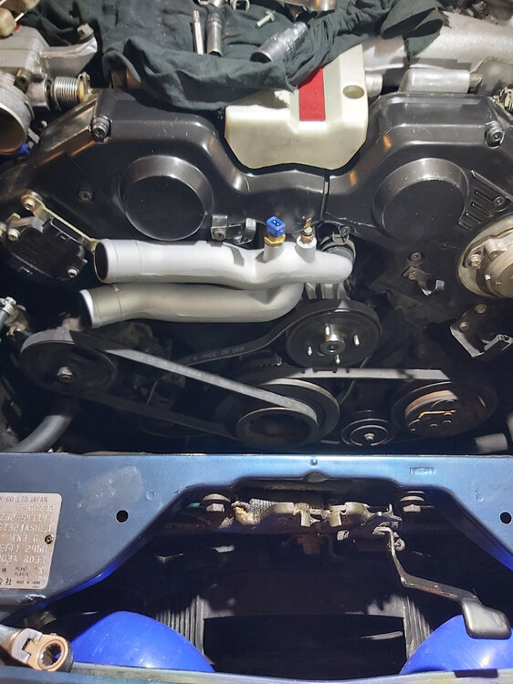

Received my full order from CZP now for the 120k service kit, ancillary belts, a power steering return silicone hose and some engine bay bolts to replace rusty items.

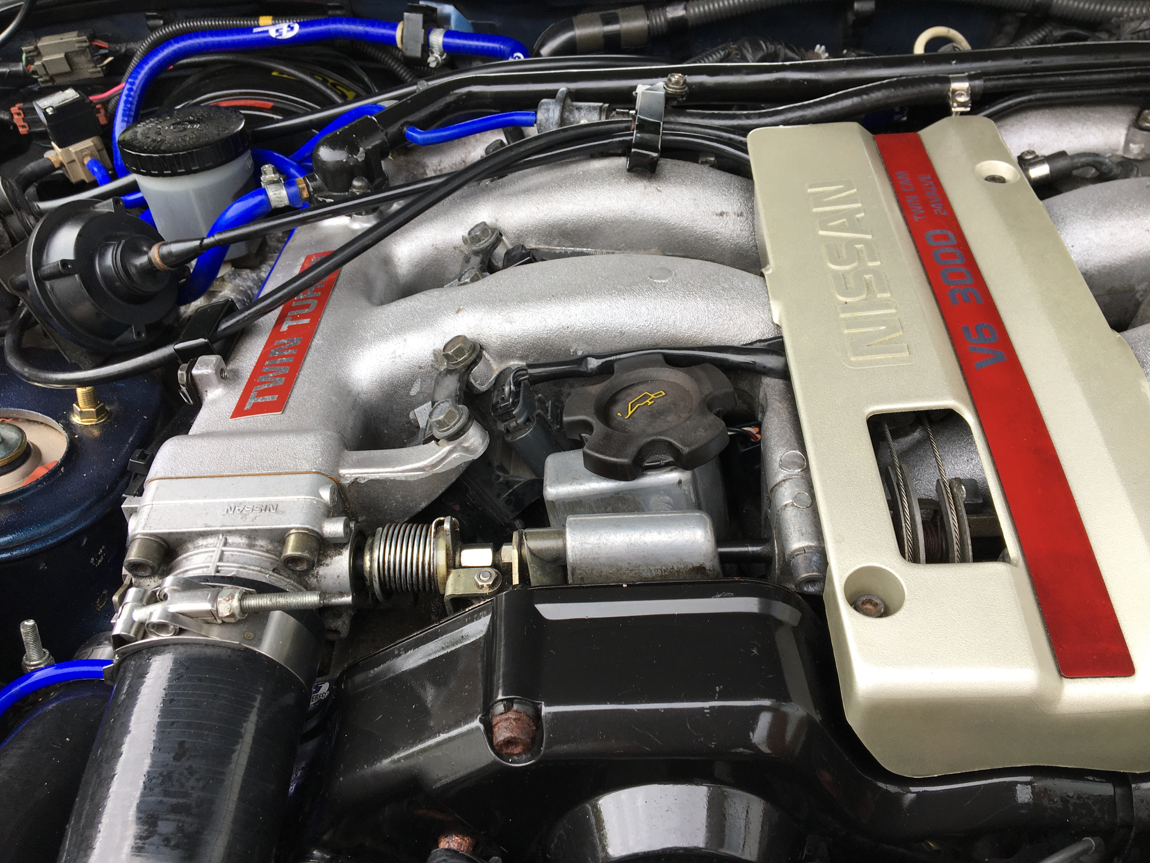

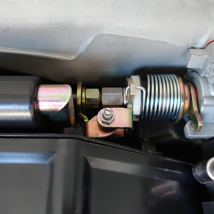

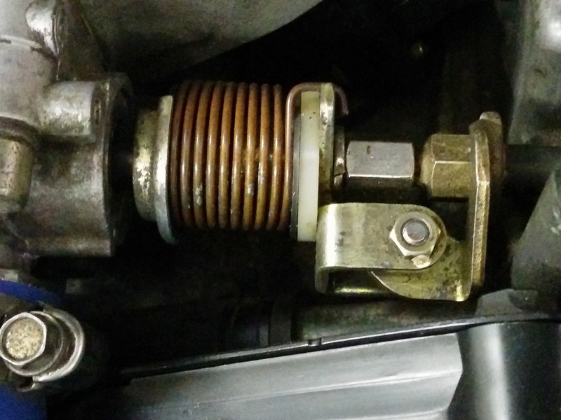

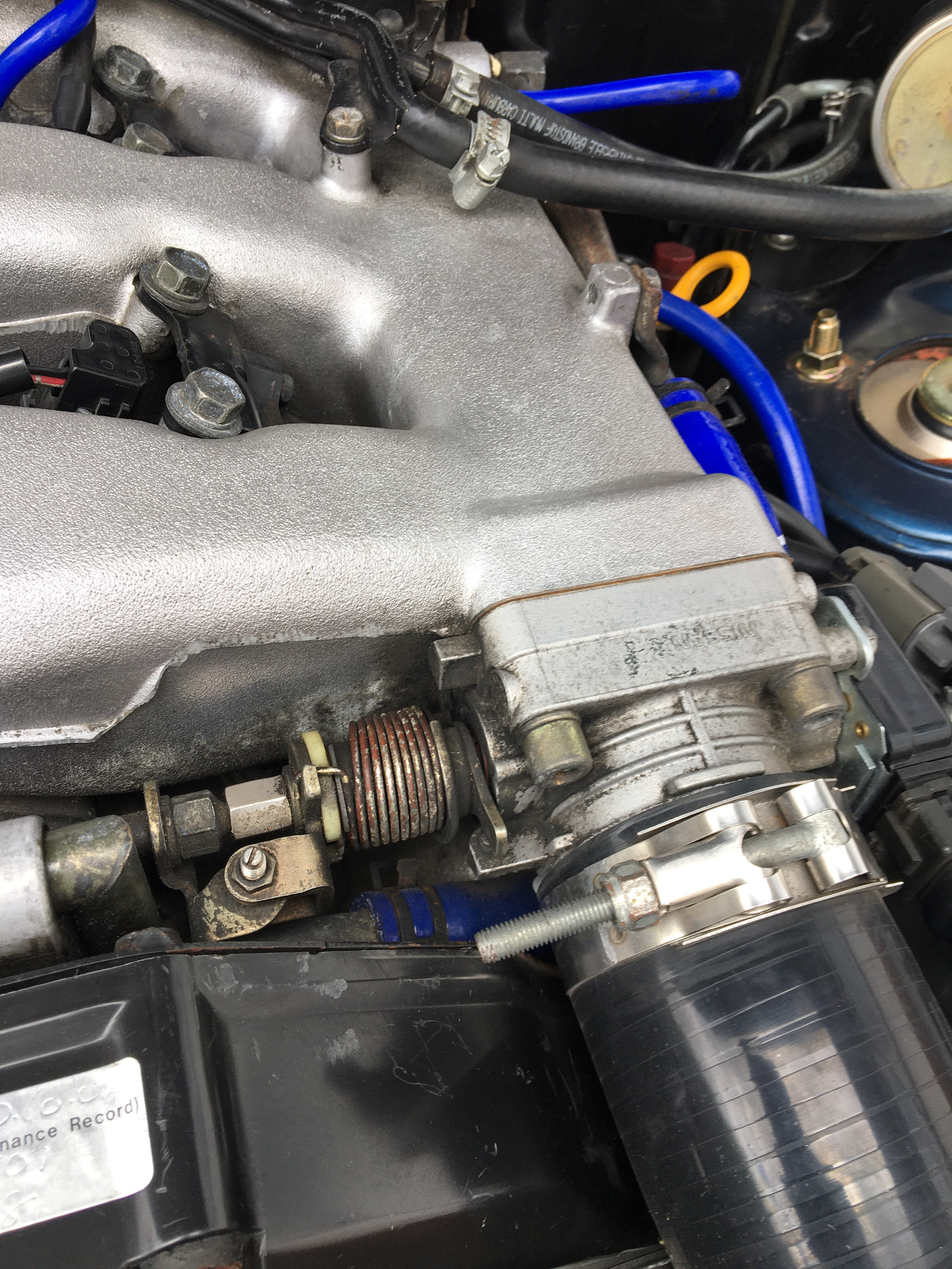

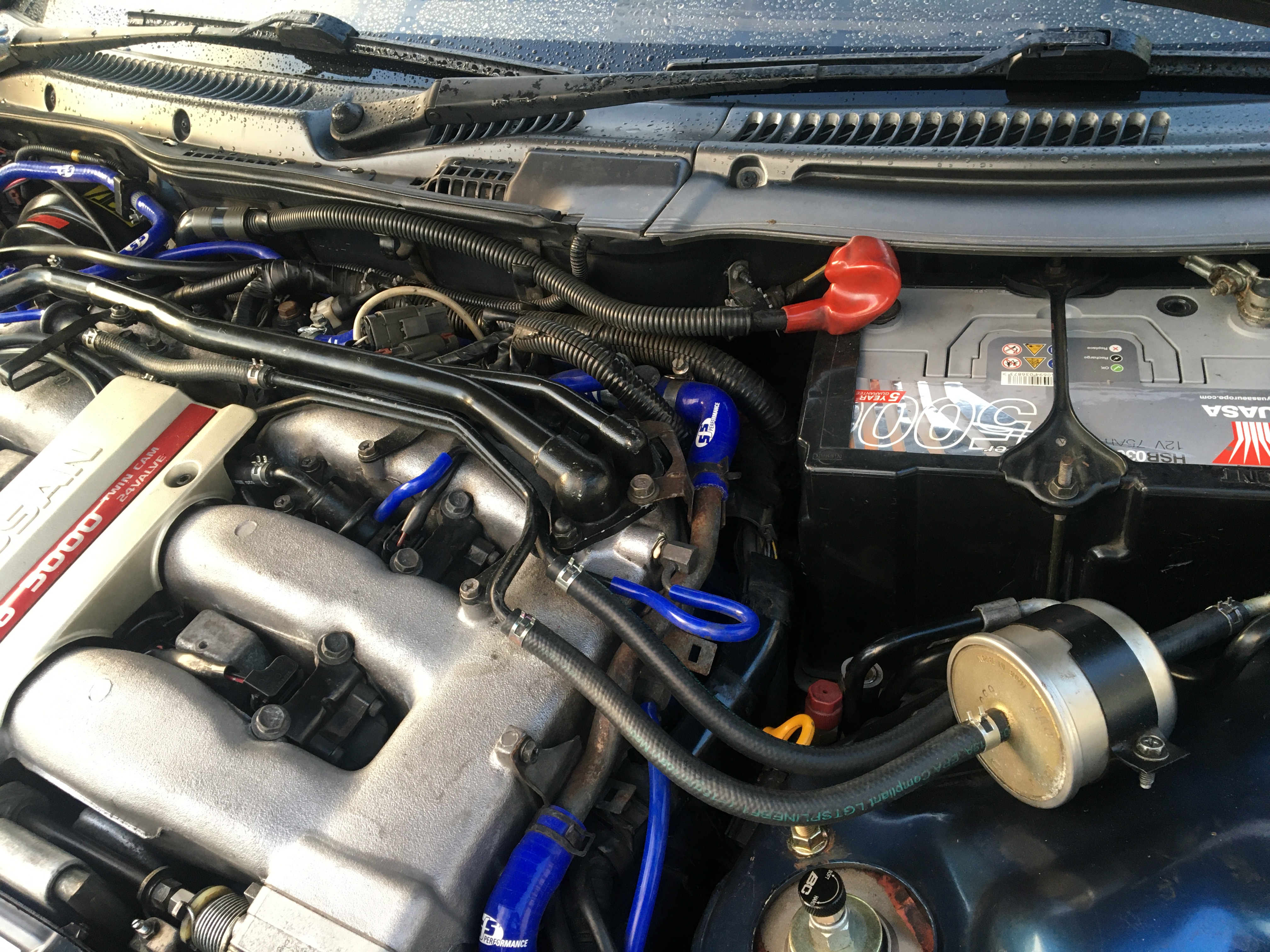

Gave the engine bay a good clean yesterday. The throttle linkage springs had surface rust all over them. I thought they would need replacing but Joelyp advised they could just be scrubbed clean and covered with an engine heat proof clear coat paint, so that’s exactly what I did. It looked horrendous before (a ‘before’ pic is included below) as that was the first thing you saw but now all nice and shiny [emoji3]. Rusty bolts gone and new ones fitted. I bought a full new set of oem timing cover bolts as they are seriously crusty but they won’t be going on until the 120k service is carried out.

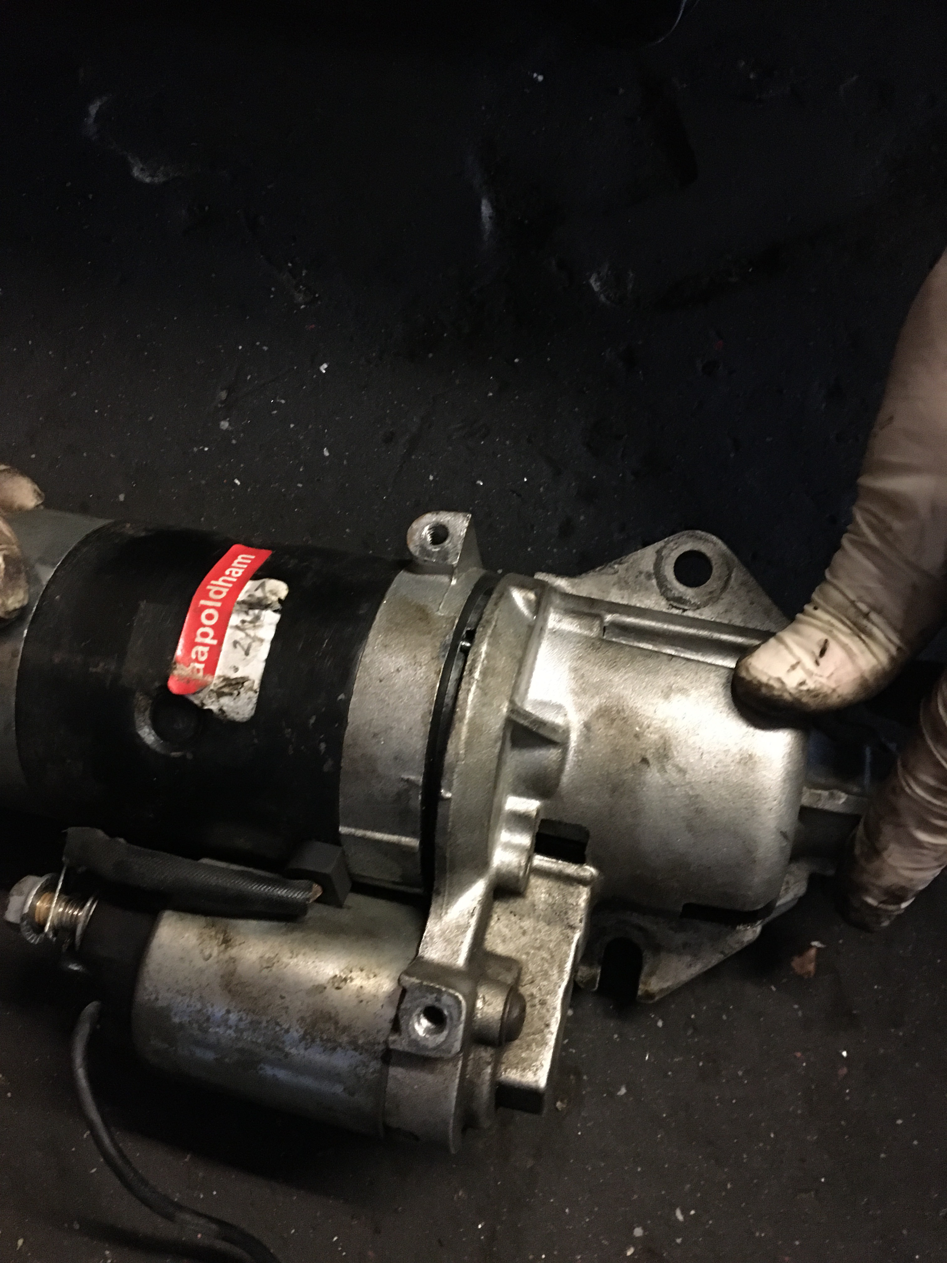

Starter motor case had the bolts which hold it together missing somehow - only found out when the garage doing the clutch and flywheel at start of June had told me. It’s been starting straight away since I bought it but always made a sticky sound for a split second straight after starting, which was probably caused by this. I gambled and bought a refurbished starter from a supposedly reputable company - ‘the starter motor and alternator company’. It was £155 so £55 more than the one fitted to my car by the previous owner 2 years ago, so let’s hope it was worth the extra money!
Some pics of old/new starter motor and engine bay below. Forgot to take a pic of the new starter but I’ve put in the advert pic which is exactly the same condition as the one I received.

Looking good, how did you clean the springs then?
Thanks for sharing Naz its getting better every time you post and with the new parts it will look even better. When I got my timing belt done I had new chrome bolts fitted to the T belt cover. The devil is in the detail.
Thanks Gaz, it’s appreciated [emoji1417]. You’re right - the devil is definitely in the detail. The engine will slowly get cleaner as I learn how to remove certain parts of the engine bay to get access, as time goes on.
I went with the oem bolts at the last minute as all mine are rusted and washers cracked - in hindsight I probably should have forked out the extra and got one of those ‘Z-Spec’ engine dress up bolt kits... Something for next year I guess then! Also I like the idea of some engine tucking like the fuse box and power steering reservoir relocations to below nose panel, as it is a bit of a faff in there. Let’s see what happens..
Thanks mate! Just got a small bit of household sand paper and lightly sanded the springs, and the corrosion came straight off. I ripped bits of plastic carrier bags to wedge in underneath and around the springs to cover the surrounding areas. Then sprayed 2 coats of Halfords engine clear paint.
BTW, the brown finish on the springs is an anti corrosion coating applied by the factory.
Ah that’s interesting - thanks for the heads up. Good thing Joel told me to apply a clear coat to it. Hopefully it will protect them.
I wouldn't have sanded personally. What's underneath is a silver plating, the discolouration you see there as Andrew said is a factory coating to protect against corrosion. Polishing would have removed this although I took mine out completely and had them stripped and re-plated (along with everything else) I did not apply any additional coating and they stayed looking fresh.
Edited by Funkysi
I see - thanks for the advice, it’s appreciated [emoji1417]. In an ideal world, I would like to take the throttle linkage items apart I.e all the bits in your photo to get it all newly plated, especially after seeing Chris300’s project thread. Being a new Zed owner, I’m always a bit nervous about breaking something, but will hopefully learn soon how to take it all apart the correct way and get it refinished.
What an absolute pain I’ve had for the last two weeks almost. After fitting the remanufactured starter motor, it worked great for the first 2 days then the starter wheel stopped fully engaging with the flywheel, so it was grinding my beautiful specialty z flywheel. I stopped driving it for a week until a replacement turned up. The supplier thankfully didn’t argue and paid postage for me to return the starter and get a full refund, so although it was a pain for it to not work properly, I can’t fault their service. On top of this, I was laid in bed for last/this week with a bad leg so it’s actually been pretty good timing - last couple days my legs healed up. Me and the car must be in sync for breaking and healing at the same time! [emoji23]
So I ordered another starter last Friday 3rd which was due this Monday just gone. I told the guy I’d pay extra to get it on Saturday 4th but he said no don’t worry, the free postage will give you Monday so I thought ok fair enough. Monday came and went and no sign. I messaged him Tuesday then he says oh sorry our supplier let us down so we’ve been delayed - thought oh that’s great, nice of you to let me know!! I was then told it would be posted Wednesday and arrive Thursday (yesterday).
Thursday came and went and no sign. It turned up this morning at 8:30. It’s my wife’s birthday so we were supposed to be leaving on a 160 mile round trip to see her friends and wanted to take the Zed. I Managed to call my garage who I’m very friendly with and get it replaced this morning very quickly. New starter is working all good, for now...
Got the car booked into PowerZed finally for mid August to do the following;
- 120k service
- replace the power steering reservoir return hose which has started falling apart at the top
- sort a minor oil leak
- try and sort my door locks
This’ll then give me peace of mind mechanically.

Wow it’s been a while since the last update.
Just picked the car up from PowerZed today.

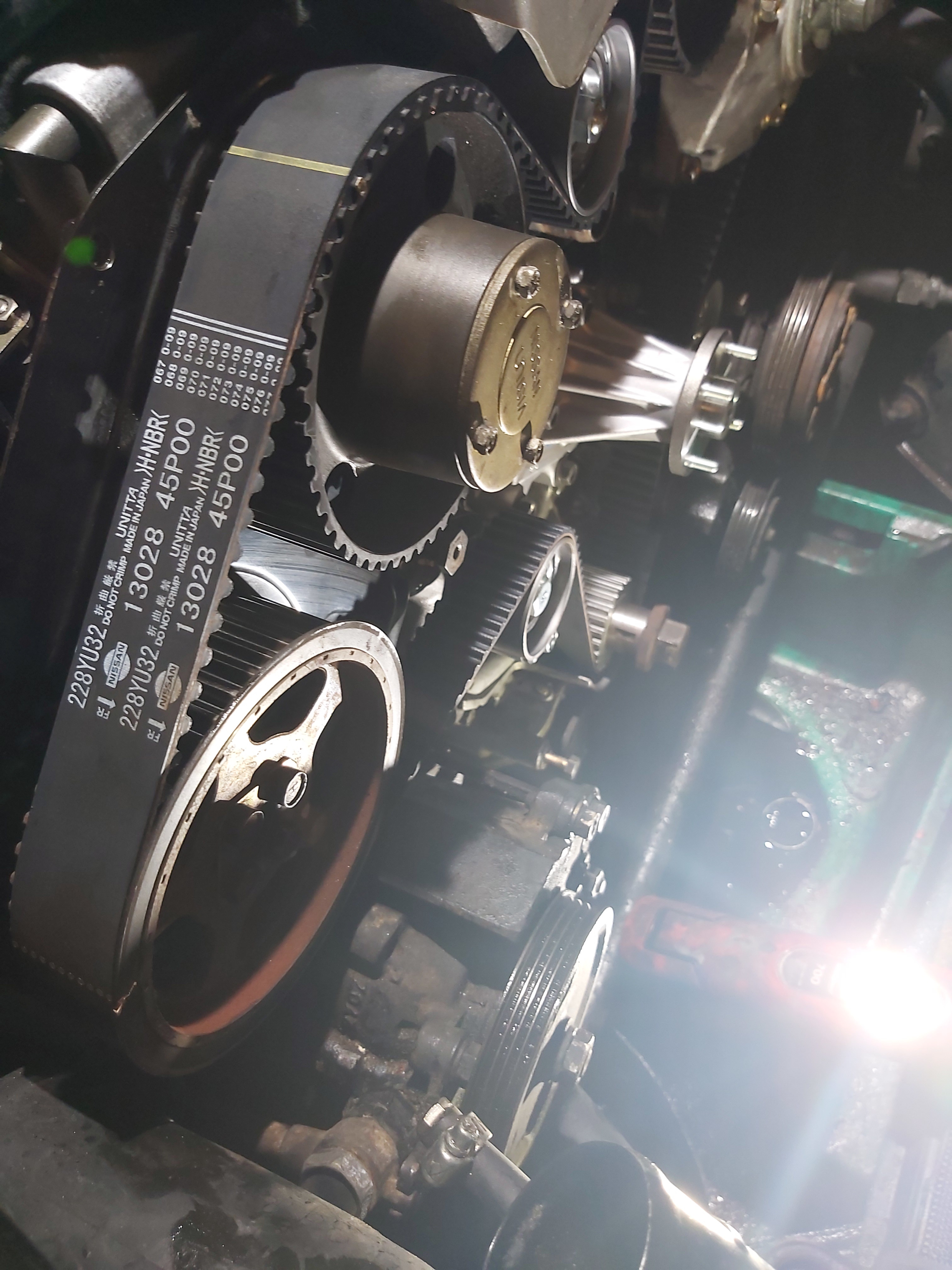

Jimmer really is the only man to be working on these cars and he’s super friendly to boot. I don’t know why I’m so surprised by his excellent service and knowledge, since everyone on this owners club always raves on about him, I should have expected it. I guess because in comparison to my local cheap garage who I always have to watch to make sure they’re not doing anything wrong, it’s lovely for the first time ever for me, to be able to relax and leave your baby in the hands of a true professional.
I had the full 120k service done and oil change, the power steering return hose replaced, all timing cover bolts replaced with a genuine oem set (massively overpriced!), coolant flush, engine bay fuel hoses replaced and spring clamps fitted, and my ebc repaired.
Even though my engine last had the 60k service done approx 25k-30k miles ago max, it was done 7 years ago. The maintenance schedule states every 60k or 4 years. My point is that although the condition of the timing belt was ok, the water pump had a leak forming and all the various seals that get replaced had turned rock solid. So you should always follow the maintenance schedule, as they’ve been written with those intervals for a reason! Don’t ignore it.
Some of the photos Jim took below of the service.

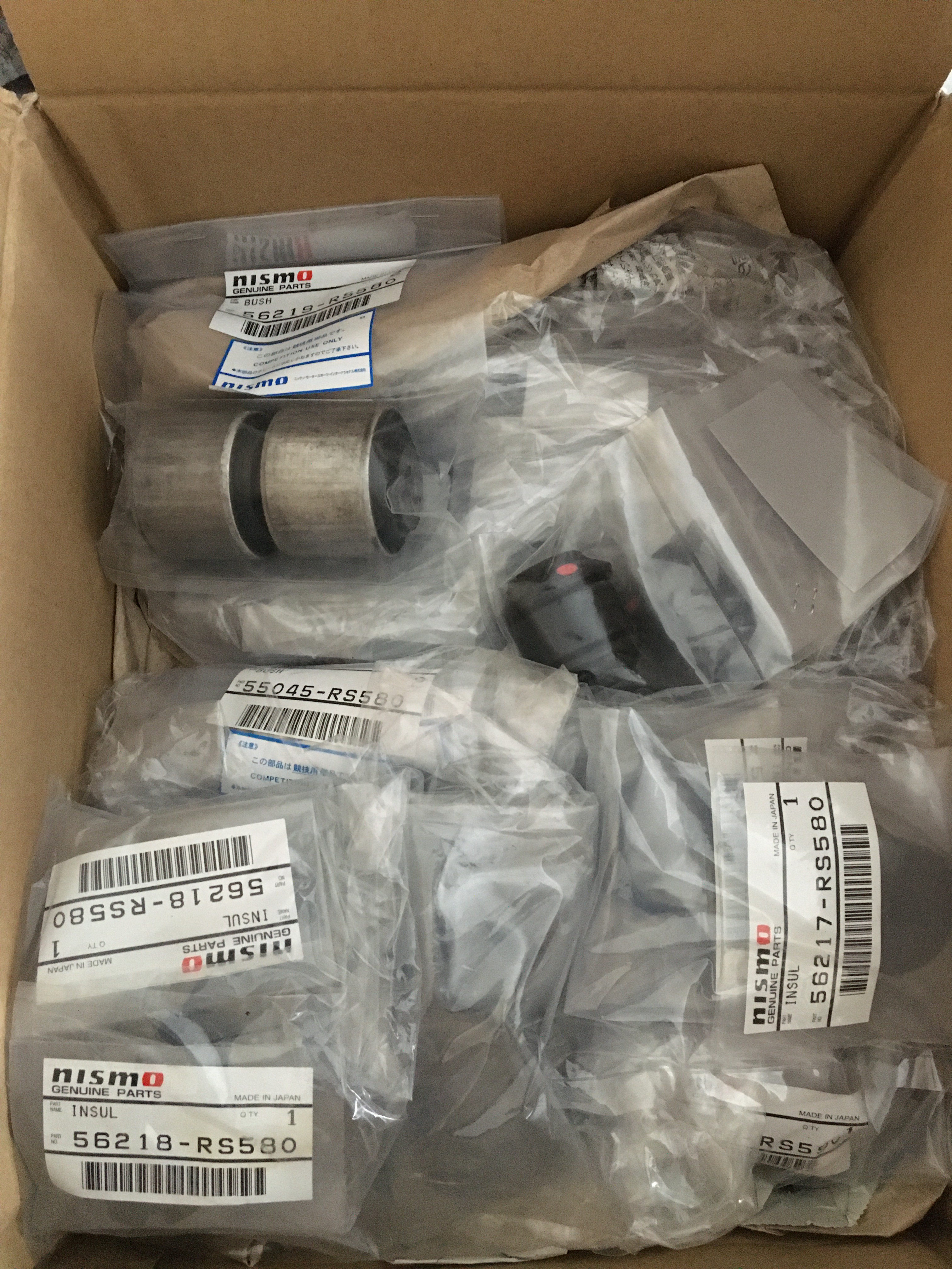

Nismo bushes came today woohoo [emoji2][emoji1][emoji16]. Whatever bushes Nismo didn’t sell, I sourced energy suspension ones. Shipping was quite impressive - CZP came in 3 working days as usual and Greenline motorsports Japan delivered all the Nismo ones within a week too.
