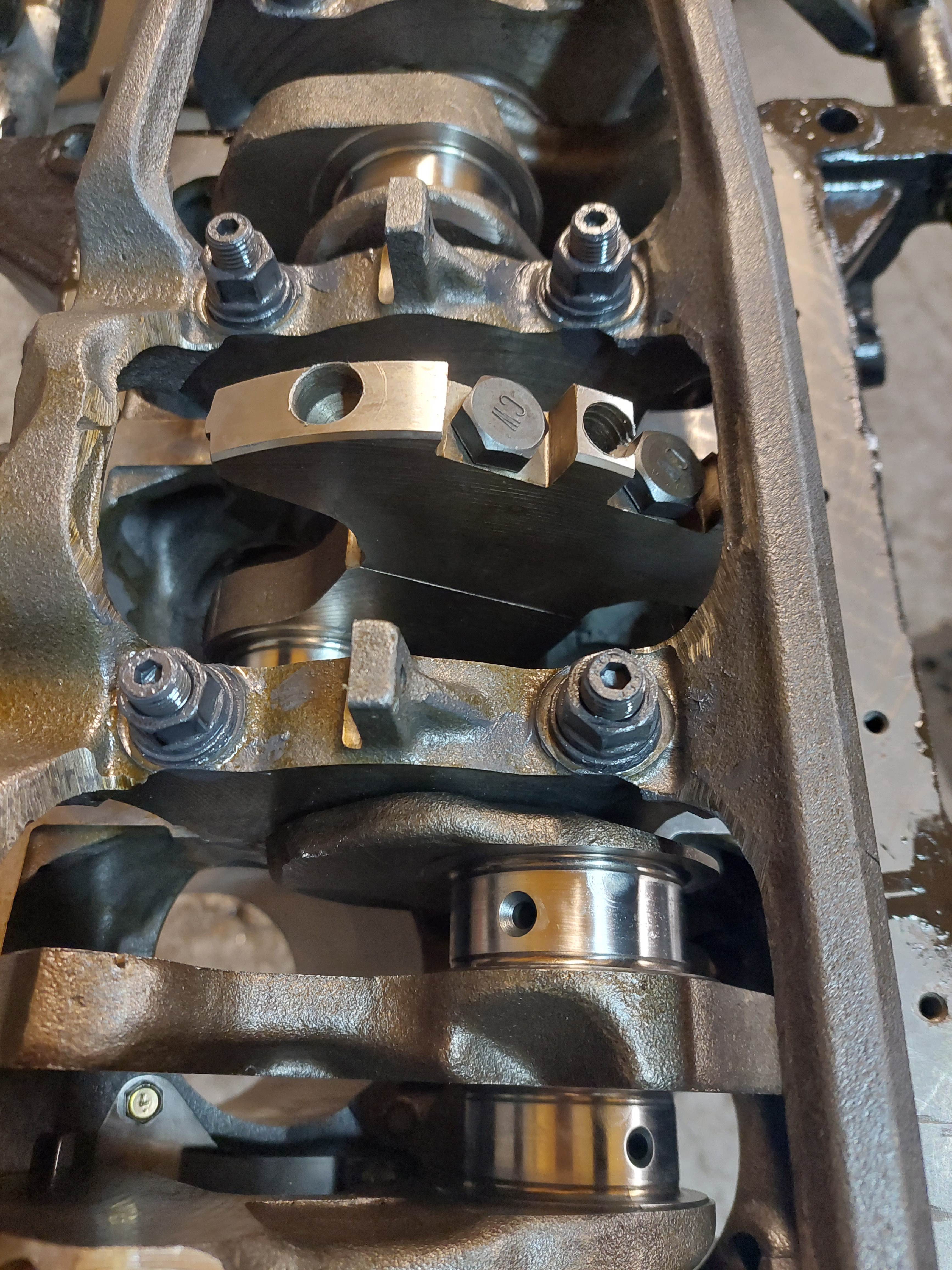

  • I get more excited about this type of stuff, than the big works like the engine build.  Both the metal platers and powdercoaters turned it around quicker than quoted, and at great prices, so very

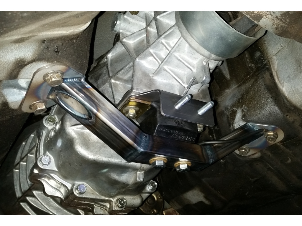

- BDE transmission mount; a beautifully made part and appears to be the best product on the market. Originally I intended to keep my Nismo mount, but after going through the service history, I realised the mount was around 11-12 years old. Jim pointed out the car had only done around 30k KM's in that time so it wasn't strictly necessary, but I wanted to replace any key parts like this, whilst I have the chance now. This is a lifer car for me, so future proofing whilst parts are still available is important, which I have to remind myself sometimes, to help justify all these parts!

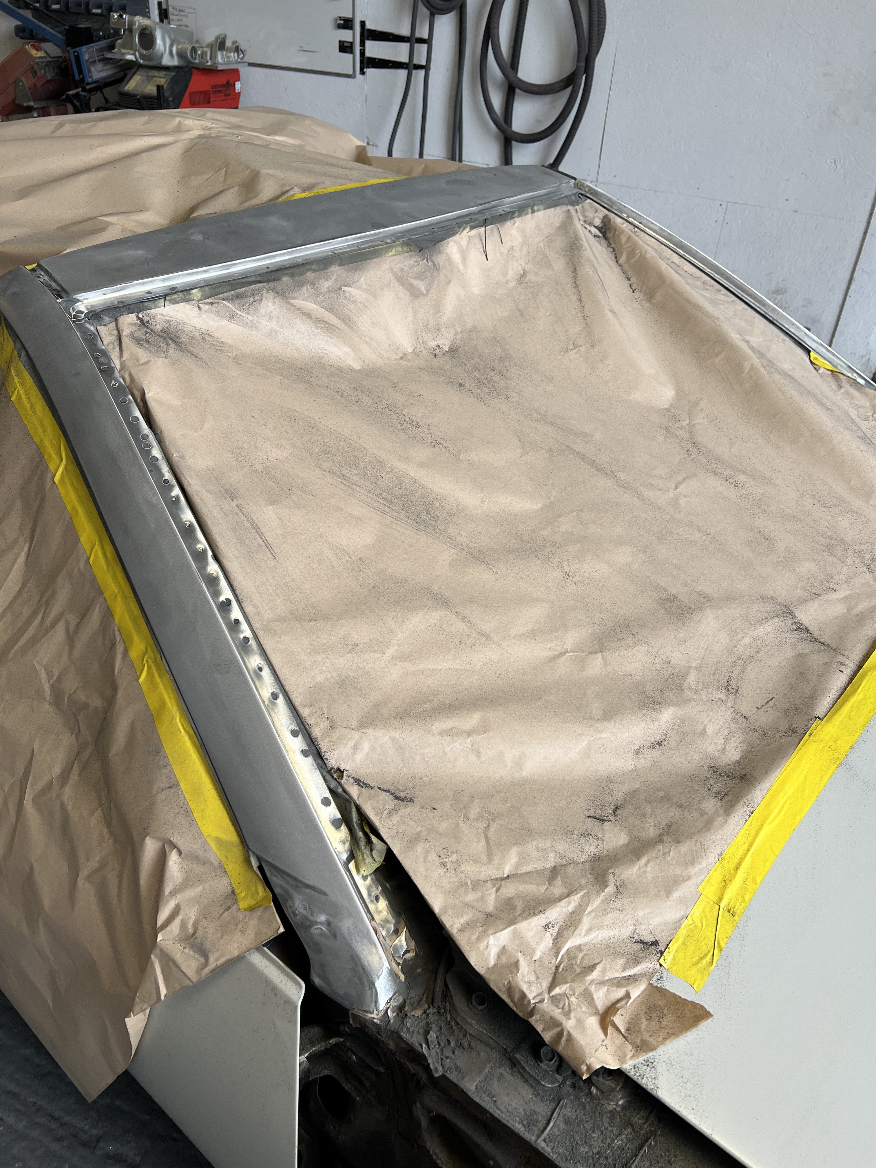

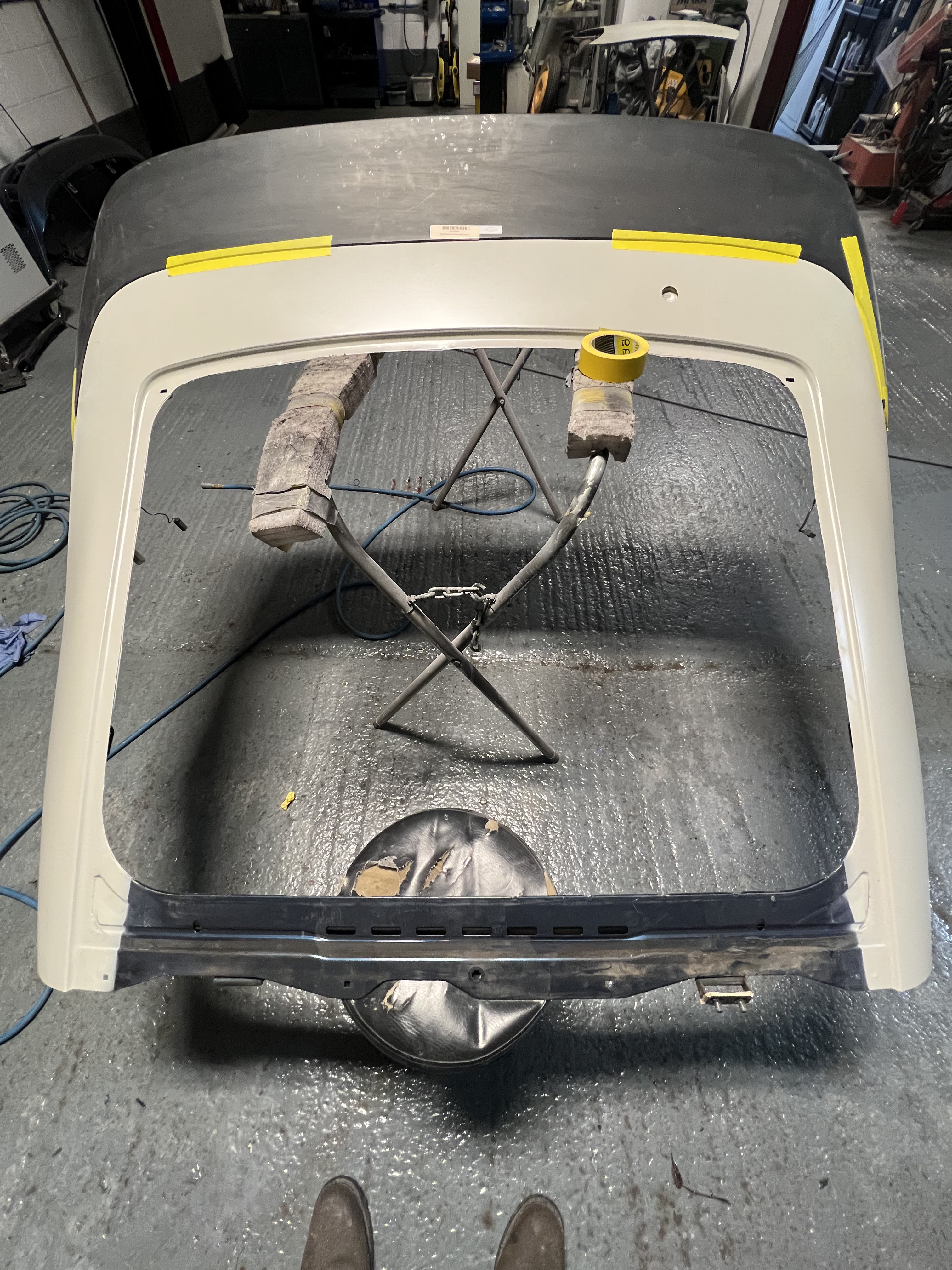

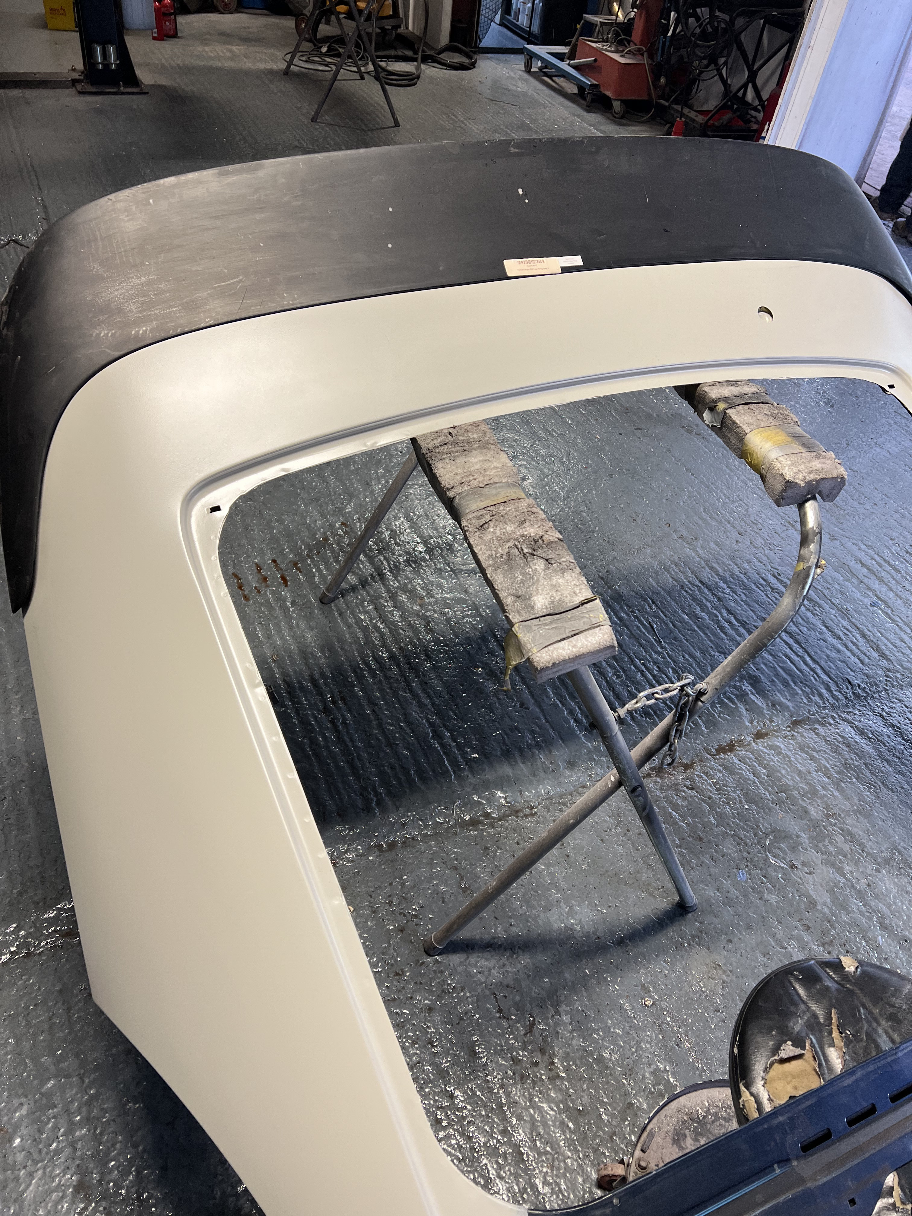

After the front and rear windscreens were removed, off comes the boot and front pillars/roof paint. Note the targa drain was capped off and removed when they blew all the dust off.

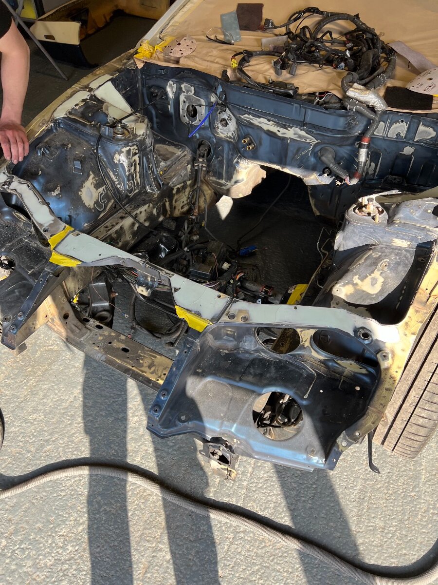

Some rust was found hiding under one of the seals [emoji50]. I’m glad I’ll finally be able to store her indoors hopefully from this summer, to prevent that ever happening again.

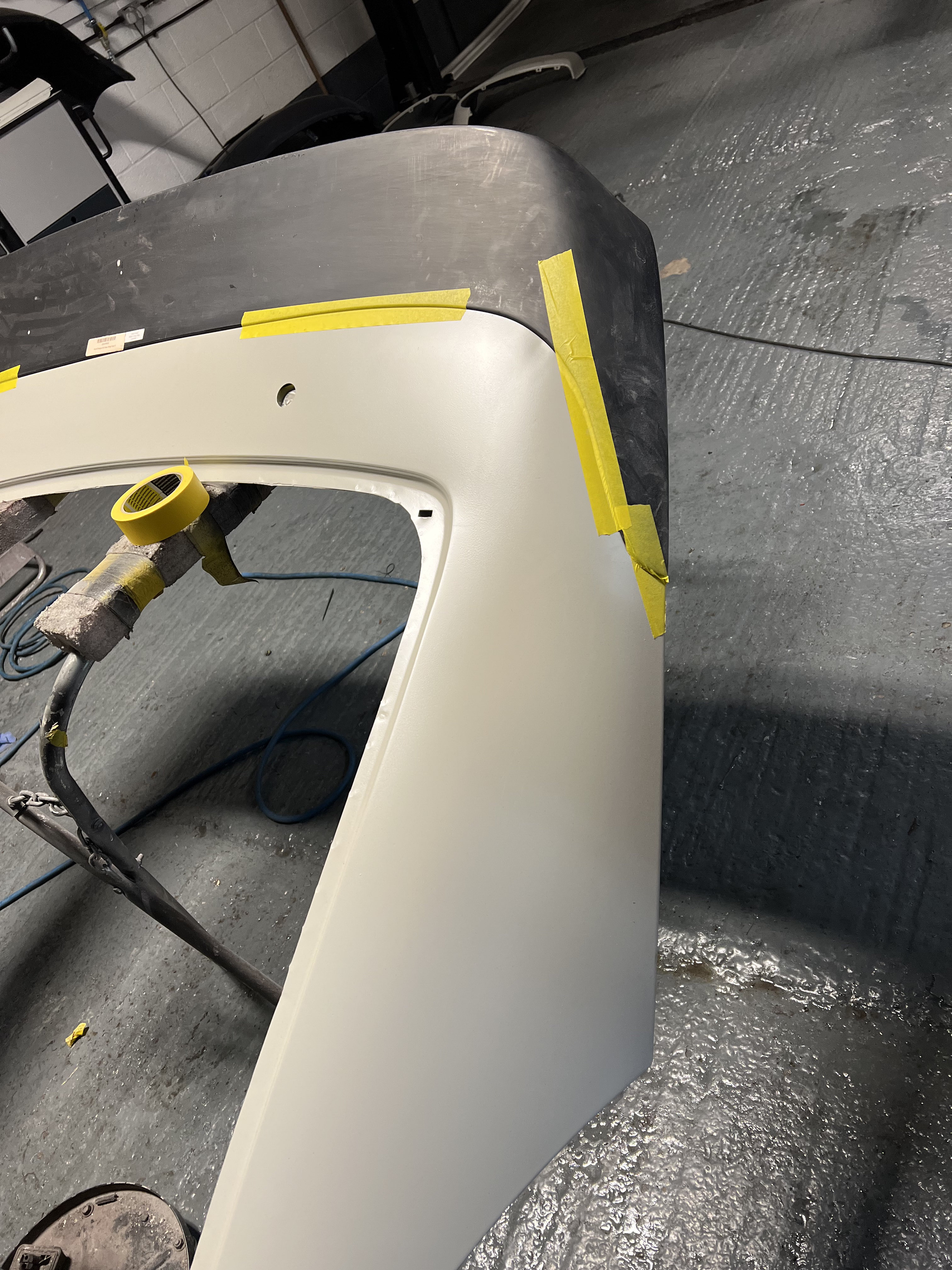

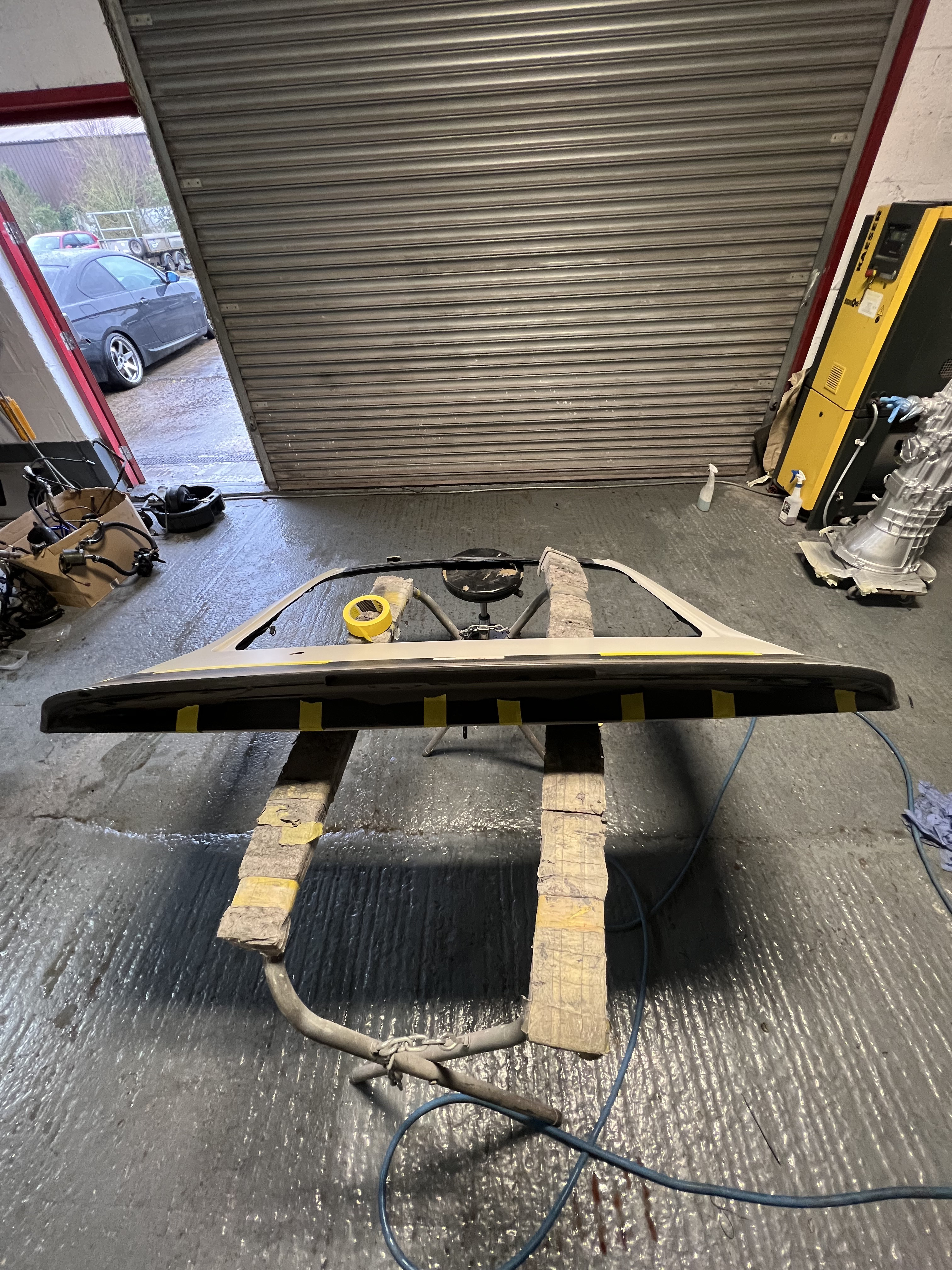

The bodyshop repeatedly said how great of a fitment every Twin Z part they’ve fitted has been, which must have jinxed my rear spoiler! As it didn’t fit perfectly. They’re getting around it though by doing some trimming, minor adjustments etc. Not a big deal, just not the perfect fitment they usually are.
Looking good though regardless [emoji41].

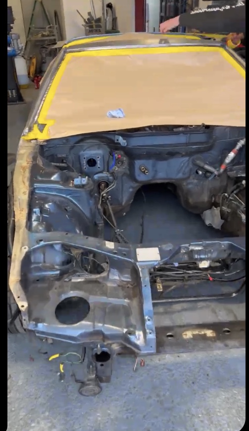

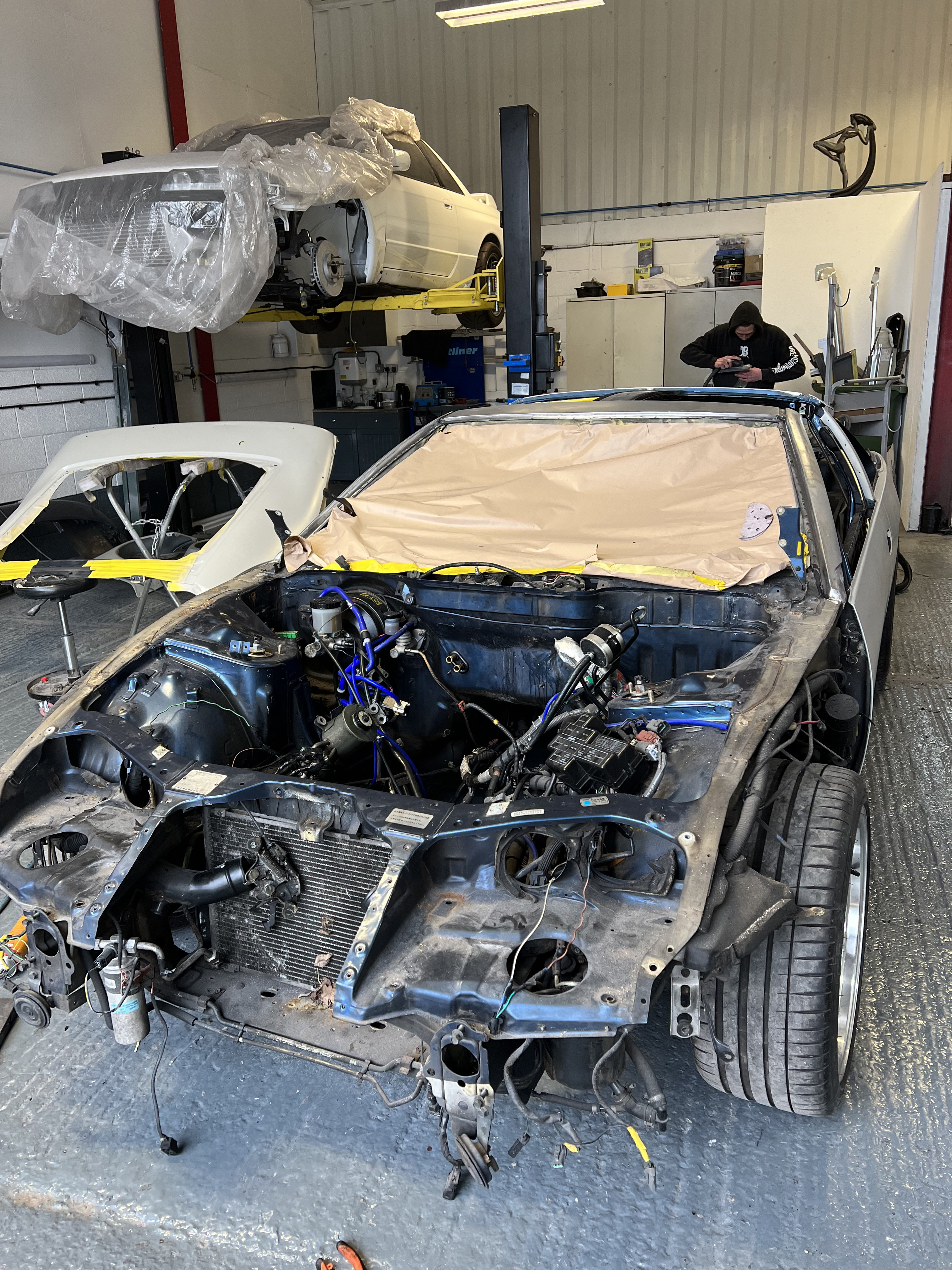

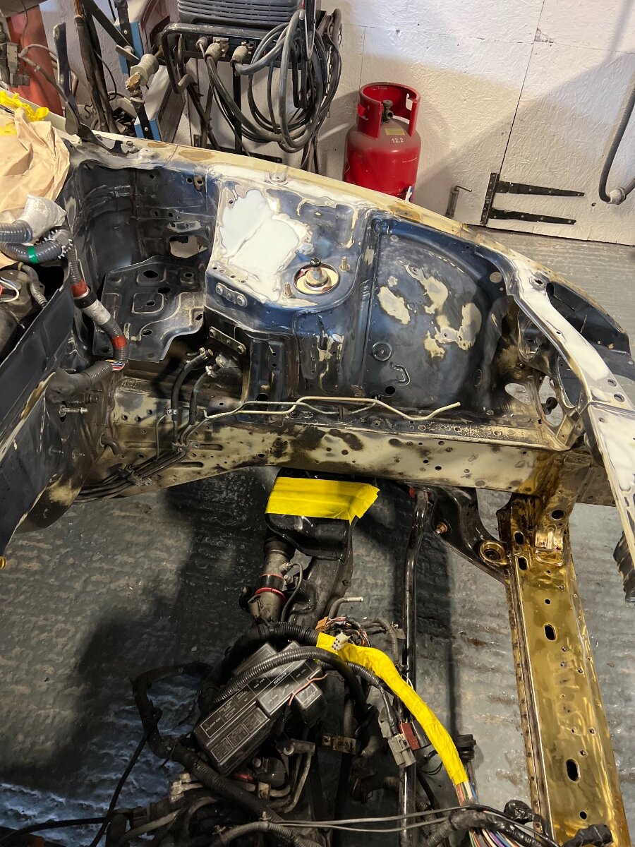

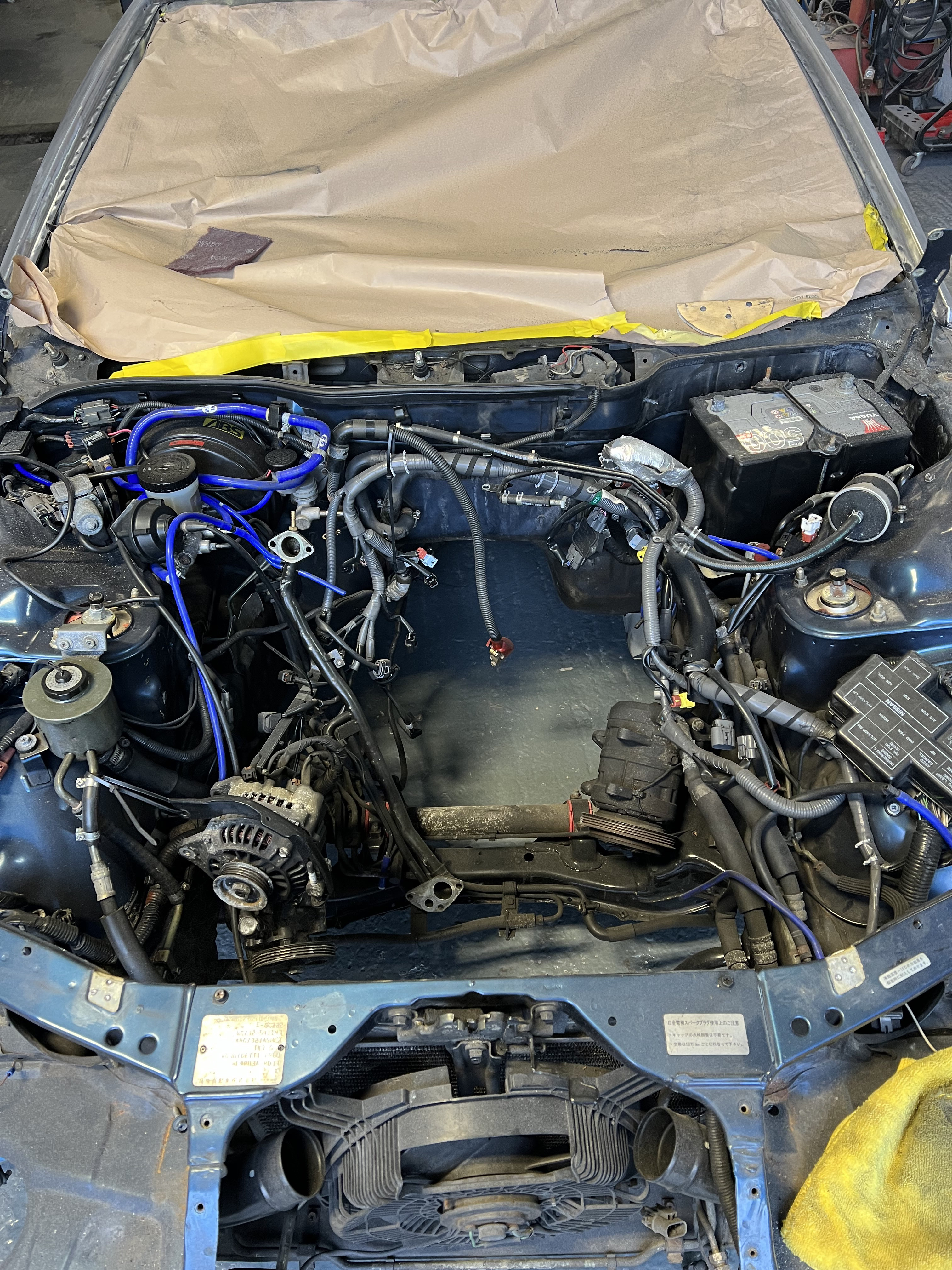

Engine bay getting stripped down too woohoo [emoji2][emoji2][emoji2]. Not a full strip down and show car paint job though. Main aim is to repair two minor areas of rust and to freshen it all up.
The bulkhead will get a repaint too. I had quoted separately for a full strip down and repaint to a high end finish but it was just too much over and above what’s already being spent. We both agreed you can’t really see much of the paintwork in the engine bay due to how cramped these engines are! Unless I do a full on engine tuck which I’d never do - couldn’t bring myself to hack up a brand new OEM wiring harness etc.
Anil at the bodyshop cant bare to put back the stock old and dirt ingrained bolts when they put the engine bay back together so will put back S/S bolts everywhere. I decided to go for gloss black bolts for where the wings/arches bolt onto the frame. They advised painting them like the OEM finish can lead to the paint cracking up over time, which I want to avoid at all costs - never want to do paintwork again!!
Jim will repaint the plenum in the stock silver and do the balance bar in black, as it had chipped away. I want to do a full on engine bay refresh in the next few years including a plethora of zinc coated parts - like what funkysi did to his bay before selling her and what the USA Skyline fanatic (Youtuber) tommyfyeah does to all his skyline rebuilds.
For now though, the above will be x10 better than what it was like before, so more than happy.
Jim is ploughing along with the engine too. Looking fantastic - can’t wait to have the peace of mind of a freshly built engine by the best in the business.

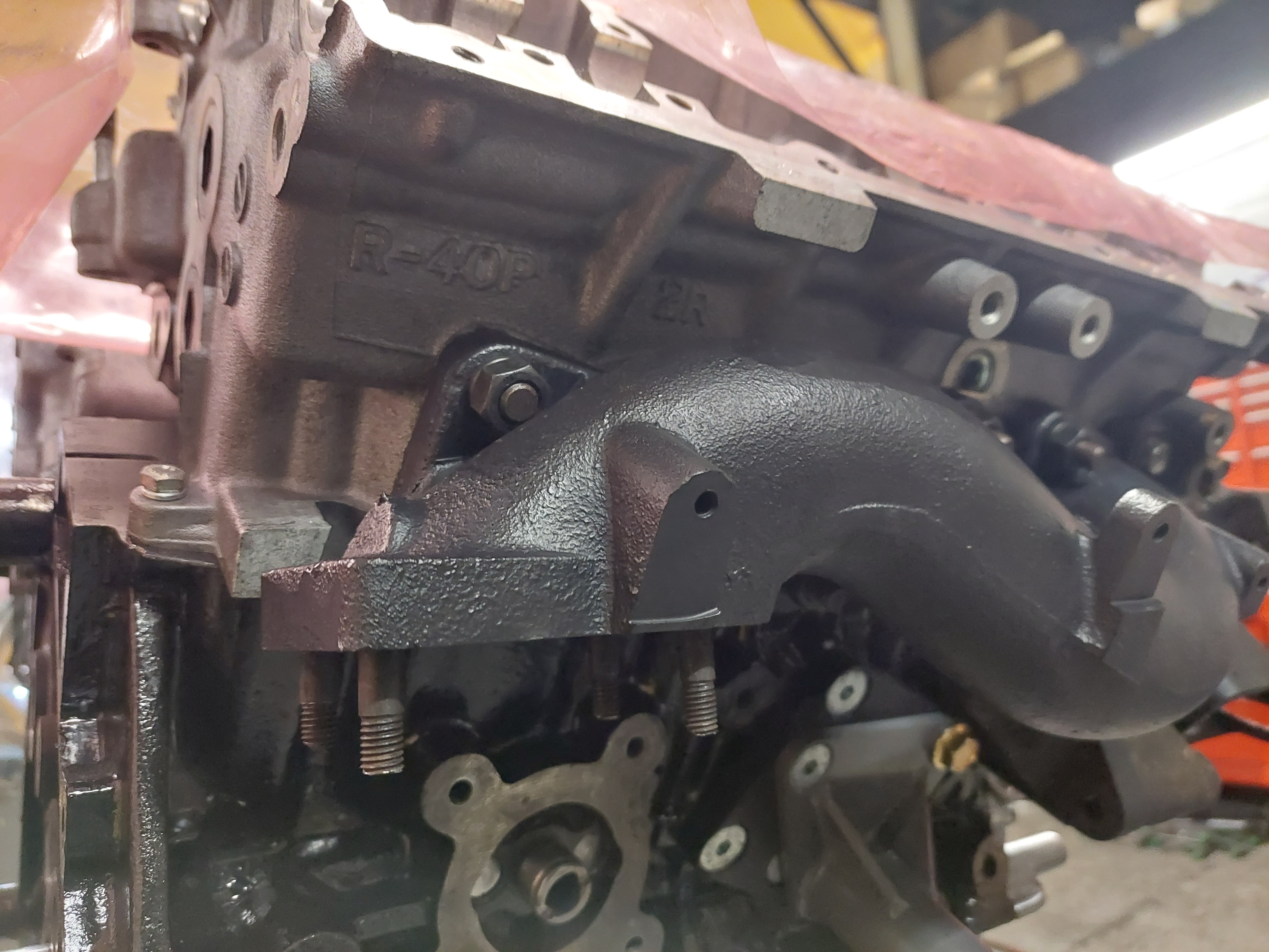

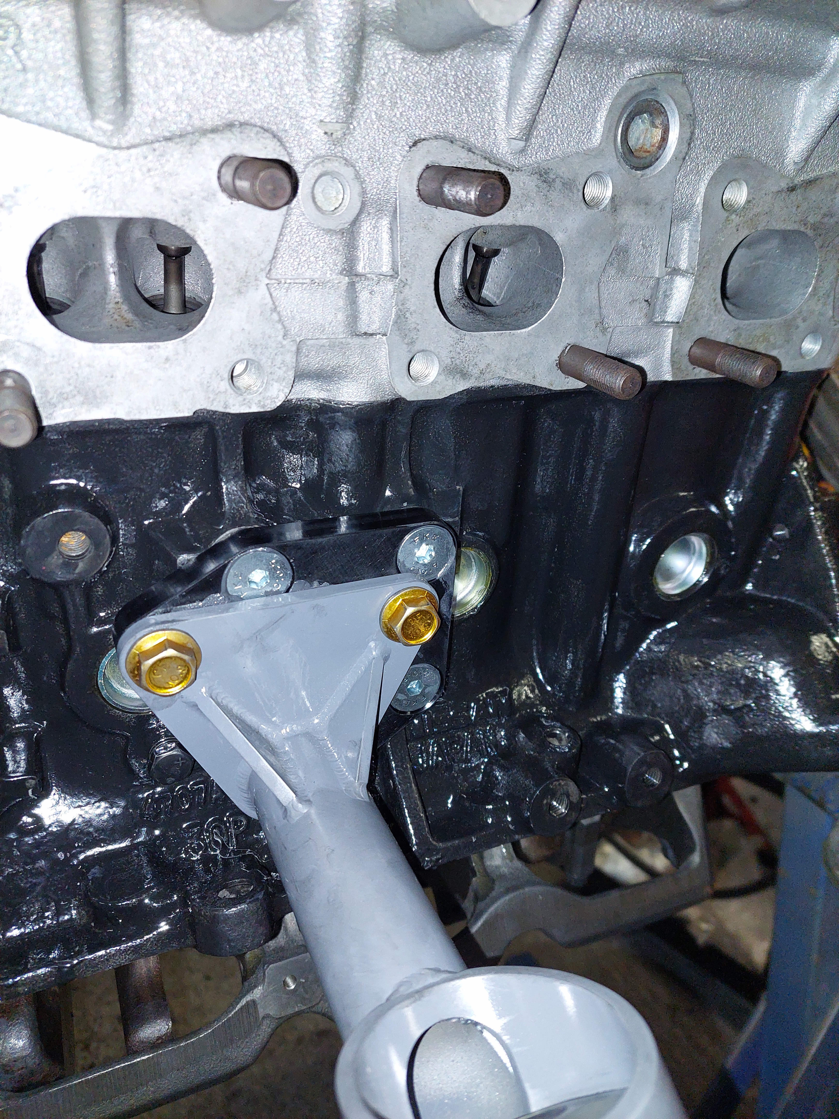

BDE mounts being put to use. I ticked the ceramic coating option for the AMS exhaust manifolds for the heat management benefits, but the unintended consequence is that they look soooo much better than the original items.

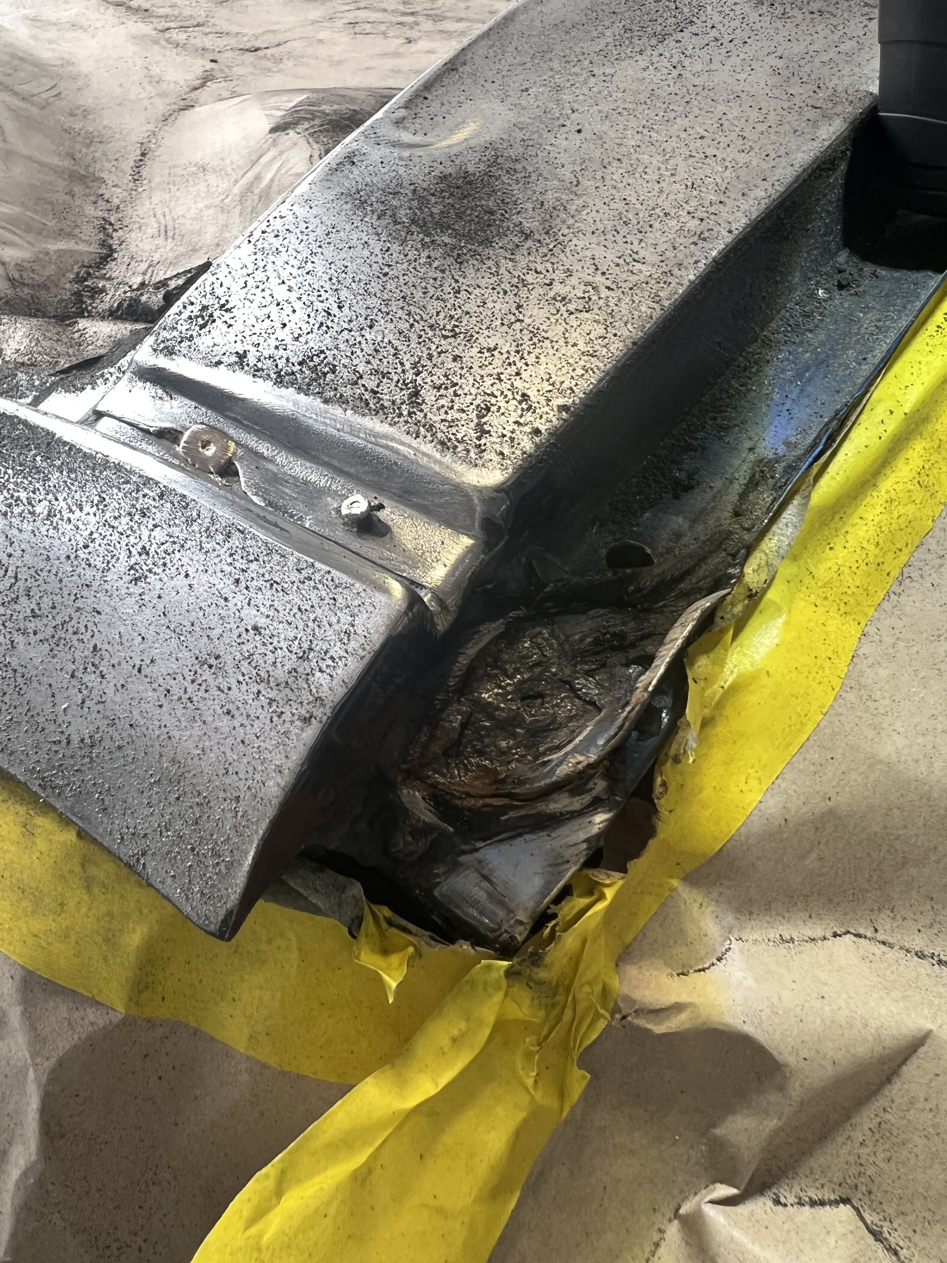

After stripping the engine bay more, they found lots of surface rust scattered around, which would have spread, and they just couldn't leave it the way it was/cover it up etc. So sod what I said earlier about not going mad on the engine bay - I guess we're already part way there...
