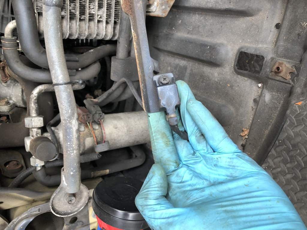

This cable is connected to the fog light front fascia support bar. Maybe an ambient temp sensor?

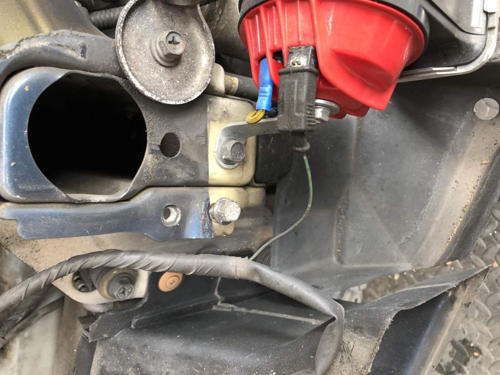

I’ve also got a random bolt next to the off side horn. Any ideas, maybe the OEM horn bracket required two bolts?

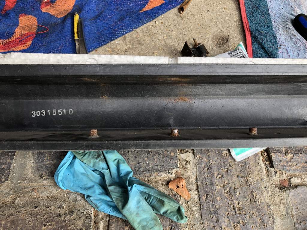

While removing the above components I’ve found that one of the “nuts” just spins. Nothing that a set of mole grips can fix but I was wondering what these nuts are called and can they be replaced?
Those nuts are captive from memory and are part of the crash bar.
No idea. If it's moulded into the plastic, then probably not.

Could those be for the horn covers ?
I’ve not seen a standard horn nor cover. Can anyone confirm please?

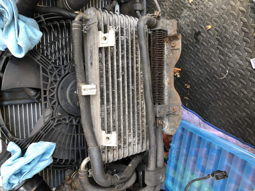

I believe the larger of the two coolers is the oil cooler. What is the smaller one for? The oil cooler looks to be in fare condition (however I may fit an updated one while I’m here if recommend) but the smaller cooler is showing its age.

The smaller cooler is the transmission oil cooler.
Also highly recommended that you replace the engine oil cooler with an upgraded unit, while you're at it.
Correction it is the Power steering cooler. :biggrin:
The engine oil cooler for UK specs (21305-37P00) is larger than the JDM and US cars. It is sold in the US as a Nismo part:
https://conceptzperformance.com/nissan-infiniti-nismo-jdm-oil-cooler-nissan-300zx-z32-21305-37p00_p_6127.php
The power steering cooler is NLA.

Does anybody know of alternative coolers for the power steering unit?

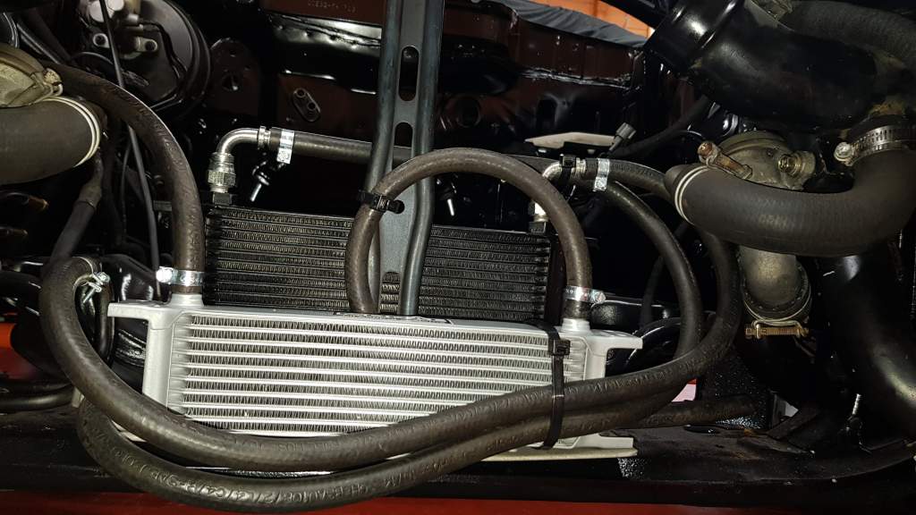

If you are able to find a US spec engine oil cooler in decent condition you could re purpose that as you power steering cooler.
If that is not an option, this is will get the job done just fine, albeit some minor modification will be required to mount it.
https://www.z1motorsports.com/power-steering-hoses/nissan/oem-power-steering-oil-cooler-370z-p-9271.html
Nor me, I do have some ready to fit but not a clue at the moment how they go on :confused1:.
I have a pic, post 345 in the below, you'll notice they have two bolt holes.
https://www.300zx.co.uk/forums/showthread.php?175200-1994-Silver-Series-IV-Slicktop-Version-S-Taking-To-Another-Level/page9&highlight=horn+covers
