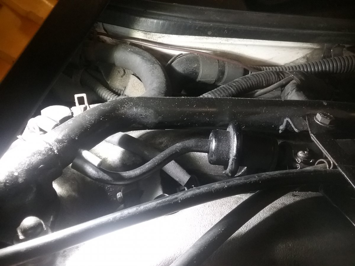

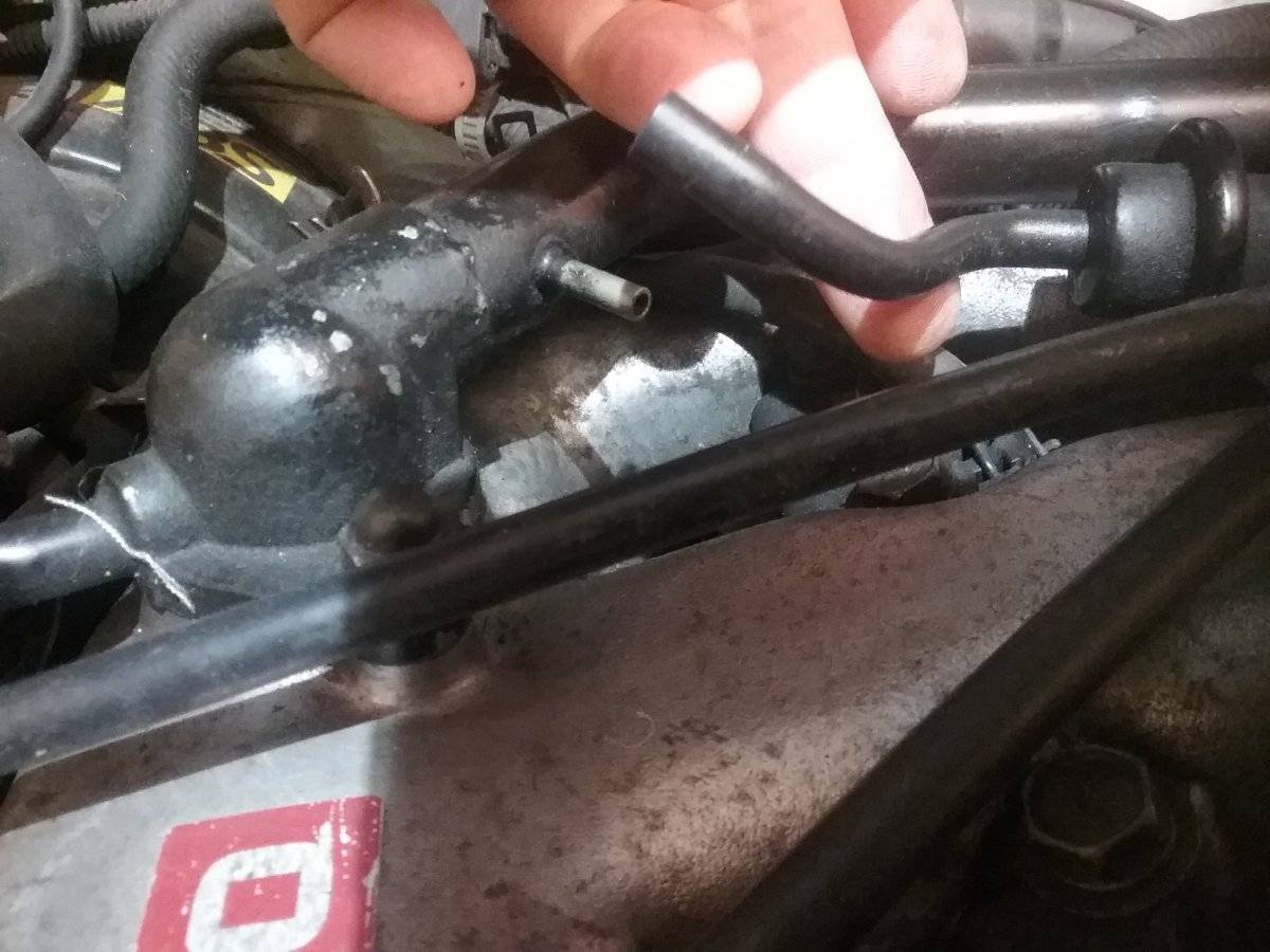

There is a good write up about emissions, Google    ' Nissan 300zx  pass emissions test'      and you will find great article about what happens when you temp disconnect pipe from fuel damper at rear driver side of engine. I failed mot emissions took car away disconnected said pipe and passed with flying colours!!
I disconnect this pipe every mot and never had another emissions failure again  since
Ps don't forget to reconnect after mot!
The article was on 300zx-twinturbo.com
Dutch guy with pics.
