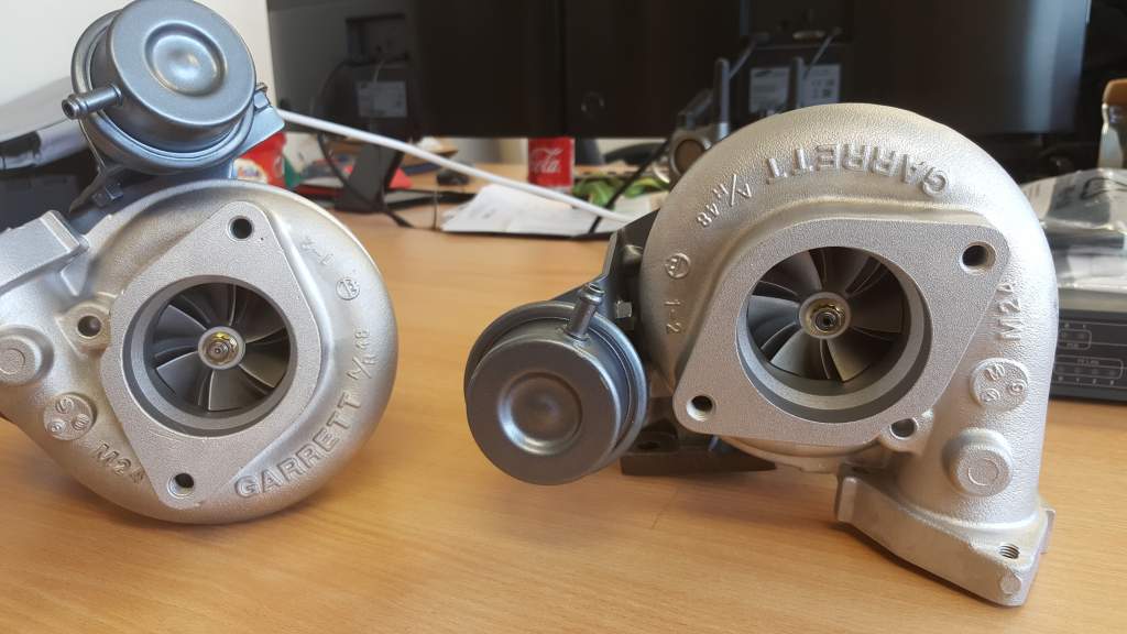

I've done 2 full conversions now and never had an issue with a high idle or anything else.
Only thing was having slightly smaller turbos, but the auto turbos spool up faster.
Below is a pic of my old auto turbos compared to my new ones.

First plenty of visual clues with a conversion. The biggest been the auto wiring loom on the drivers side inner wing. Also the radiator will have a trans cooler pipes, the shroud is not different though. The knock sensor circuit issue will not cause an over rich situation but will reduce power both on turbo and non turbo engines.
The code 54 could be due to an auto chip been used, below the dash cluster on the right hand side above the ignition key has three light panels for auto, on manuals they are blanks.
