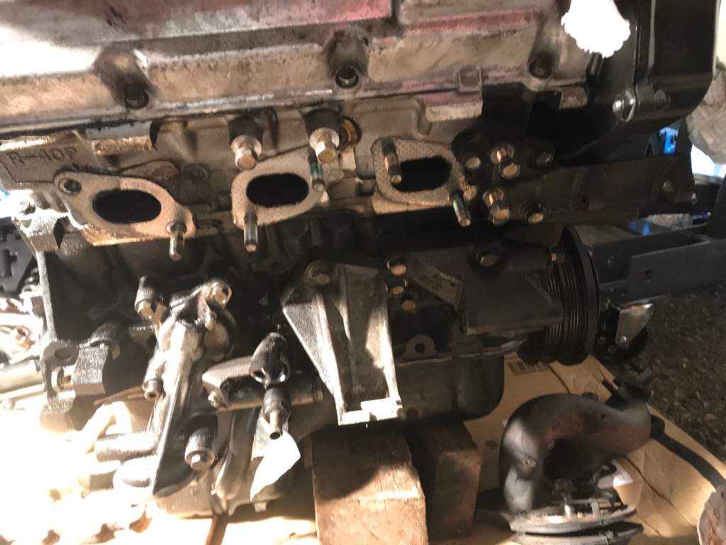

Really short progress. Was sitting all this time in the garage. Managed to get a couple spare hours this weekend. Radiator out, plenum off. Cambelt coming off hopwfully today. Then heads will come off. Question. How do i drain coolant from the block? Risk snapping a bolt on the block or is there a hole i can stick a hose with a vacuum pump on it?
ย
You will find a drain plug on the block.It is located on the passenger side above the oil rail that feeds the turbo.It is between the AC pump and engine mount bracket.If you are pulling the heads just remove the engine it will be easier than in situ imho.
Thanks for the tip., unfortunately i do not have the space or the equipment to remove the engine. Managed to get the belt off and did not destroy anything. Very stressful experiance. I have done the belt before with locking kits.
Before I took my engine out I wanted to drain the block to minimise the mess, found a bolt when I removed the alternator a lot of water came out canโ€™t catch it all with engine in but did the trick.
ย
Third bolt down in front of the engine mount nearest sump on the drivers side, was extremely tight.

Thanks for help everyone. What a f... job it is to get the heads off with engine in. Fingers and arms all scratched up to armpits... driver side is off. Looks like bad workmanship caused the problem. Head bolts have been reused. Might not have been torqued properly. 2 came off with little to none struggle. So i take it the head just lifted a bit with some boost. Found leak marks from two water ports on cylinder three and one water port on cylinder 5. Passenger side head still to come off. Nothing seems to be damaged so new gaskets and new bolts and will be good to go again. Any trade secrets on how to pull a dipstick tube?
The head bolts are re useable they are not like modern ones that need replacing.I always tap the tube out when the sumps off from underneath but you do not have that luxury.A pair of good quality Mole Grips will probably grip enough to wrestle it out.
