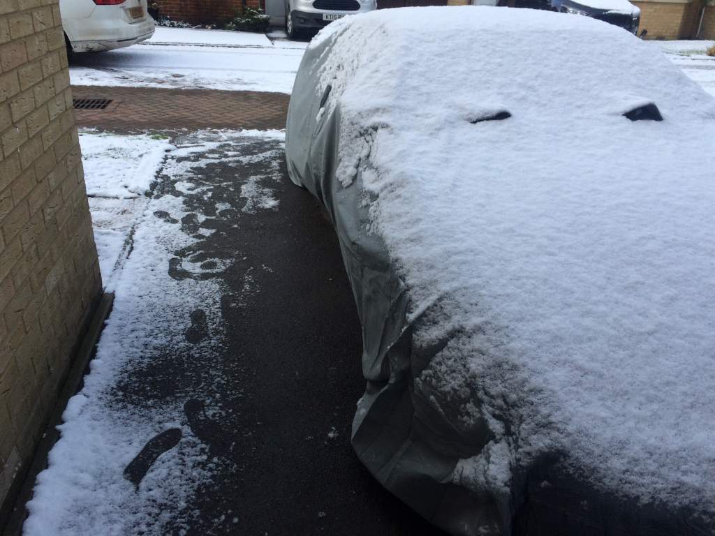

Have another cup of tea Craig and wait for the snow to melt. :)
LOL - yes.... But chances are it probably hasn't melted yet; still white here...:lol:
Draw a smiley face and leave it for another day.
Your not seriously thinking of driving it in this weather anyways.
No, draw a Zed on the bonnet....:wink::cool:

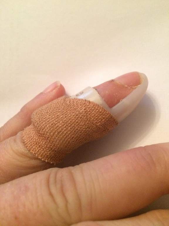

[ATTACH=CONFIG]116156[/ATTACH]
That will teach you to pick your nose with the wrong finger!!!!!..... :biggrin:
Your right handed aren't you?
And that looks like your left!!!!
Plus it is the 'Of little importance' finger..... unless you want to count to 4 on one hand or 10 on both hands.....then your screwed.... lol
How did you manage to do that????
Was it bike related?
it's the "i'm suddenly single again" finger until any swelling or bandages come off, just in case they had to cut the ring off at the time :lol:
but you call it the 'of little importance' finger? :eek:
yes, bike related.. :huh:
I don't wear a ring on that finger....... lol...... unless she who must be obeyed notices...... lol

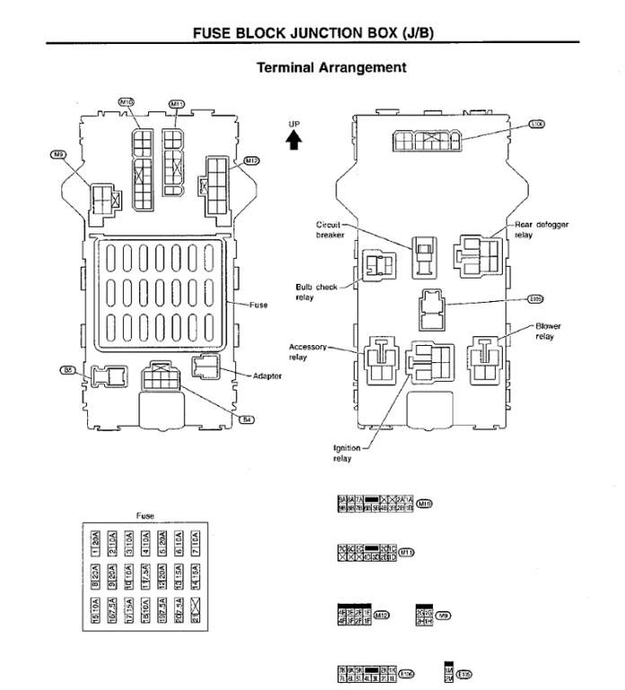

also, any diagrams or pointers to which is the accessory relay, so i can at least pull the correct one to check if i can get to it?
Andrew, would you have the part numbers for all of the relays please? or particularly the accessory and defogger relays?
i couldnt find them on the jp-carparts website.
http://nissan4u.com/parts/300zx/er_z32/1993_3/type_1/body_electrical/relay/illustration_2/
Ignore the lamp check description, it’s just because it’s the same part number:

This is the Japanese version:
https://nissan.epc-data.com/fairlady_z/gcz32/6033-vg30dtt/electric/252/?d1=8908
The ACC and Rear defogger relays look to be the standard (for a Z32) Blue SPST and Brown DPST relays respectively.
