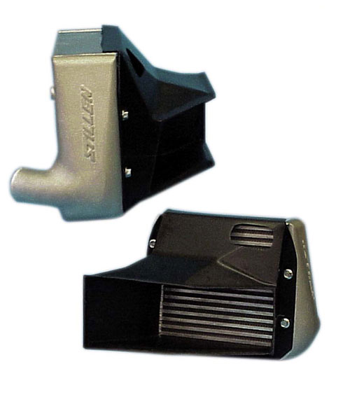

Correctly fitting ducts are an important (and often overlooked) part of getting the most out of larger than stock
intercoolers. Air will follow the path of least resistance and it is important to direct (force) the air over as large a
part of the intercooler as possible. This is particularly the case as the intercoolers sit in front of what is essentially
a box with a NACA duct at the bottom as the only exist for the air after it has passed through the intercooler.
I remember reading an article (which I now can't find) that the difference in cooling efficiency for intercoolers on a
Z32 with and without full ducting was in the order of 30%.
I used Stillen ducts for the HKS intercoolers which covered the entire face. I also needed to modify the indicator
housings to clear the ducting (the rear bulb holder). The picture shows a full face Stillen duct and intercoolers.

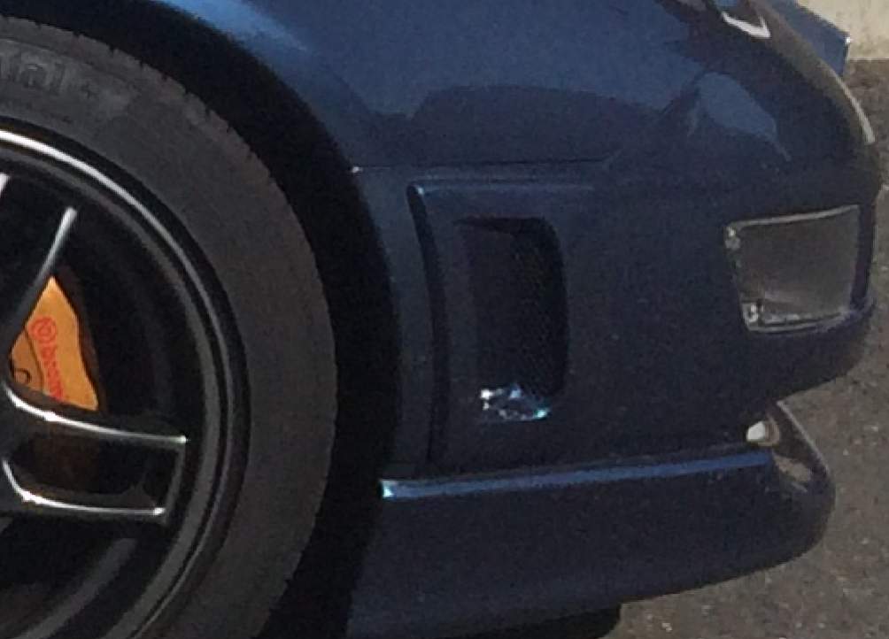

that's the purpose of these vents, NLA from Silvia Engineering
To open “the “exhaust” area to allow that heated air to exit as well.” Maybe I be got the wrong end of the stick but I thought you were referring to clearing space behind the IC to allow forced air to freely flow through the IC.
Yeah. I have done what your thinking. So I’ve deleted the Carbon Canister, repacked and relocated the radiator expansion tank, then cut the arch liners to allow the air to pass quickly away from the cooler. I did toy with replacing the washer bottle but in the end I decided that there was a sufficiently clear pathway round it.
