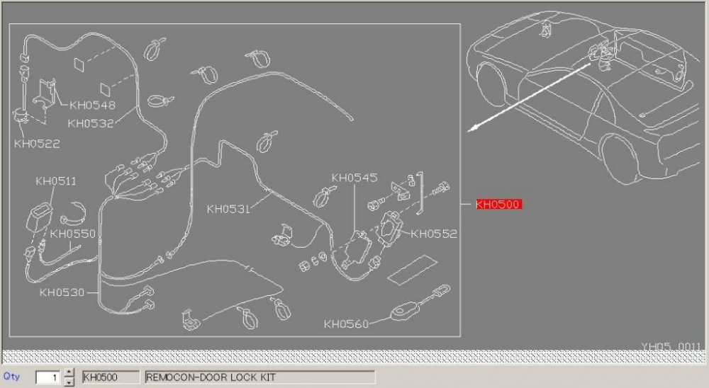

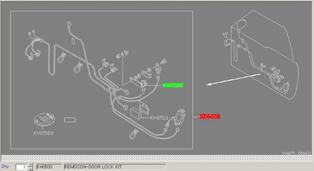

The part number for the infra red fob is H0569-89900 used in the H0560-40P00 kit.
The part is listed here but may be NLA:
https://jp-carparts.com/nissan/partlist.php?maker=nissan&type=132&fig=H05&part=H056989900&page=1
The installation quide (in Japanese) for the H0560-40P00 kit is here:
H0560-40P00 Installation quide.pdf
