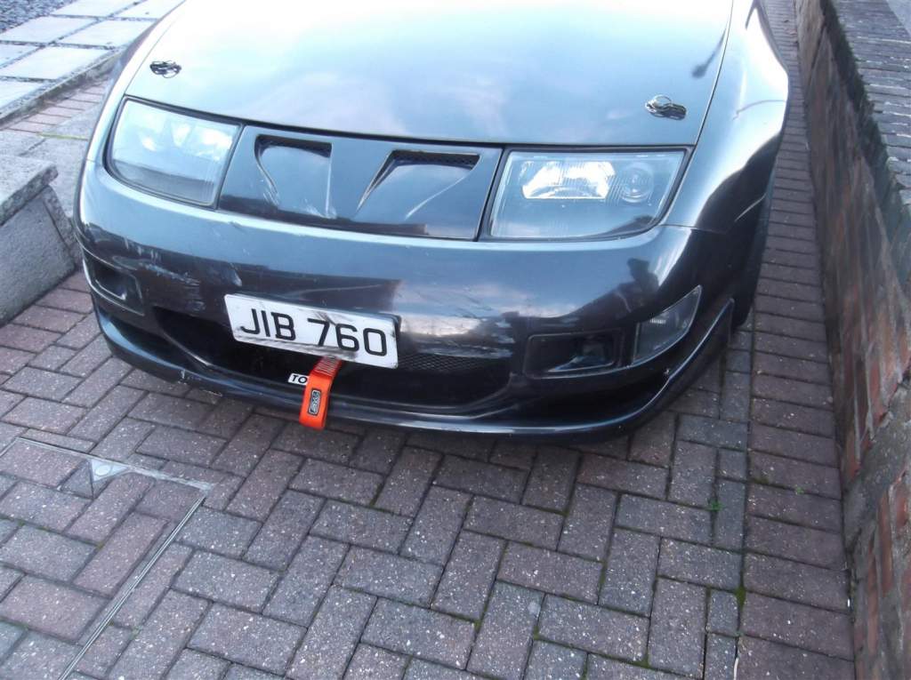

Couple of pics to have a look at.:biggrin::biggrin:
Looks not to bad Pete but worried about the lack of brain cells mate. :wacko:
Im sure the cells will regenerate now the red mist has cleared.!
I was really on one I have to admit.:innocent:
I came out on track the last of the eight in the session and had already overtaken two or maybe three of them.:thumbup:
There’s little point doing it unless you’re pushing your limits and, as you say, it was always going to happen. I’m glad you had a good season and I look forward to reading about your adventures next season. :cool3:
Glad you’re ok Pete, the bumper seems to have taken the impact well. Looks like you hit the sweet spot directly front on to spread the load across the front instead of pushing in a corner. Hope it doesn’t put you off and you get back on it in the new year [emoji41]
The big tyre wall cushioned the impact and did its job well.

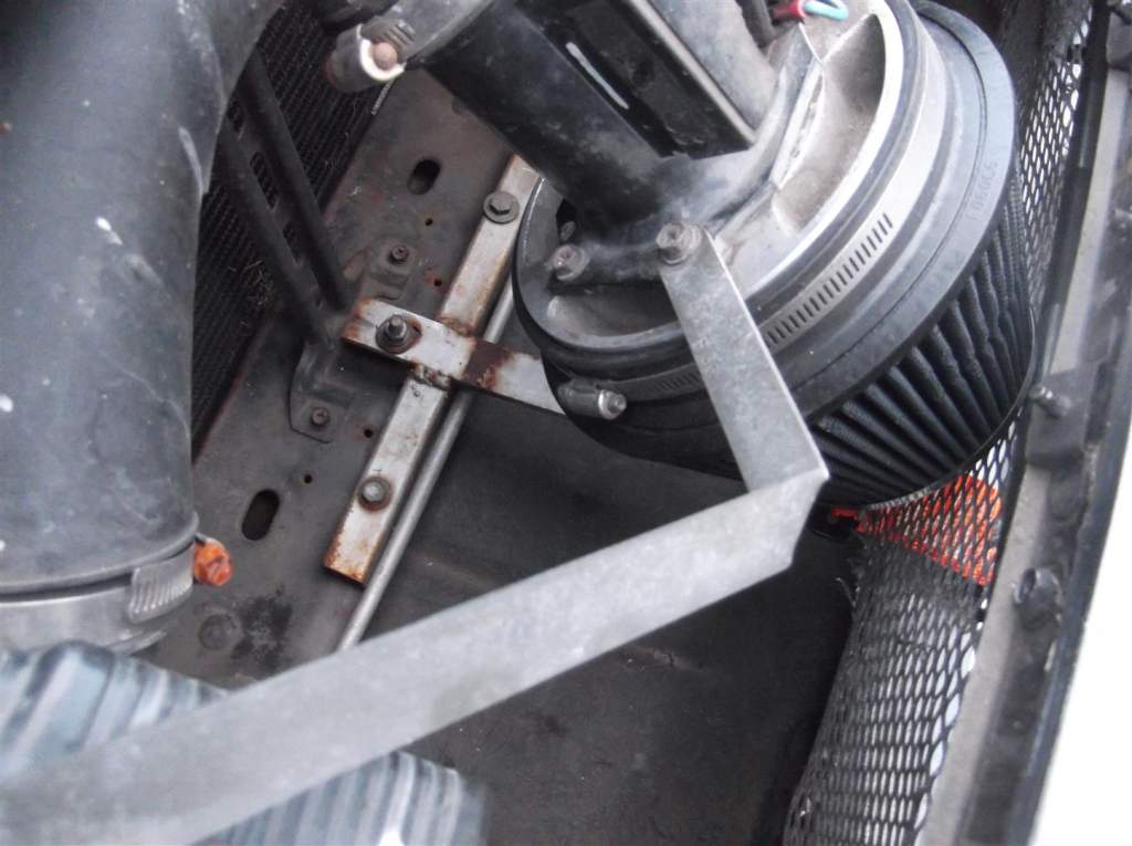

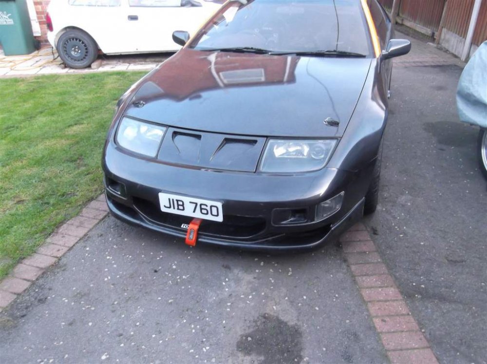

Glad you came out unscathed, out of interest what and how is your towing eye attached to Pete?
Its bolted to a custom steel bracket that I made, which is then bolted to the lower rad support panel.
It is strong enough to tow the car from any situation, the fabric strap allows for quick fixing by a racetrack recovery truck and a pull even from an extreme angle.
And it looks like its sticking its tongue out at everyone you pass... :lol:
Here you go Howard. Picture of the install.....

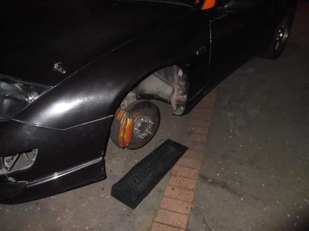

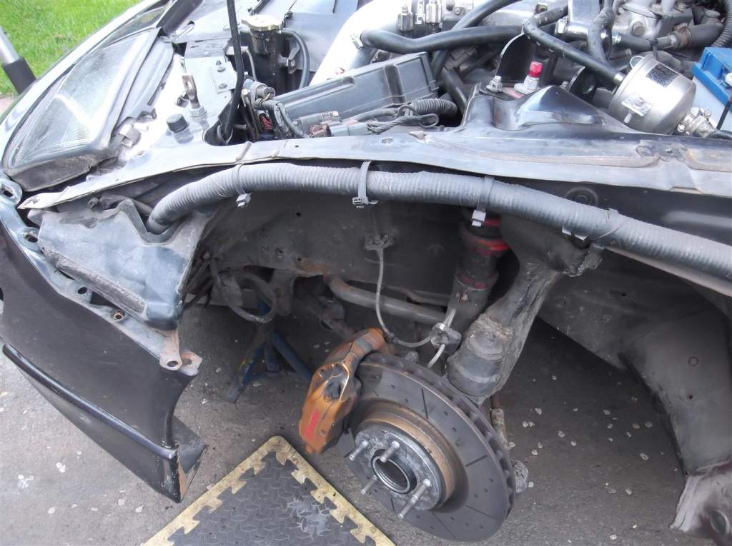

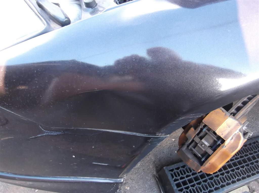

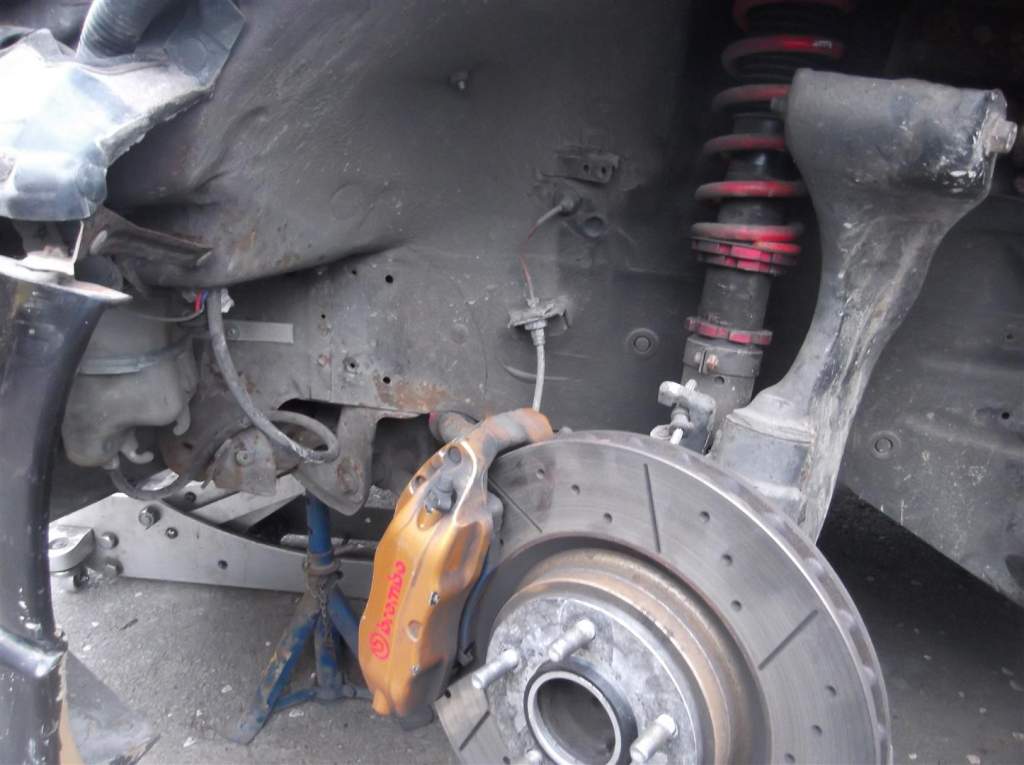

I spent some time today assessing the accident damage.
Pass door was catching on the wing which was pushed in.
Front of wing had a fair size dent in it.
The good news is there is no visible shell damage or suspension damage.

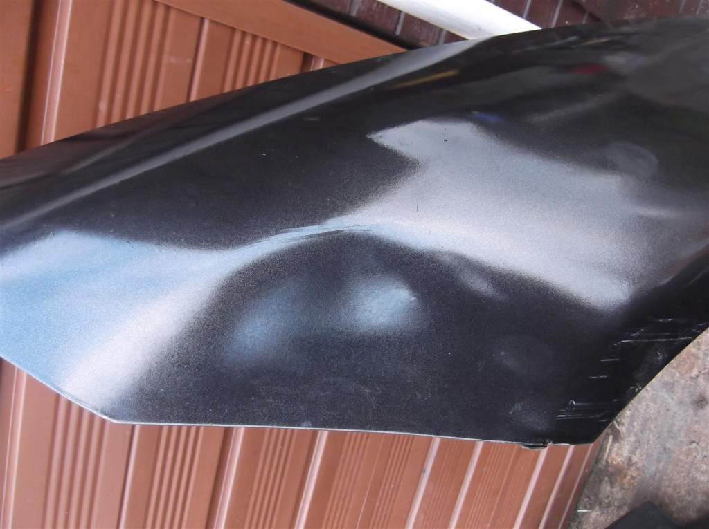

I have straightened the wing roughly back to shape and the door opens OK now.
There is a dent in the door which will push out, fill and paint when I paint the front.
I havnt time at the moment to skim the wing and paint it. Likewise the front bumper needs repainting.
That can wait for another day.
I will just bolt it all back together for now so I can get back out in the car.

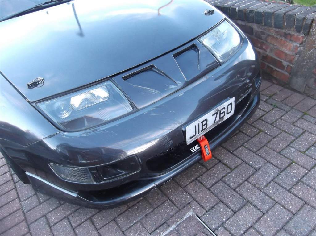

I have straightened the wing and trial fitted it.
Passenger door opens again without catching and it all looks OK from a distance.. :lol:

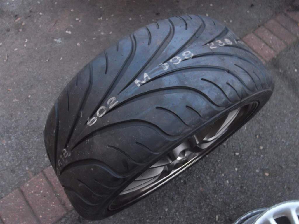

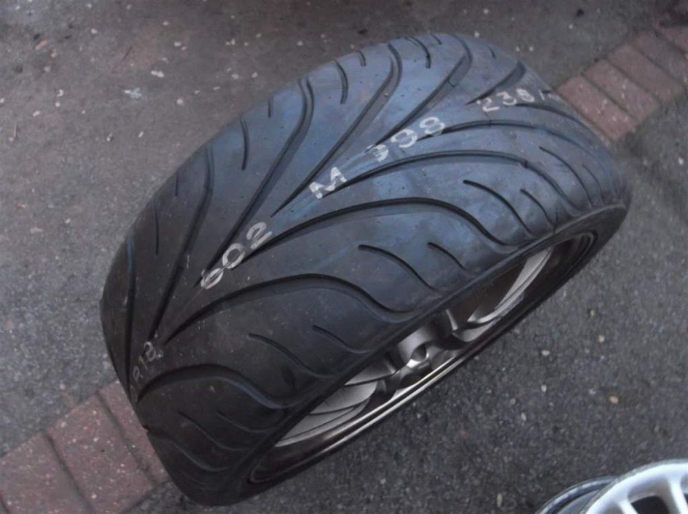

Since the wheels were off I took the opportunity to fit some new tyres.
All back together now.
Some scuffs have compounded out.
I have booked it in for a tracking check on Monday.
I will also be able to look underneath when its on the ramp for tracking for a final inspection.
