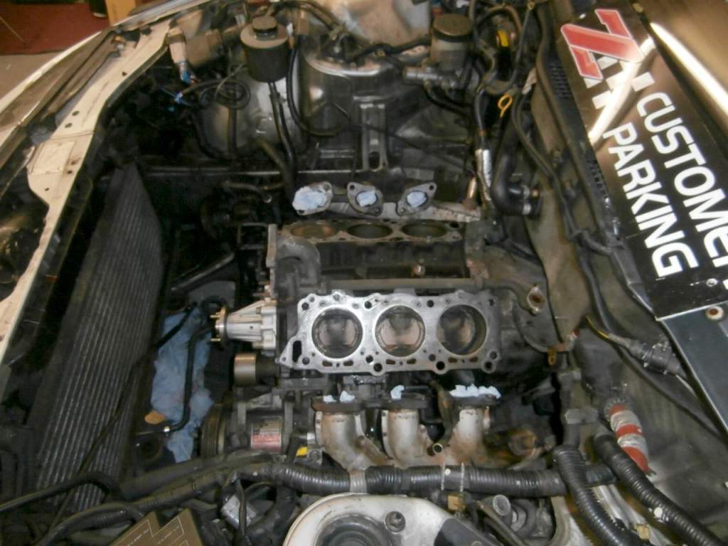

Just pull the engine. I believe an NA can be done in the bay but by the time you’ve got down to that point you may as well of pulled the engine and done a proper job.

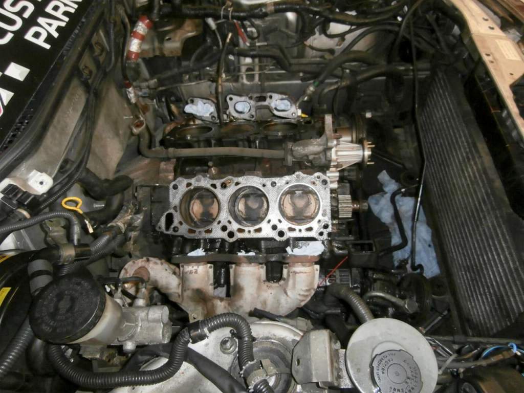

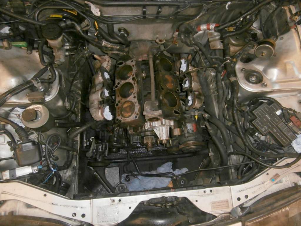

Can be done in the car, not too bad on a non turbo

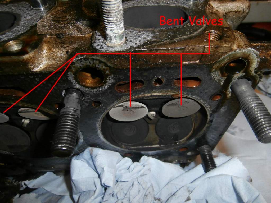

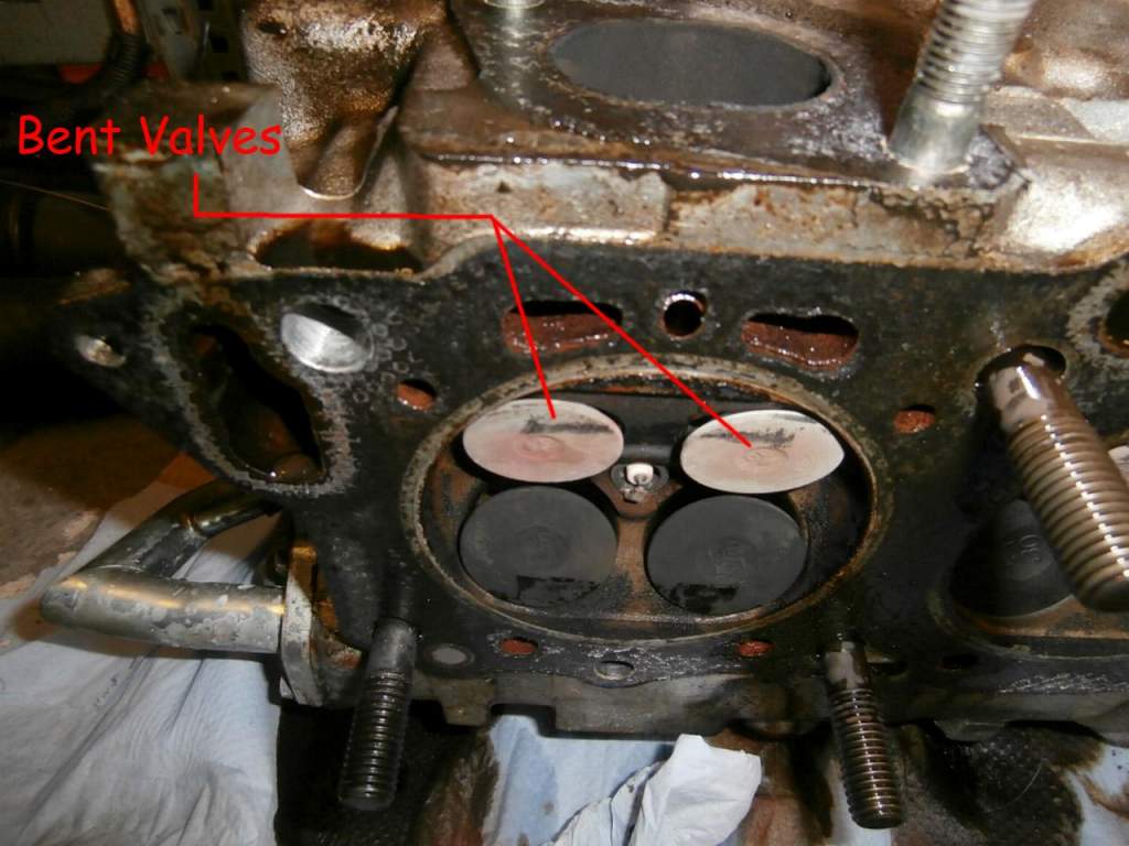

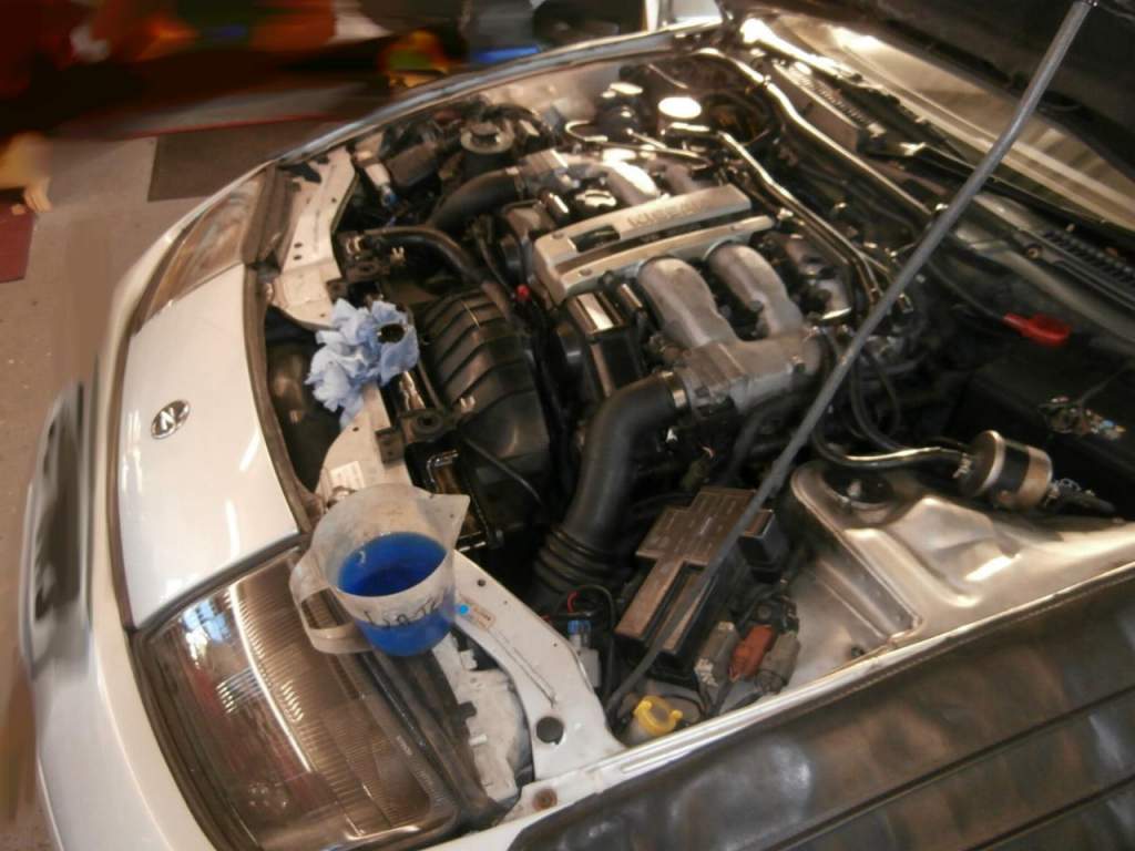

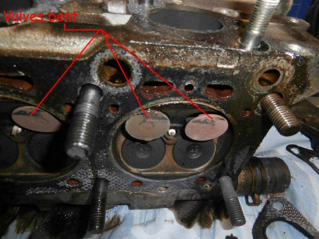

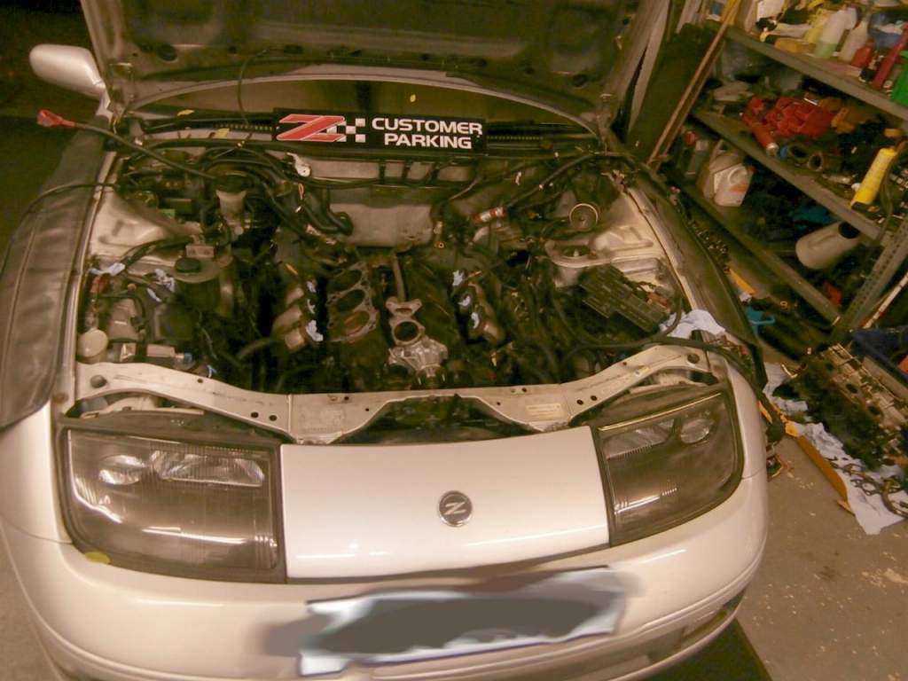

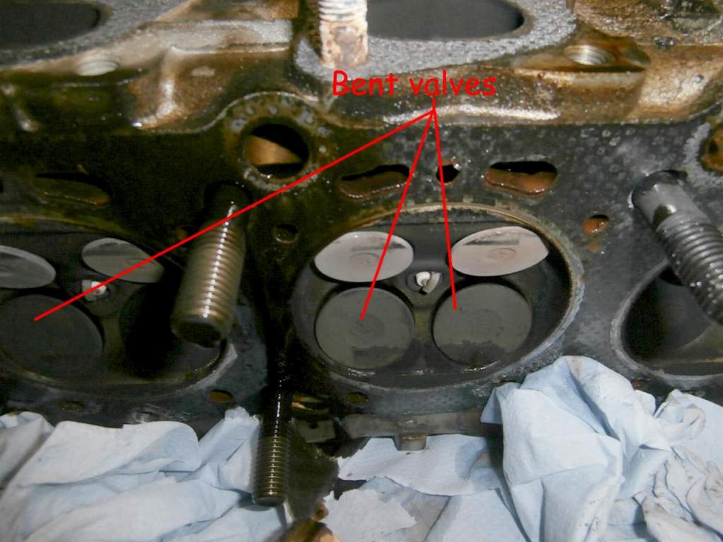

Here is a non turbo I did around four years ago, in this instance the cam had seized ripping the belt teeth off and crashing the valves and pistons.
I did have a couple of heads ready to fit so not too bad, a good days work for sure.
Jeff

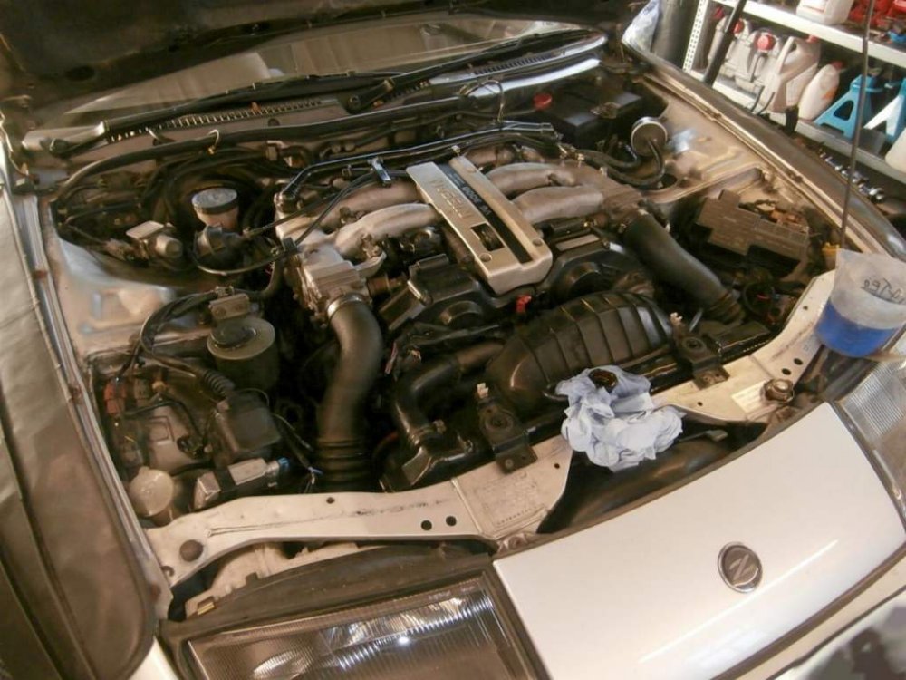

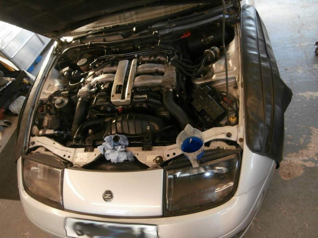

Ok that video is not convincing me at all, usually over pressure will shoot the water out like a geezer !! not saying your wrong and it maybe just a small issue that you have caught early. I assume your loosing water out of the expansion vessel ? that could be a bad radiator cap, I would be looking at a few more tests yet to be honest.
Jeff
Nice work, i have alot to learn about Automotive :) growing up loved cars had a 200sx in my youth, but then life got in the way :) now alot more relaxed moved out of London get to do more, sure is better then sitting at a desk writing code, although wife is not so fond of my hobbies :)
Sent from my Pixel 2 using Tapatalk
I bought a new caps also, with the cap on it leaks where the overflow pipes are, had these changed also

Sorry correction its coming out of the coolant bypass hose when system is under pressure (with rad cap on), when I take cap off there are no leaks
