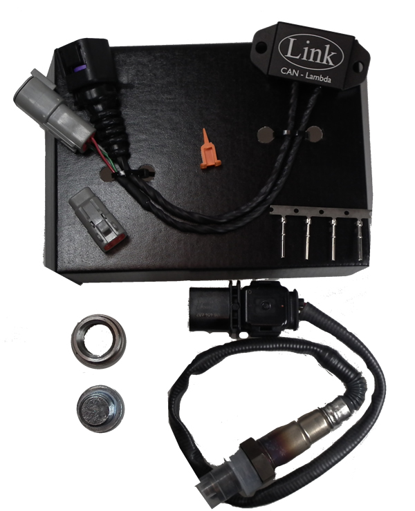

Options available that was recommended to me but i'm unsure about is to replace the standard
O2 sensors and install new wideband Sensors along with the wide band controller from link, these
are also about 290 plus vat each for the Kit.

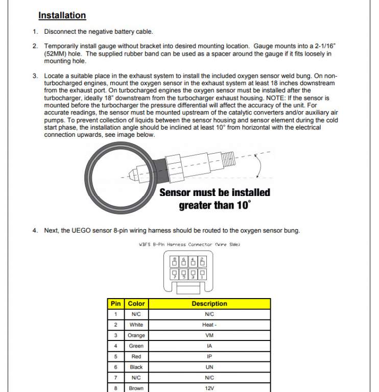

Strange I’ve had my ones here for the last 2 years and no issues yet, fitted many here also and no issues so far. I use AEM but I’ve heard stories of other brands failing early. Maybe this is the case??
The AEM install instructions for the wide bands I fitted for my Fail safe gauges, state a minimum distance of 18" downstream from the exhaust port & a minimum angle, greater than 10 degrees - see below
[ATTACH=CONFIG]114633[/ATTACH]
It actually states a minimum of 36” downstream on a turbocharged car for certain wideband sensors which makes putting them in the stock o2 sensor position a bit of a silly gamble really. I’d say you’ve been lucky Mike but I’d get them moved to avoid premature failure.
Edited by Joely P
Well that answers my queries then. I’ll leave my ones where they are until they fail lol
Why don't you just move them to the correct locations?
Why fix something that’s not broken?
It's called 'preventative maintenance'.
