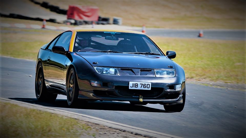

Here is the challenge. Can you beat a 235bhp NA driven by an OAP??
Come to Donington. Aug 22 late afternoon for the evening track session.
I can manage 10 laps at a time.
How often in that 10 laps can you overtake me?? Once? Twice??

You could come along and take your own track action pics.
Bring Andrew G with you ...he wants to sit in on a track session with me.
