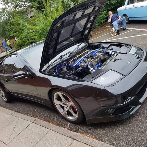

I thought i would start a thread to display the progress on my zed. Been a fair few years in the making with extensive list of work ive carried out and i thought it may be of use to others for ideas.

Winner of best SWB Zed 2019

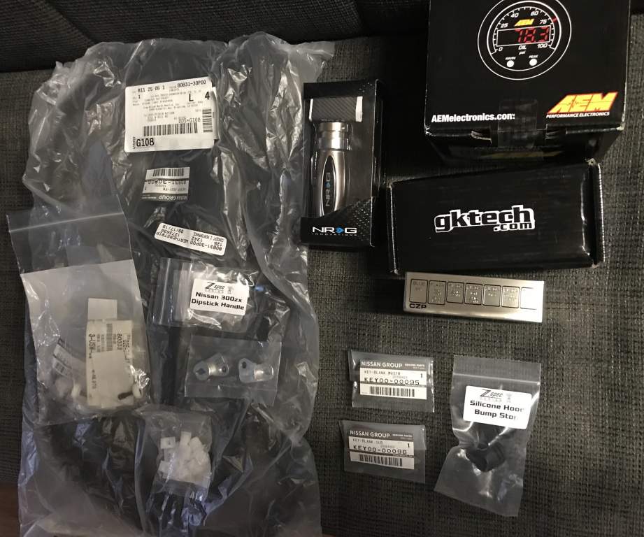

I've been busy accumulating more parts and another shipment coming in from CZP.
New door seals to fit along with a few other OEM upgrades to the door lock barrels.
Shiny parts to fit include stainless throttle cover and GKTech fan.
Dash will be out this winter as I have an excellent condition one to go in along with a centre gauge cluster with the 2 AEM AFRs and coolant gauge. Looking to pick up some new wheels so I can get some wide semi slick tyres on the rear before going in for another tune since I was losing traction before.

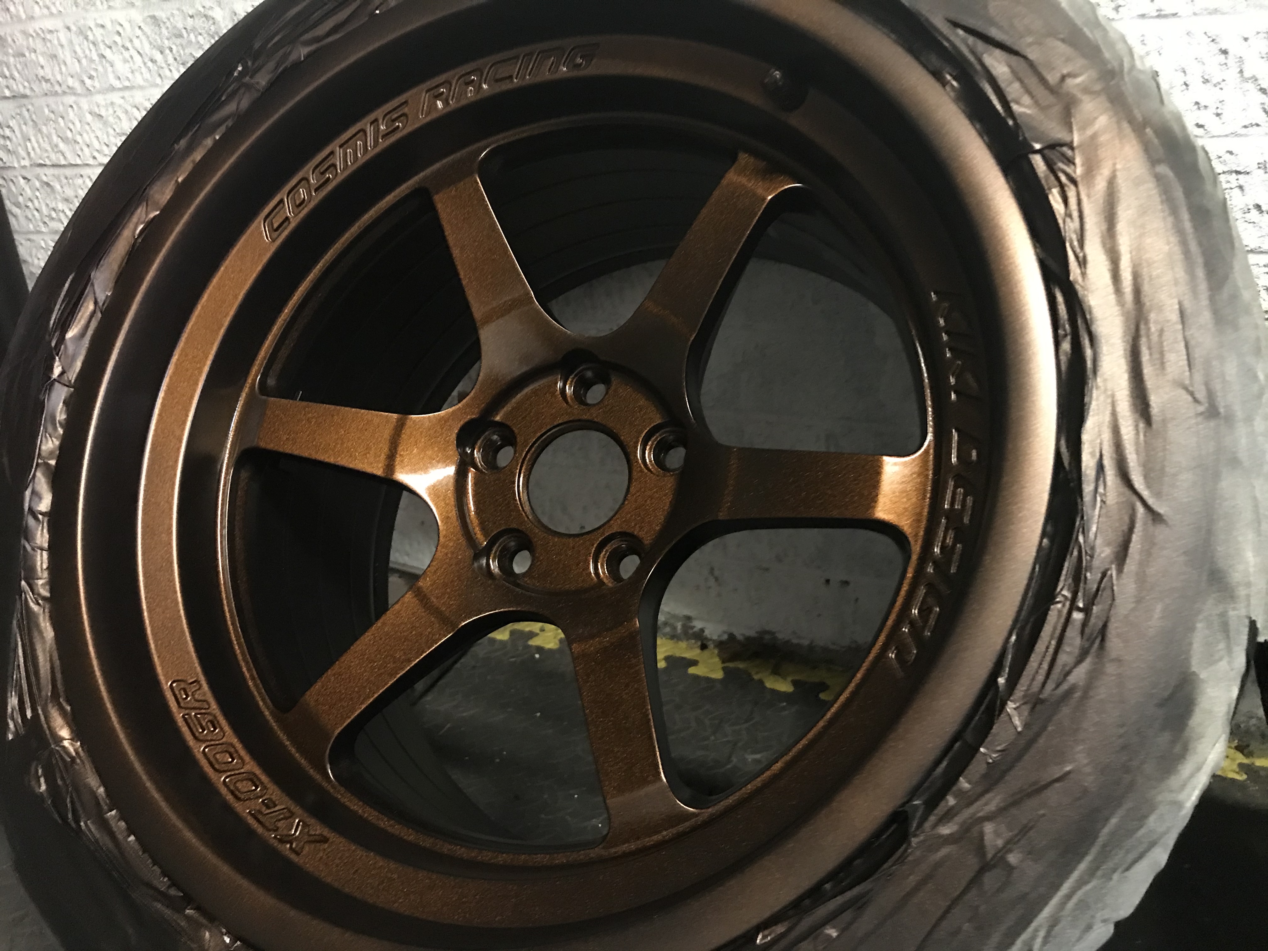

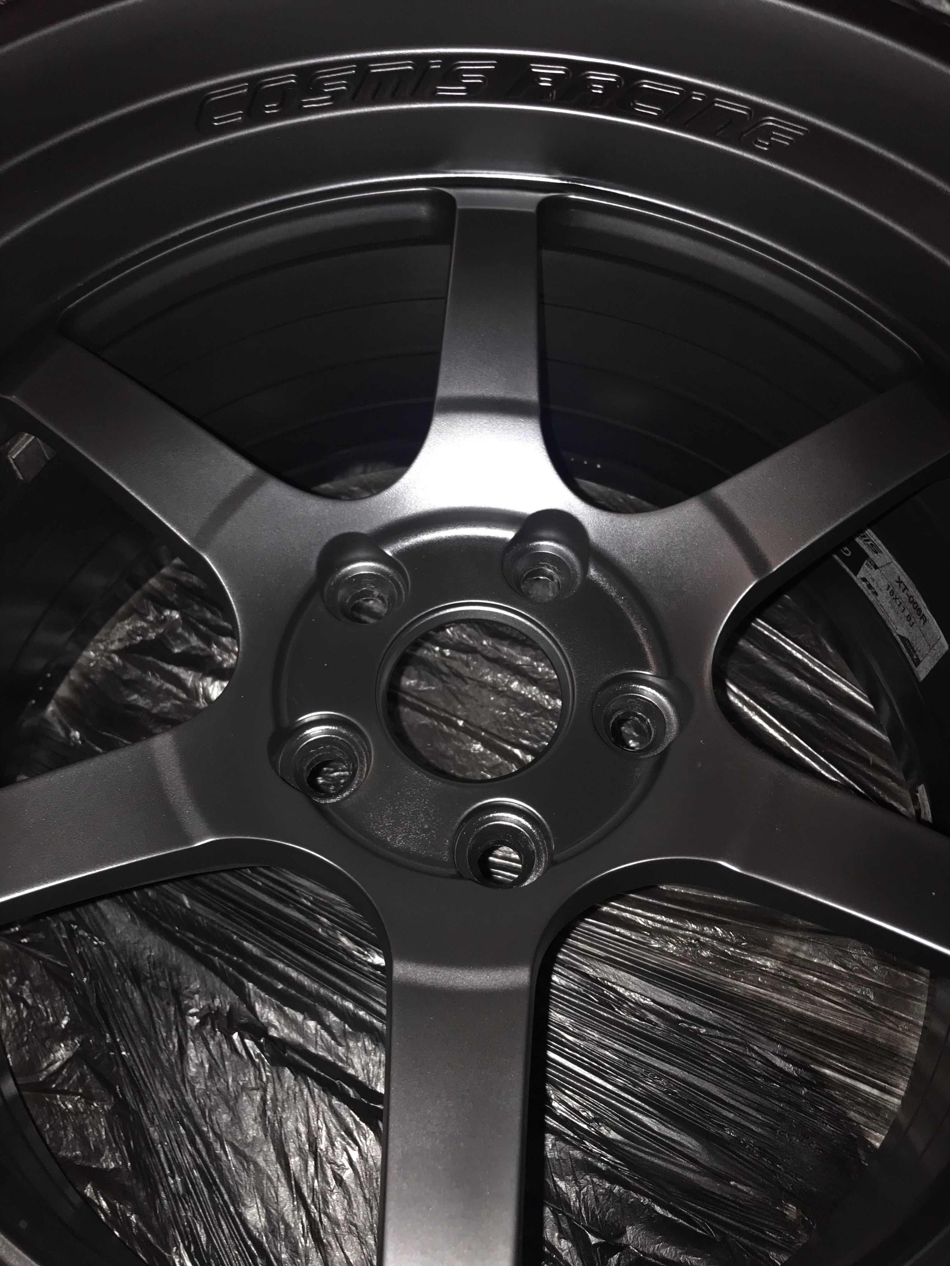

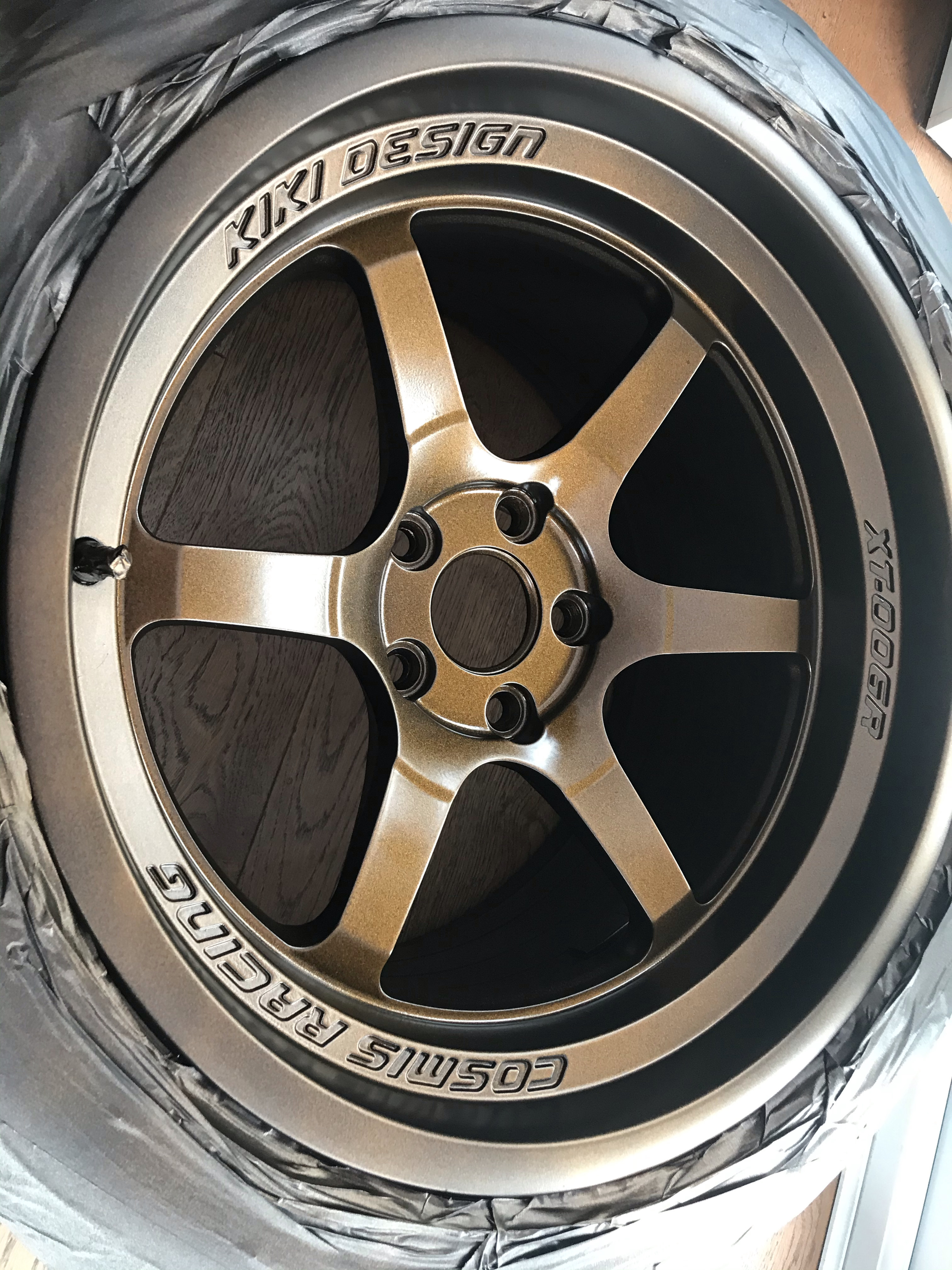

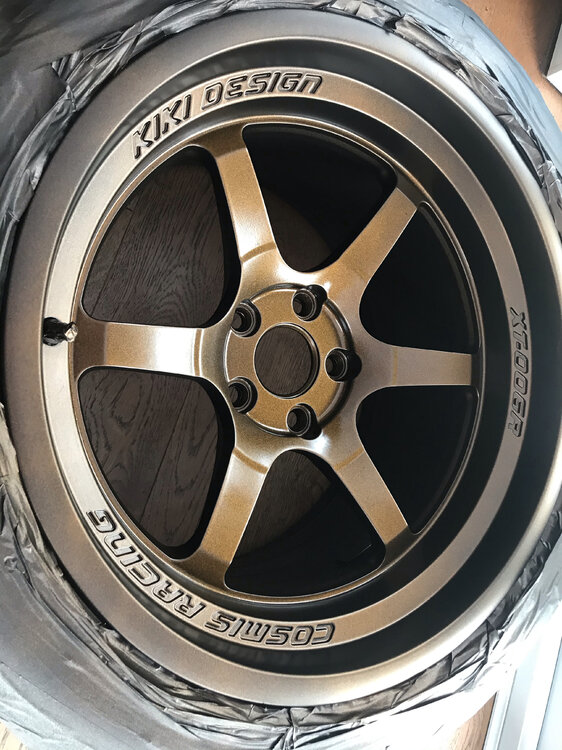

A little update as I’ve always got loads going on and plans for the Zed. Wheel colour this time. I’ve been watching some successes using liquid wrap which you can spray on and then peel off if not happy. Not a fan of vinyl wrap due to so many jobs looking incomplete and poor.
Liquid wrap is basically plasti dip made better in that you can get pro get sprayed with a gun that can be sanded and polished after you apply the topcoat or follow the trend of 10 years ago and stay matte.
Started experimenting with it and half way through my wheels now as my end colour scheme will finish with a shade of gold wheels. I’ve got 11J Cosmis on the rear that are practically brand new so easy enough to clean up for the job.
I’ve used 3 coats of black matte as the prime and then one coat of the stealth gold which being called stealth think pearl as it will give off a different depth of colour at different angles. I’m going to give a second light coat of gold on this before the top gloss coat. Being liquid wrap it isn’t prone to runs as much as paint is and is a lot more user friendly plus if you don’t like it you just peel it off [emoji1]
I plan on doing the whole car in the end with another colour and will leave it to the final pictures. The company I use also provide training courses which I will be booking on.

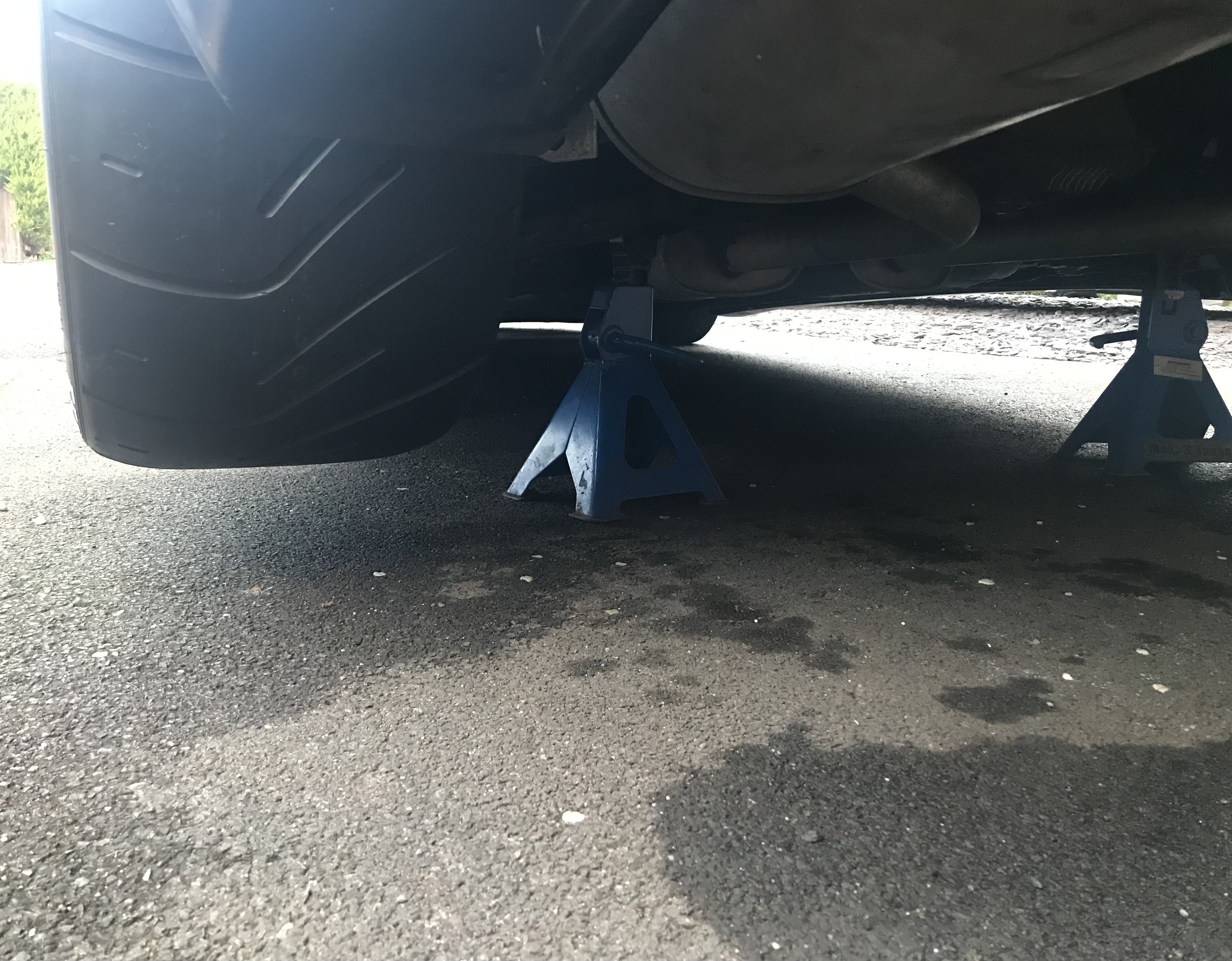

Some new shoes fitted on the rear today Federal FZ-201.
Got Racelogic traction control going on as well which are getting rare although another one has just popped up on eBay.
