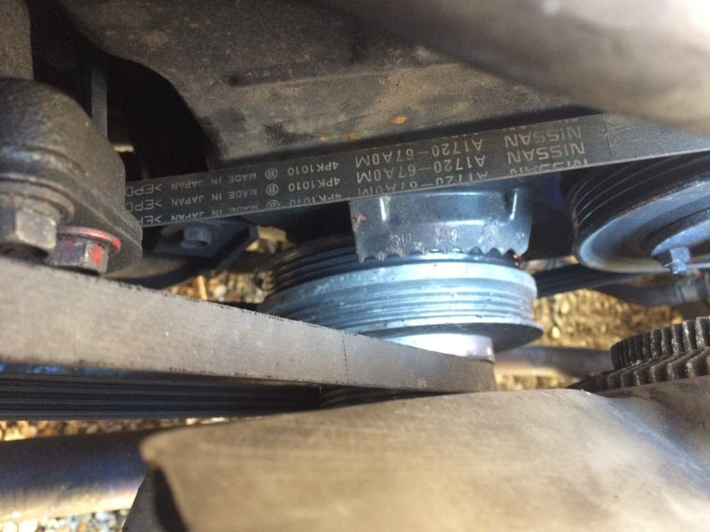

Had a quick inspection today. No jack atm so didn’t have a proper look but the Fan/Alternator belt is near on maximum adjustment and is this belt.
The Power Steering belt has no markings on it, so I assume it’s old... swear I changed it in my ownership... it’s visibly shinny on the contacting surface though which would suggest to me it’s been slipping. The other is matt.
Bit of independent research revealed;
The belt I can read is a 4PK1010
First number is the number of ribs, in this example 4.
Then the Type of belt, PK.
Then the final numbers are length in MM, 1010 in this case.
So effectively you can simply count the ribs, take the length and buy generic belt to suit. Brilliant.

Not a biggy, but the belt writing been the wrong way around makes me cringe, when the mech fitted it he clearly was not bothered about it, of course I get that it makes not difference operation wise but still it`s kind of there just looking wrong .....argh I will shut up !

I re fitted that belt when I was putting the engine in, in situe. Your right I didn’t care to even think if the text was the right way round. :lol:
