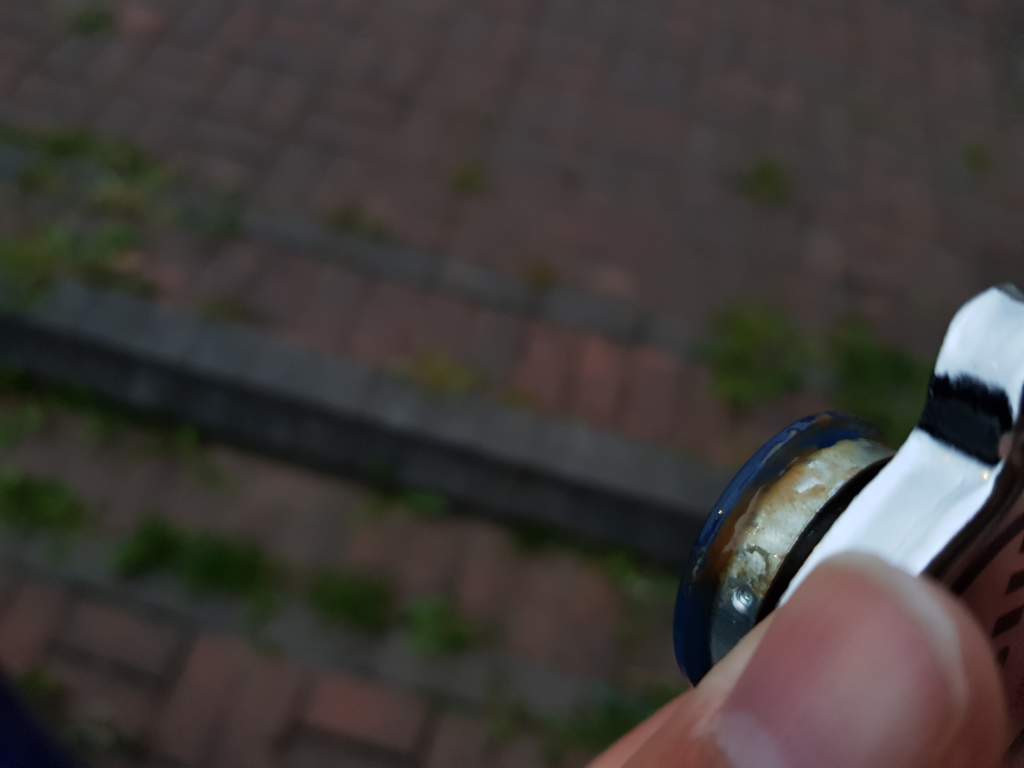

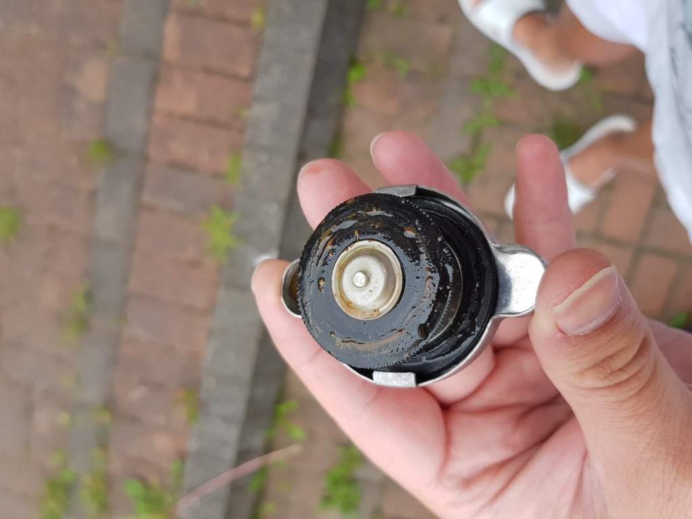

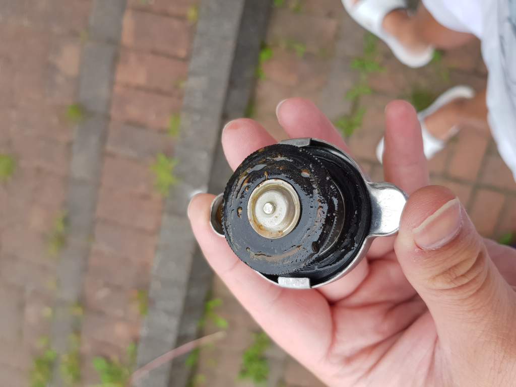

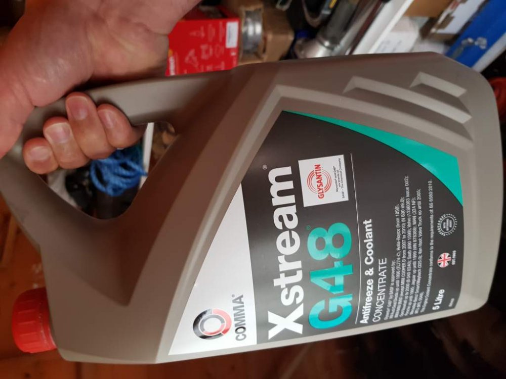

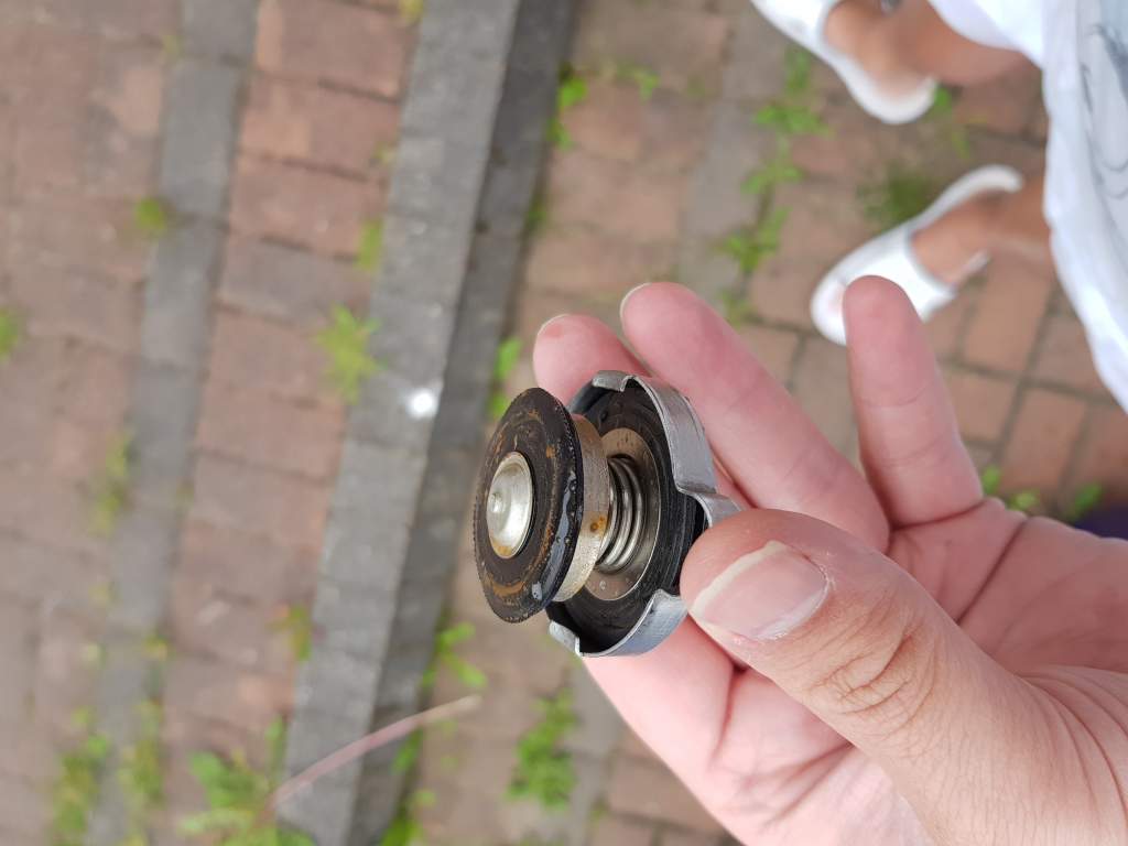

Anyone seen this before? I check my coolant levels all the time, but I've noticed that the black rubber seal/gasket has expanded.
Anyone have any idea why this would happen or what might have caused it.
So age/wrong coolant/Poor coolant mix or something else.
Been on google but can't really find anything. I've added pictures of the cap and the fluid that's been used in the car.

I'm sure it's bigger than it was, like sticks out more at the sides

Saw so many zx rad caps like that in the workshop, fit a new one soon as ... its toast.

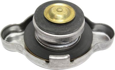

Should look like this Lee.
[ATTACH=CONFIG]112673[/ATTACH]
Radiator Cap Inspection: https://www.nissanhelp.com/diy/common/nissan_radiator_cap_inspection.php
Brilliant. Thanks Andrew. You are awesome and always have a link to everything :)

Rubber doesn’t last forever Lee, it absorbs water, rots, softens etc. It simply doesn’t last forever, age.
Thanks Jeff. I've ordered one, just wondering what causes it as I don't really want to put another one in if it's something like bad fluid that can cause it if that makes sense
Generally age related combined with high temps and maybe too high a concentration of antifreeze.

Thanks mate. I've ordered a new cap but I'll get a tester to check the antifreeze mix

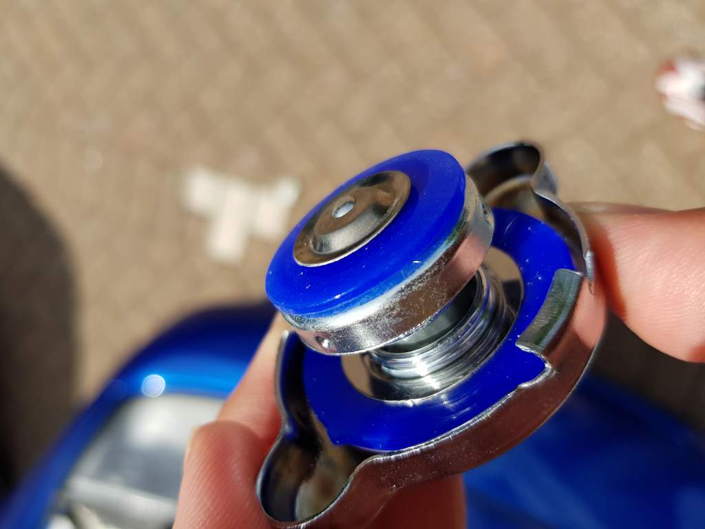

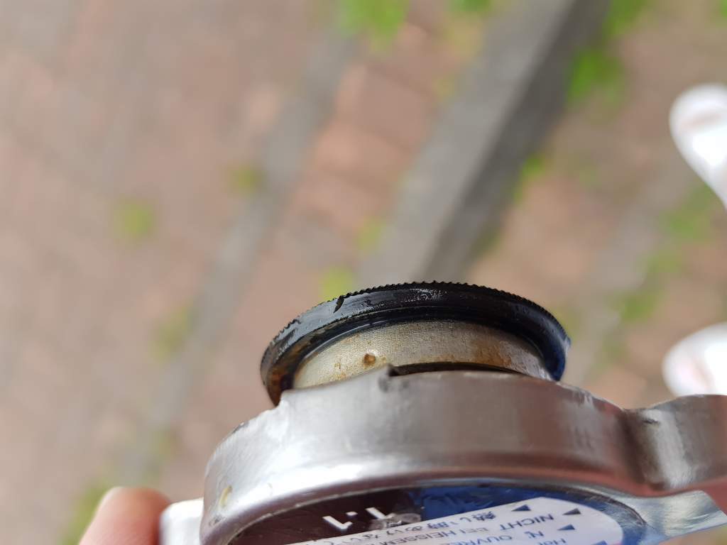

Bit of an update...
So I got a new cap and the same appears to be starting after just a couple of weeks. The cap I bought was a new one off eBay, but not the best quality. The photos are 1 from before and 1 from just now. I just also check the mix, it's got too little coolant, but would that make this happen?
