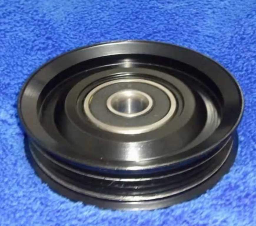

Does anyone have a spare Air Conditioning idler pulley they don't want? Mine has become noisy so looking to get a replacement that I have a new bearing for.
There are a few folk I know who have deleted theirs, so if you have an idler pulley that's totally round and not egg shaped, I'd really like it.
Don't care on the condition of the bearing.

[ATTACH=CONFIG]112361[/ATTACH]
hi si i have seen a link and convo on another page about this sort of thing before, and the person that had posted the link had just replaced the bearing as you say it is £3. but i cant mind where i had seen the thread may have been on a facebook page.

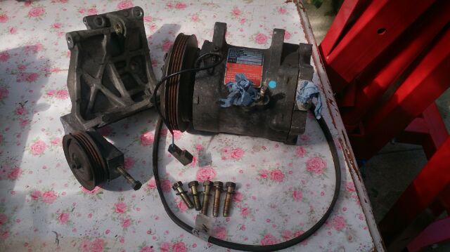

will have a look later I got everything I took of mine which was all working will post a pic.

was one of those times when I was removing everything! lol yeah was all running fine and in good condition will post a pic later think its pump/idler and bracket/belt/support with bolts ect.
