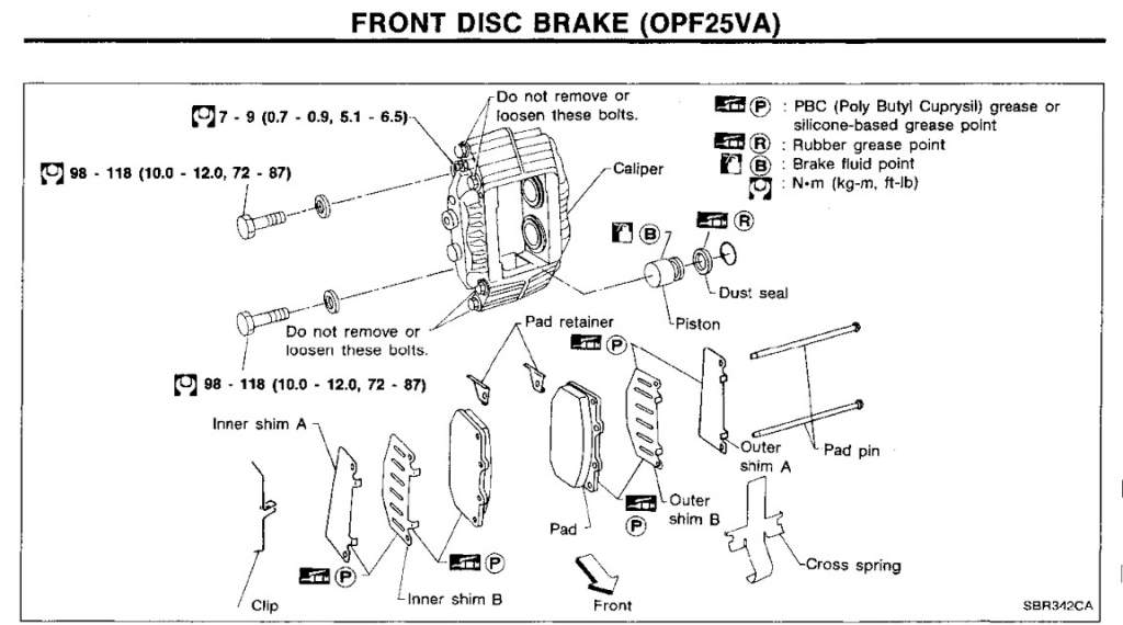

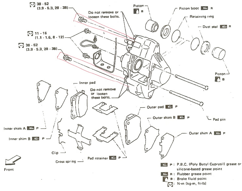

Hi AndrewG, I checked all shims present, all lubed up with Ceratec brake lube on pins and contact points....
Hi Stephen, checked handbrake and all okay, adjusted a while ago....
Thanks for all the help..... this is proving to be a guess, check and rule out mission......
And the pad retainers?
"Clip on one shim retaining clip to the pad, with the hole side going on the pad side & the long part running across the top edge of the pad (the smaller side) as a shim between the pad and the caliper top or bottom. This stops the forward/backward clunks noises from the brakes."
http://www.ttzd.com/tech/brakestech.html
