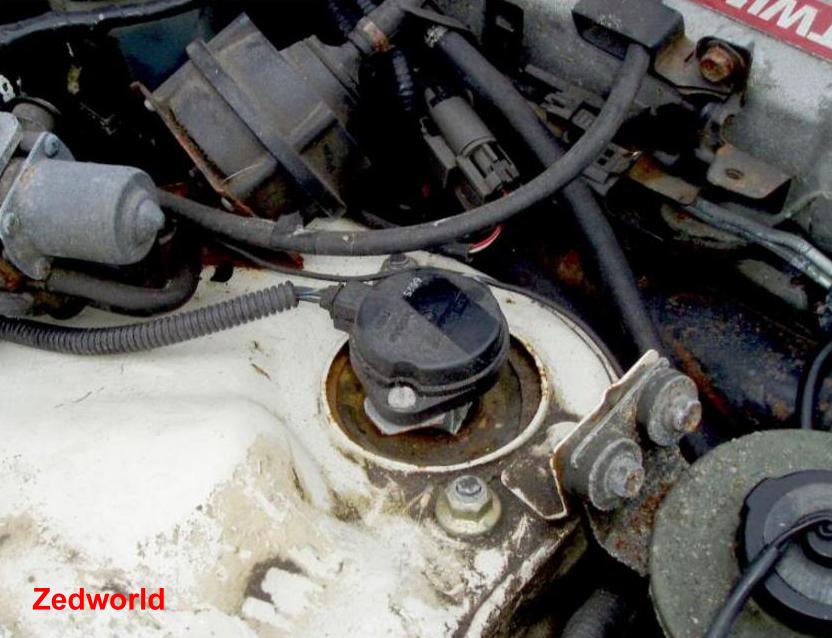

Yes there are little actuator motors sitting on top of the rear shocks and as typical zed has its own little ecu module behind the seats.

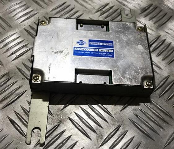

Yes, its sits along side the interior light relay.
Its behind the rear side panel passenger side, remove the rear seat squab and the side panel can be undone and removed, its a slim silver box similar to the one on the picture below.

The UK/Euro part# for the suspension controller is 25962-37P00 and the US version is 25962-33P00. They both look like
the image below. The difference between them is the UK/Euro is single channel for rear shocks whilst the US part is dual
channel for front and rear shocks.

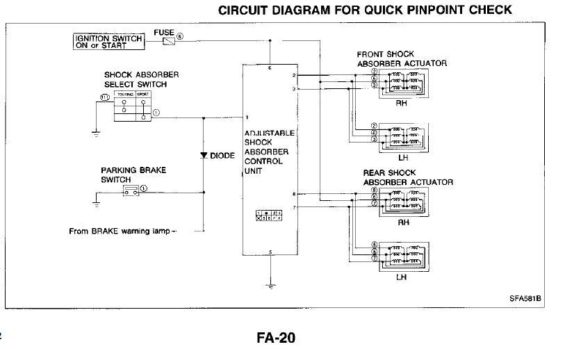

Both are actuated between hard and soft settings by grounding pin 1 on the controller. This is the US circuit diagram:
Note: that you will need to include the diode shown to the UK circuit for the handbrake switch.
The full US wiring diagram is here:
fa-21.pdf

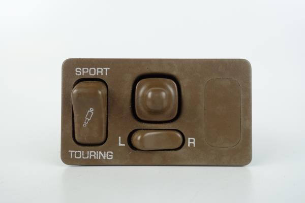

In the US the "touring/sport" switch was incorporated into the switch module near the gear stick:
this what they look like on my UK spec TT , i discovered these last night when i was taking the rear interior out to give my z a thorough clean out . I dont have them on the front shocks just the rear and i don't have the sport switch
<a href=31944880_10160275727860305_1373007491553
For UK/Euro specs that's as it should be.
