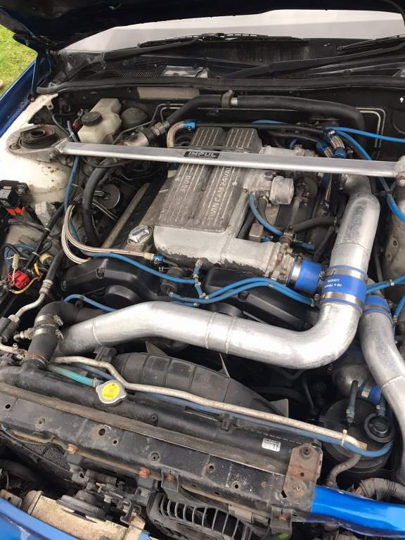

Id be interested to see the v6 single turbo manifold design. How big a turbo can you squeeze in the bay?
The manifold has 2 throttle bodies exiting to the side. The original bov was cut off & the intercooler piped in to that position. I plan on changing that up for a neater design.
This is mine when I 1st bought the car. I have tidied it up a lot since then.
There is a bit of room between the turbo & the chassis so I'd like to have a topmount set up eventually with upgraded injectors, wide band afm & link ecu.
Yeah I meant the exhaust manifold, but still looks like theres not alot of room in there, not for anything substantial anyway.
I take it you can do pretty much the same deletes and tidying in there.

It's an odd set up. The turbo is on the passenger side manifold that leads to an elbow,then a downpipe. On this pipe is a T piece. On the drivers side is a manifold with a downpipe that runs round the back of the engine & over the gearbox bellhousing to the T piece on the passenger side.

Yeah id love to see the manifold. Could be a future mod to the vg30dett if its manageable.

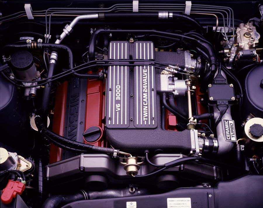

Have I gone mad, I can't see any ignition stuff :blink:
edit
It must just be under those trim strips :)
