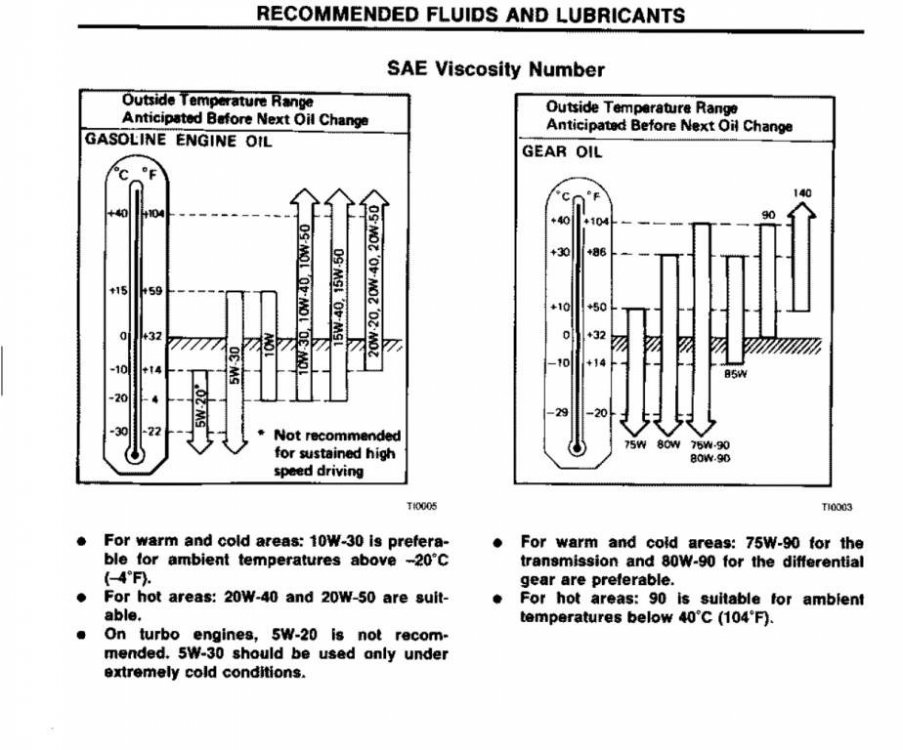

As for oil Nissan prescribes a 10w-40, most oils in that category are semi synthetic. If you wanna run full synt you could run a 5w-40.
No problems regardless, almost any oil sold today will exceed the quality requirements for our engine.

Further more, the workshop manual states that use of a 20W50 is acceptable for higher temps, so I struggle to see why a heavily modified VG30 isn’t suited to a 20W60 Esther synthetic oil

True - but the "higher temps" referred to are ambient temperatures, not engine temperatures. Running a VG30deTT in a consistently hot climate is a lot different to running it in the UK, where we rarely see 30 degrees plus.
This is true, and without wanting to go back and forth, the OE oil viscosity ratings are designed around a VG30DETT in completely stock form and stock boost. Secondly, yes why it relates to ambient air temp, the inference is that in hotter environments engines will run at a higher temperature and to have an oil that doesn’t run too thin in those temps. Visa versa with cold climates.
Given the extra heat that is involved in running 1.6bar of boost that my particular engine is running I wanted an oil that was as thermally stable as possible at higher engine oil temperatures. Both on track and during VMAX I saw oil temps of around 115c, Granted I now have a larger oil cooler, but thermally stable oil at that temps was something that encouraged me to my particular oil choice.
